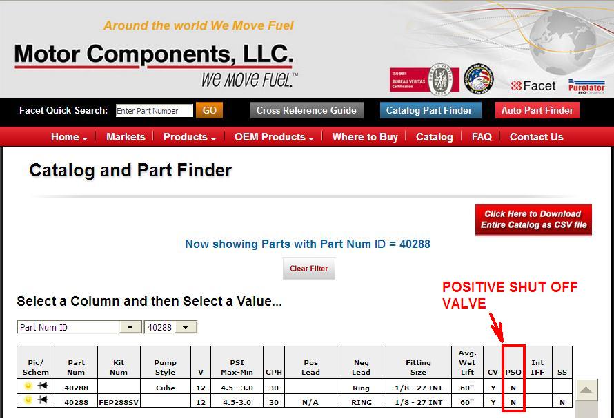

And no, a properly selected electric fuel pump will not stop the fuel flow if the pump fails or you lose 12V.

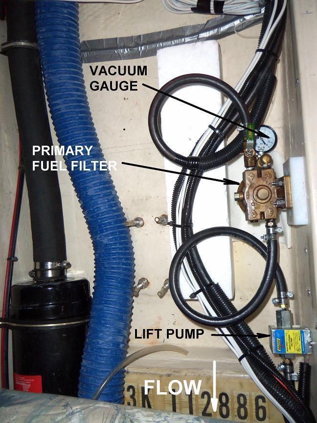

If the fuel tank is way below the level of the engine, the engine may slow down a bit if the pump fails. I can't see any change in RPM between the pump being ON or OFF. And that's at 1/4 tank. The electric pump really makes for easy bleeding after a filter change.

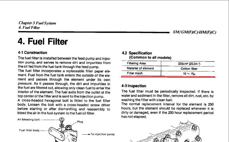

Not exactly kosher for fuel filtering before entering the high pressure pump.
The Racor filter (primary filter) has a coarse filter for removing the coarse particles while the small filter on the engine (secondary filter ) has a 10-15 micron filter to ensure that very little in the way of abrasive grit gets into the high pressure pump.

As you have said, the large(r) primary filters are usually easy to prime so I also chose to use that filter to protect the electric pump. What makes the filter easy to work on is that I removed it from a nest of water hoses, fuel hoses, and electrical conduits and moved it to a much more convenient location. There is no room under the filter body now (about 1/2") to remove the element but the filter body is easily removed from the hanger and, via the coiled hoses, you can remove and work on the filter with all hoses still attached.
I use a 10 micron filter in the Racor. This filter is massive for this little engine. It never gets even close to plugged. I also have a vacuum gauge on it for monitoring purposes.
If that 10 micron filter were to ever plug up with "coarse particles" then that means I've got some kind of serious problem with my tank, which would warrant a serious cleaning out rather than adding coarser filters into the system.
