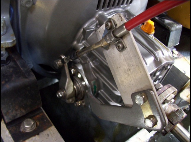

Looking to replicate this transmission cable bracket.

I'm looking to replicate this for my Yanmar 2GM, there isn't a part listed in the parts catalogue for this piece. I'm not sure who's boat this is, any help would be appreciated!

The aluminum part looks suspiciously home made. It shouldn’t be too difficult to duplicate, just a piece of aluminum strap, drilled and tapped.
Tom G
Jan 4, 2006
7,820
When you close in on the photo, I'd be inclined to say the bracket is SS by the nicely rounded edges and heavy indent on the top along with the identical surface of the SS machine screws.
Oddly enough, it's the striated surface of the of the piece of flat bar between the shifter cable and support arm :
................ that are very likely aluminum.
I'd check with McMaster Carr or Amazon for a SS bracket as you don't know what the loading on the bracket will be when in service and it'll look better than an aluminum homemade job.

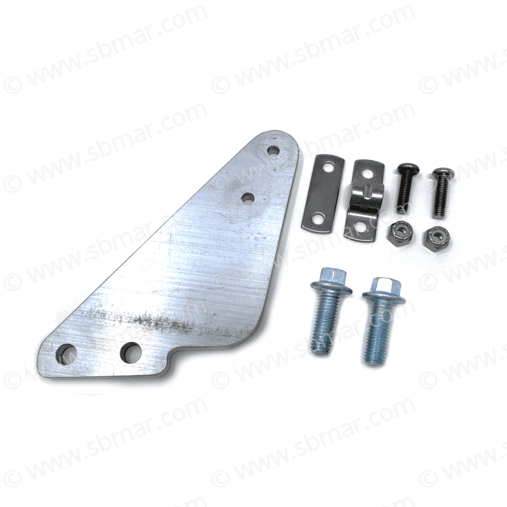

Here is a random site that appeared on an internet search to show an idea.

Essential yes, the the unpainted aluminum piece is easy to make, home made, and just a square piece with some holes, the clamp on the cable is the same one that is on the engine now. I'm interested in the painted part attached to the transmission. . It does not look home made to me, it looks like it might a Yanmar part. My conclusion is to just make one from scratch, I haven't been able to figure out where this piece came from. Thanks for your help.

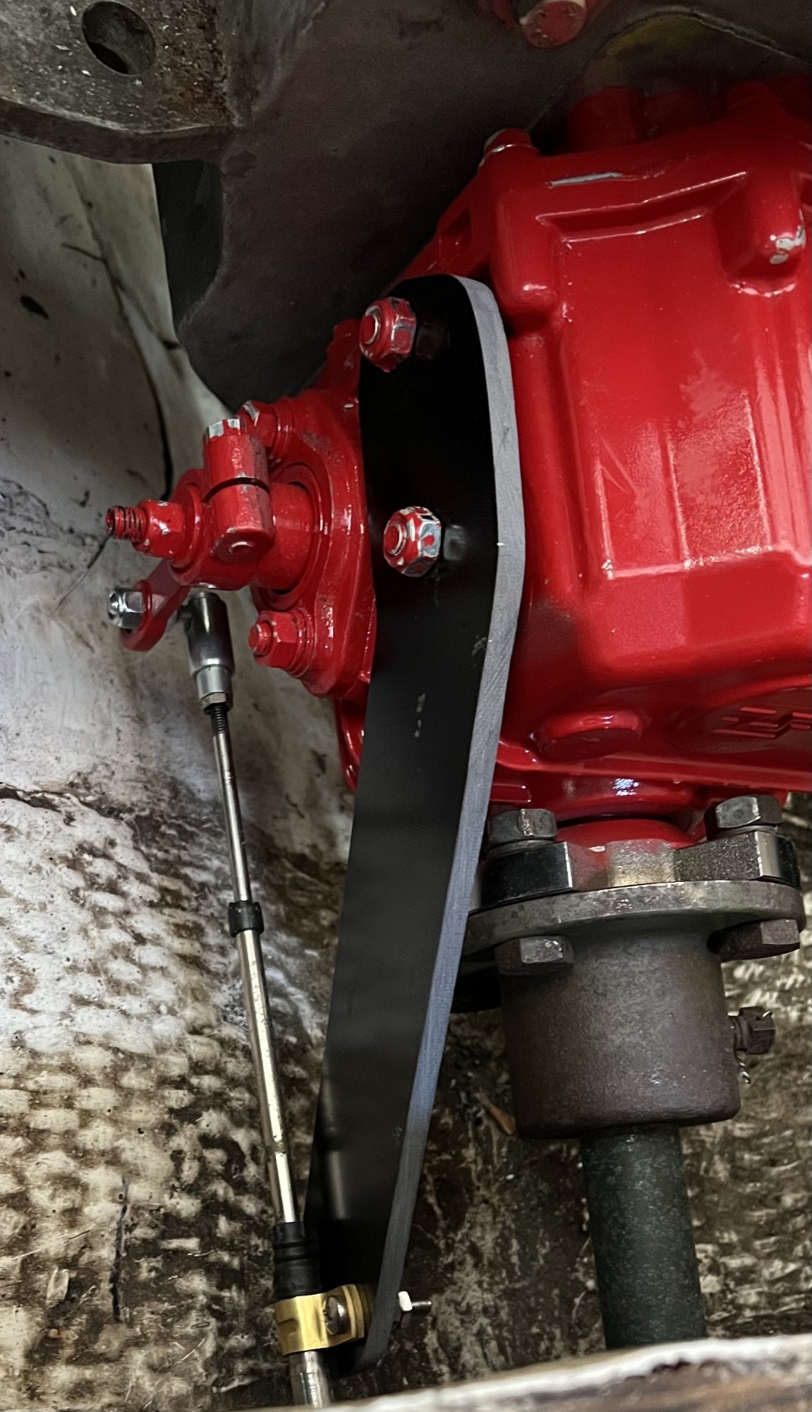

I needed to make a bracket when I changed my tranny and the shift arm was on the opposite of the orginal tranny.
While I had a diagram for the bracket, it wasn't exact so I did basically what Gary outlined.
I had a piece of 1/4" G10 board laying around, I also used it to make engine mount spacers, and used that instead of buying a piece of aluminum.
I made the cardboard pattern and used it to mark the G10 board. I rough cut it with a 4" circular saw and final shaped it with a belt sander.
Drilled the holes and mounted it. Easy peasy.
(I did all the cutting, sanding and drilling outside in the marina yard while wearing proper PPE)
Question for the group.
Is G10 appropriate for this application? Now I have a good design should I duplicate the G10 bracket in aluminum?
14,219
There should be very little stress on that part, so I see no issue using G10. If you disconnect the cable, you'll see how easy it is to shift gears.
Looks good to me.
Rustproof and doesn't need painting.
I would add flat washers and keep and eye on the mounting holes for fatigue cracks.
Although I don't really see that as a problem.
Well done and a perfect example for the OP.
