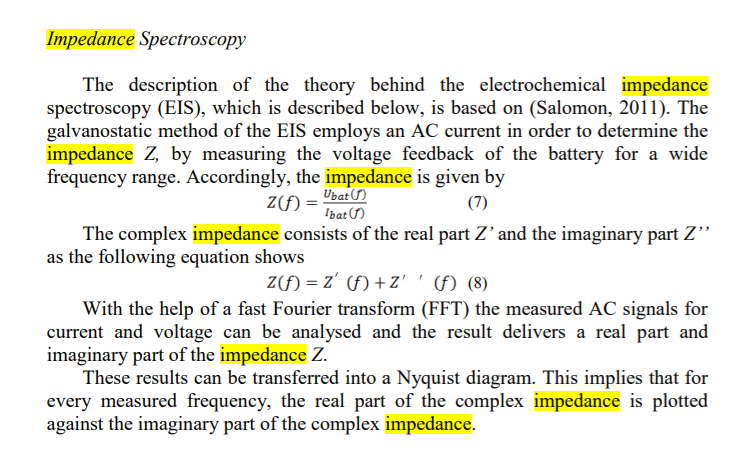

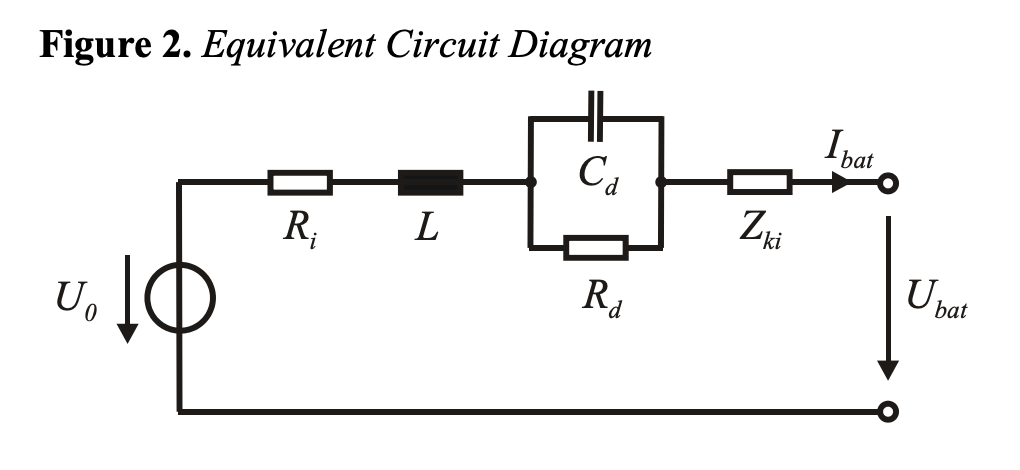

More nonsense. LA batteries have a rather complicated impedance that changes as the SOC changes. See this paper:
Generalized Lead-Acid based Battery Model used for a Battery Management System
Here's the equivalent circuit diagram for a lead acid battery the author developed:
I give up, @Hayden Watson , the above is just gobbledygook.
I fully read this scientific paper and found it to be very informative but your interpretation to be hilarious. After reading it, I did a word search for the word "impedance" and found it used 20 times. I also searched for "resistance" and found it 22 times. The most interesting section on impedance is is copied below. The impedance that they are talking about is the result of a small AC current that they added to the batteries in order to allow them to do an electrochemical impedance spectroscopy (EIS) which gave them a method to much more accurately calculate the internal resistance of the battery. In layman's terms, they added an AC current so that they could produce impendence so that they could calculate resistance.

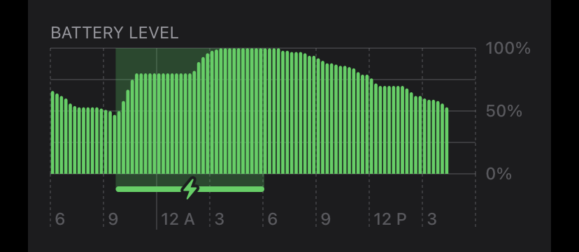

Thinking by way of analogy to consumer electronics, this has been the trend for lithium ion chargers. Some phones and computers now have a charging option where they’ll bring the battery to 80% immediately, then float it there until the user says they want the full capacity, or an algorithm determines it’ll be needed. In the case of my iPhone it means there’s a few hours each night where the battery isn’t being taxed floating at 100%.
My new Macbook does that. It has a smart charging algorithm, and learns my habits, keeping the batt at 80% unless it anticipates unplugged use, where it charges to 100%.

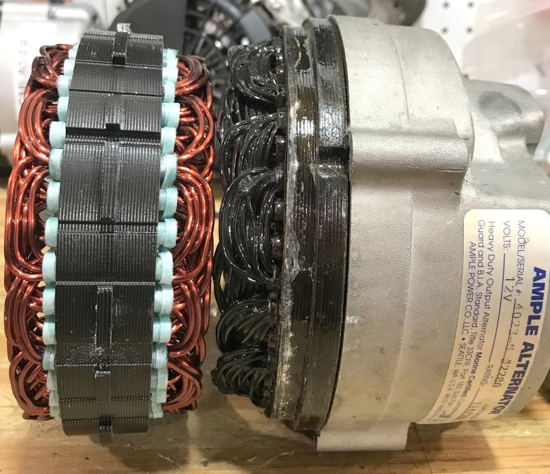

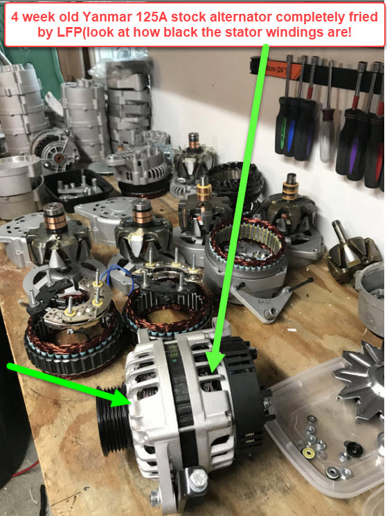

Most stock alternators do not have the capability to charge an LFP battery without eventually sustaining damage.An external regulator can help prevent this provided you start with a well built alternator to begin with and you then program the regulator correctly....
and the Ample alts are not immune to this either, despite their claims of "continuous duty".......

Yikes! I have an Ample Alternator rated 125A. I have run it continuously (mistakenly) with a 100A limit charging FLA banks, but of course that's not really continuous since the stupid smart regulator doesn't maintain constant current during bulk, for some reason - it tapers off as you approach the acceptance voltage set point.
In fairness, it is strongly dependent on the airflow and ambient operating temperature. Ample published a chart in their manual [1] de-rating these depending on RPM and ambient operating temperature.
The best thing is to have a regulator like the Balmar ARS-5 that has an alternator temperature sense port and will back off the output as things heat up.
