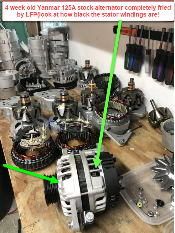

The problem isn't that the battery CAUSES the alternator to put out more than 125A because it does not. The problem is that the LFP's will take that 125a from empty to full and that long time at max output causes the alternator to overheat. What is needed is a way to slow down the alternator's output when its temperature gets too high.
Hayden, I believe you are incorrect. The alternator/regulator combination will certainly put out more current than the alternator is rated for if presented with a low enough impedance. There is no current limiting on an alternator, the alternator doesn't "know" it's a 125A alternator. If it's rated a 125A alternator that means that in nominal ambient temp conditions and with a specified airflow it will be capable of sustaining 125A output without melting. You can wreck an alternator quickly with sufficiently low impedance loads, and you can do it with Lead-acid, you don't need LFP to do this. Put a discharged 400Ah FLA bank in front of a 60A alternator and see how long it lasts.
The way an alternator output is slowed down by temp is by having a typically externally regulated system that has a temp sensor on the alternator and the batteries, and that will reduce the output, via the field current, if the alternator or battery temps get to the set threshold. These are not uncommon.

Actually, it is North American nomenclatural laziness that even calls it a 125A alternator because what they put out is Watts not amps just like any other charge source. We get it right with solar and wind generators but drop the ball on alternators and shore power chargers.
It will probably put out 1500W (125A x 12v = 1500W). As the voltage goes lower, the amps go higher so a very discharged battery will take more than 125A but the alternator can still put out a number of watts at a given rpm's with full field current. The problem is that most of them are not rated to put out rated watts at 100% duty cycle in a hot engine space. In most FLA setups, the internal resistance of the battery comes up quickly to throttle down the alternator and it doesn't run hard enough for long enough to get into that overheated situation. LFP banks are often much larger and have much lower IR so the alternator runs at max for too long and looses the battle with heat.
The best setup is one that monitors the alternator's stator temperature and reduces or cuts off the field current if a set temperature is exceeded.
