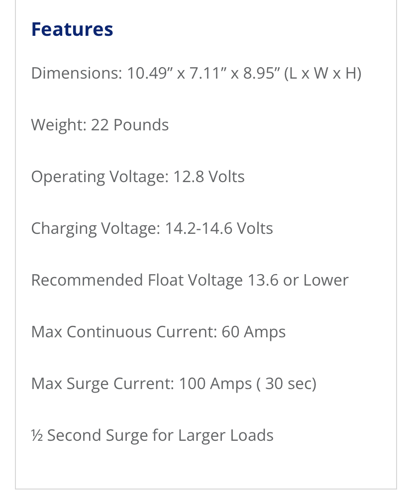

You may have trouble getting the discharge current you need for starting from a Lithium bank that size. LiFePO4 is not especially well suited for high discharge current. For example even to 400AH bank suggested earlier says in the spec sheet it has a maximum output current of 300A for 3 seconds (200A continuous). Using that same ratio a 40 aH LFP bank will not come close to what you need for starting.
I highly doubt that is the case! I'm going to do some research, but it strains credulity that a 40Ah LFP bank won't start a garden tractor diesel! I have a hand-held LiOn pack that will start my diesel!

I highly date that is the case! I'm going to do some research, but it strains credulity that a 40Ah LFP bank won't start a garden tractor diesel! I have a hand-held LiOn pack that will start my diesel!
As another data point, a BattleBorn 50 aH battery has these specs:
My 3YM30 starter is rated as 90 Amps no-load, and 250 amps loaded maximum current.
It’s not an LFP limitation, it’s the BMS. Here’s a 60ah start battery:

Yes, thinking this over, you guys are right. The BMS will shut it down.
