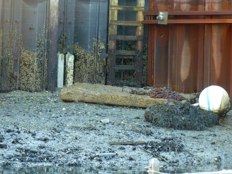

This is what a typical dead-weight Maine granite mooring looks like, low and flat. Within a year it will often be flush with a mud substrate or below it.
