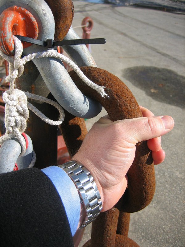

This is the bottom chain for our "non-storm" mooring in Falmouth for a 36' boat.....
