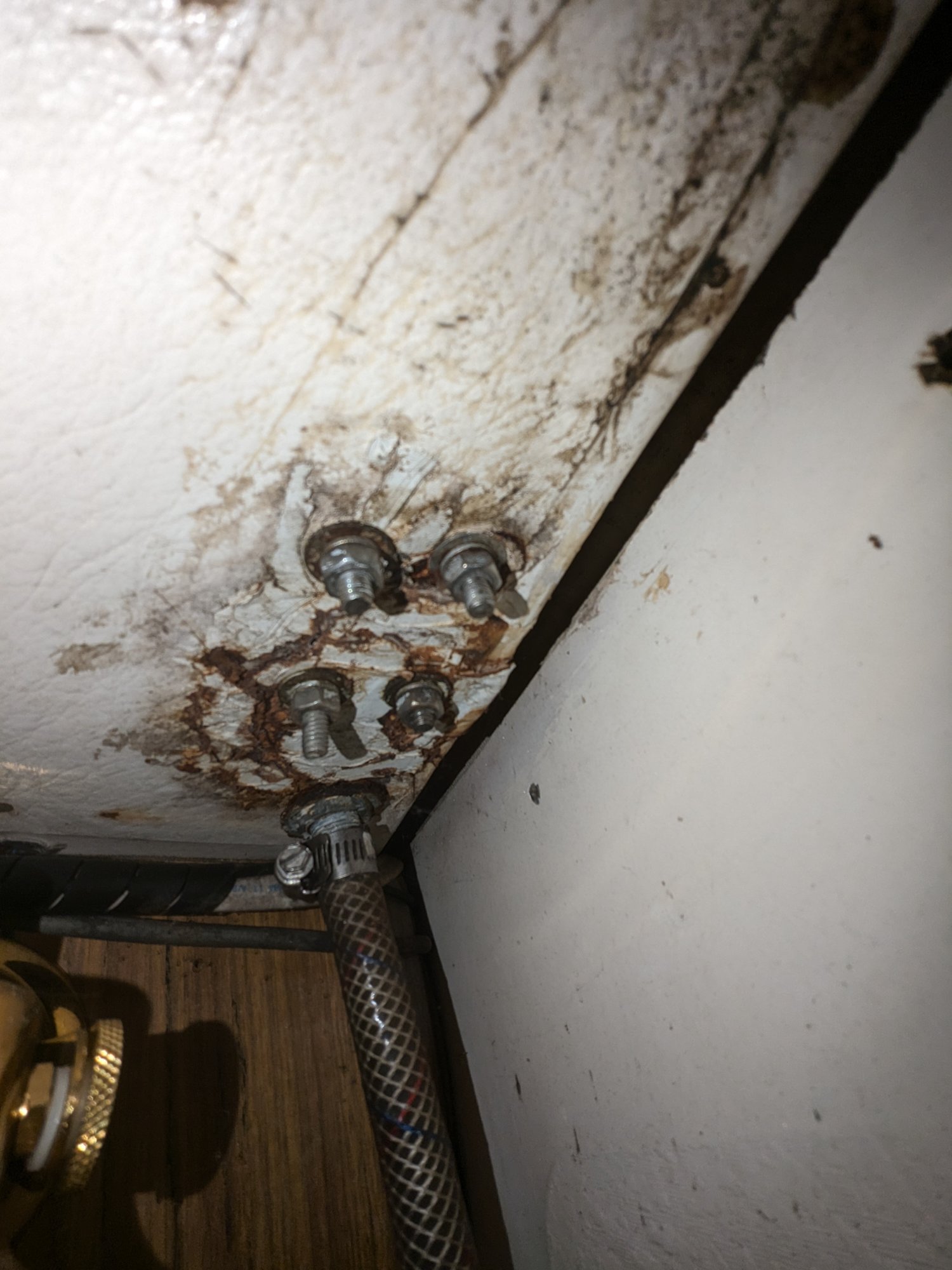

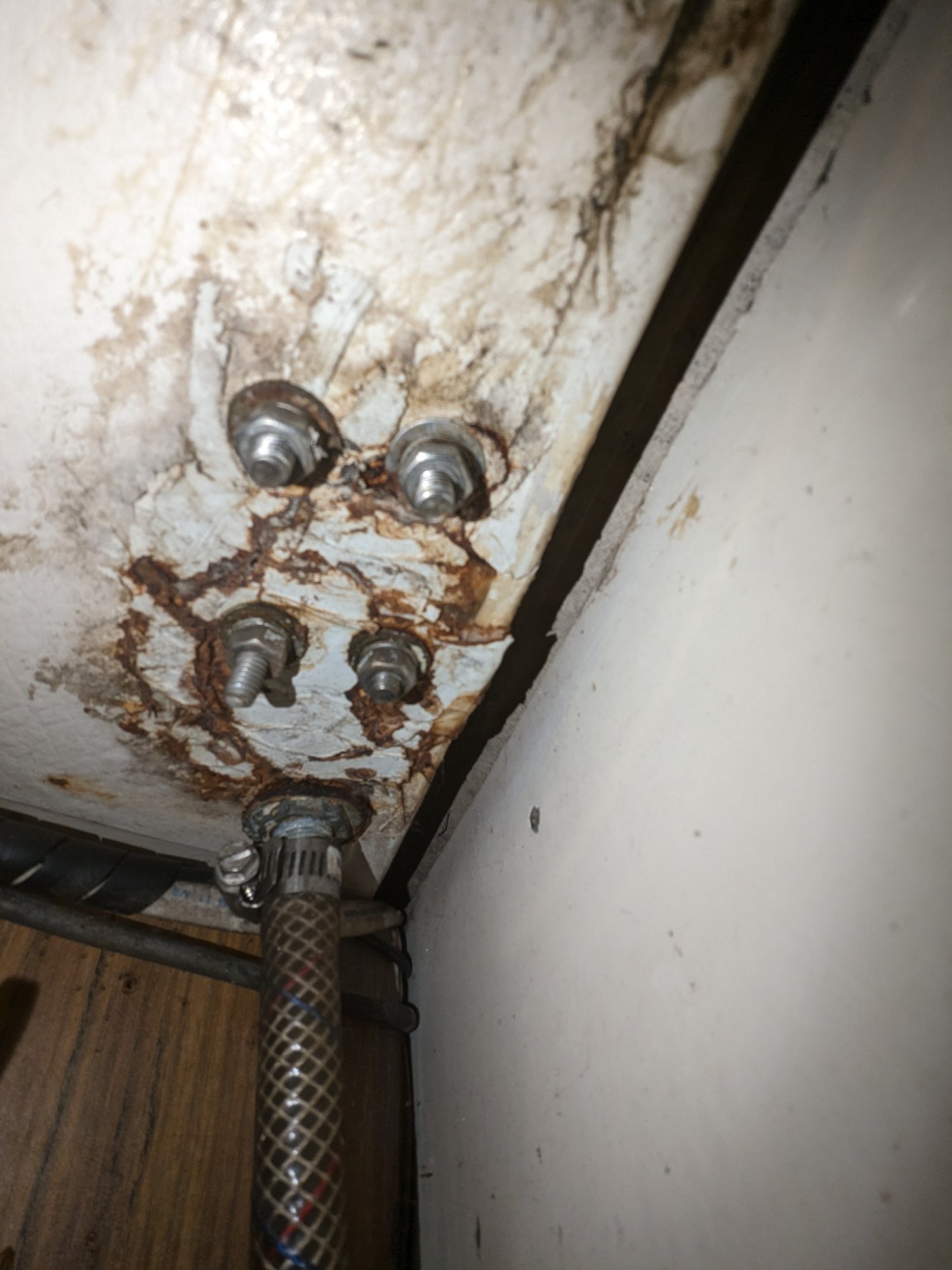

I just brought home a 1974 Catalina 22 in pretty good shape, but there's definitely some project work involved. One spot has been leaking a long time around a deck vent and stanchion base. The deck feels firm, but the cabin ceiling is flaky and gross.
I understand the process for rebedding the hardware to fix the leak, but what about fixing the ceiling? Any advice on how to go about that? All help is greatly appreciated.

That looks like clean, grind, and paint. But if it's been "leaking a long time", and it looks like that, I'd have serious doubts about the integrity of the core.
Before I concerned myself with the aesthetics of the interior, I'd remove the stanchion and that fitting and probe the core to see if it's mush.

Thanks Siamese! I will definitely poke and try to check the core well when I get the hardware off. I have been looking at MaineSail's guide to potting and countersinking the holes, if the core checks out.
I have also seen that one should put on a proper backing plate for fittings like this: what do folks usually use for that? I saw 1/4" aluminum mentioned and like that idea.

Hey George! Not silly at all! This 22 actually has a pump-out MSD installed, and the tube here is the vent tube. To me, it looks like that's the actual source of the leak.

Remove the fittings, check the ply core, and clean like mad the inside of the celling. Use a magic eraser and some bar keep friend to remove the staining. If its not cracked then the aesthetics will be up to you. If cracked and flakey then sand off the gelcoat and paint or re apply gelcoat. just know you wont match the "texture" of the cabin top. If the deck has wet / rotted core an Allen in a drill can help remove minor rot between the fiberglass layers. you can then fill the hole with epoxy and re-drill. If its a major soft spot n the deck though you'll be in for a larger repair.
I highly recommend the tech manual form the Catalina 22 National Sailing Association. it outlines how to fix deck rt and hundreds of other tasks all from Catalina owners. Its over 700 hundred pages of invaluable information.

Yep that is the leak I bet. Crazy place to put pump out vent anyway.
I have a vent in almost the same location but mine is in the side of the hull not the deck. I no longer use a MSD head so I just removed the tube and filled the fitting with silicone for the time being. The location is just above the head so path of least resistance I suppose.

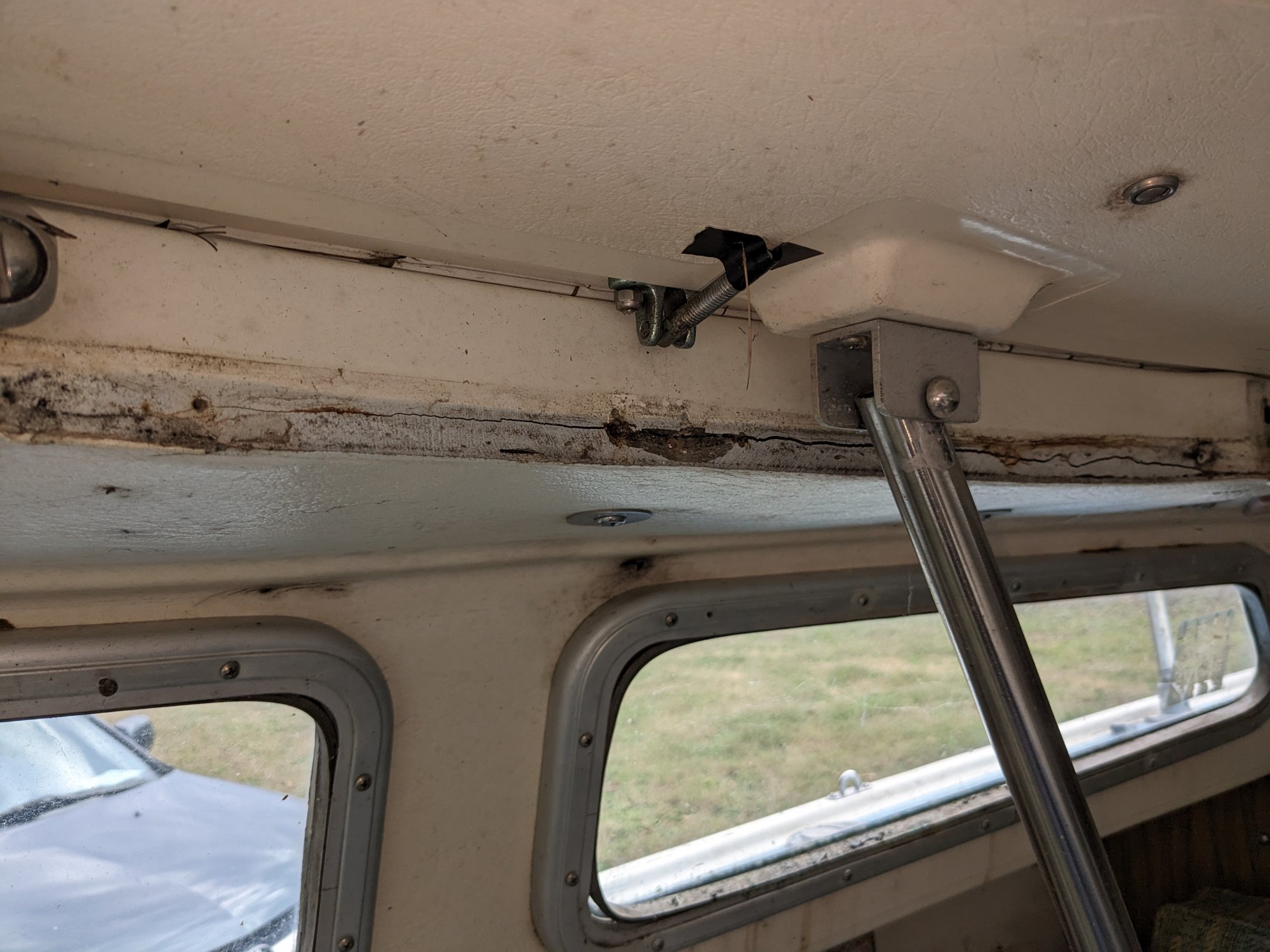

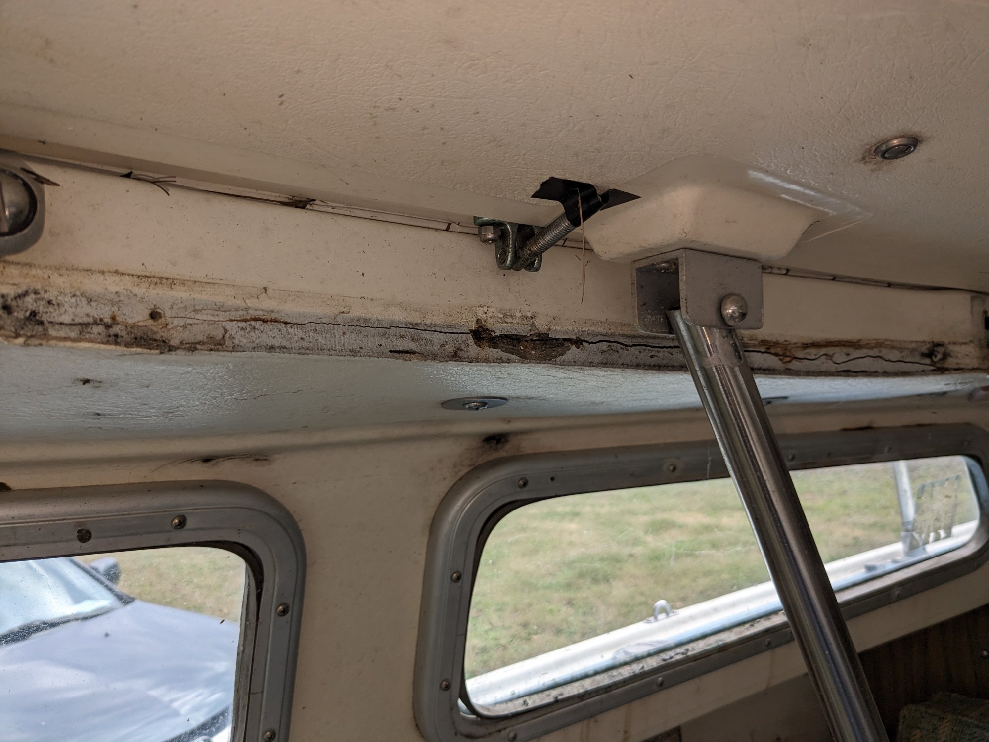

Argh: I have made an ugly discovery. I thought I had a stripped out screw for the bottom fitting of the pop-top dog hatch, but behind the trim there was a chunk missing and a big ol' crack:
I had some JB Weld MarineWeld I was going to use to fill the screw hole, so I went ahead and tried filling the void and covering over the crack with that, but it totally didn't work. When screwing the dog tight again later, it pulled the bottom fitting up toward the ceiling as the crack opened again.
Would the proper fix be to sand down now and glass over that whole joint? I'm also considering making a custom latch fitting for the bottom that would bolt on under the joint instead of above it.
Would the proper fix would be to sand down now and glass over the joint?
I can’t tell you with authority which will be the best repair procedure but I would suggest that you consider downloading the instruction manual for the West Systems epoxies and view some of their repair videos as well. As you go through your boat I think you’ll find more than one project where their base resin and various hardeners (with different properties) will come in very handy. I hope this helps.

I hate to be the be of bad news but it looks like you have a number of leaks. You likely have some rot starting. A proper repair will de

There's no doubt she's been leaking the rain in, especially around the windows. I planned on resealing the windows and all the hatch/poptop seals (which is how I ran across the issue under the dog hardware) before cleaning her up.
I just got my basic keelboat and she was a gift from a friend who kept her on the water and sailed her regularly until a couple years ago, when he parked her in his yard. I planned on fixing her up and sailing her for a few years as I learn more about handling/sailing a keelboat, keeping a boat in a slip and sailing with my family. I don't have any cash invested yet. The deck at least doesn't feel soft anywhere and she has a lot of nice hardware and good rigging.
Maybe I should reframe my question as: should I not fix her up? At least when I brought her home, she seemed to be in comparable shape to the Catalina 22s we used in class.
