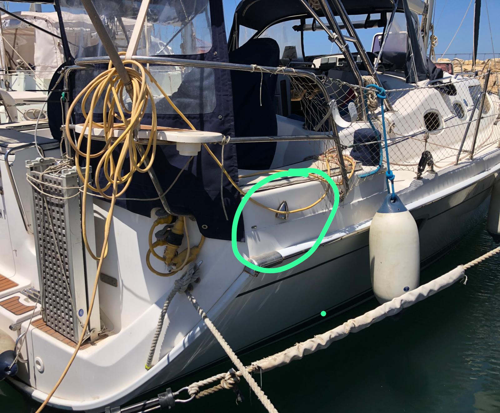

Hi!
As you can see there is no room for the cleats at the usual place because of the pulpit and the rest os seating area.
At the present position of the cleats the approach for tying is much harder than other boats I know.
I thought of moving it to the area marked at the photo but I am not sure that area is strong enough.
wondering.....
Thanks.
Dec 25, 2000
6,060
wondering.....
Different model boat here, but as I did with our boat, I posed the question to the manufacturer as to the strength of my desired location. Unsure from your picture, but to me it appears it does not have the reinforcement needed to support the stress of a cleat. Cleat loads can become quite heavy. Can you describe what is behind the area in question?

Udi
I suspected as much and your photo confirms it. You have a lot of stuff around the cleat making it difficult to access.

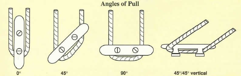

As you consider the options for your cleat, you should consider the engineering factor of a cleat. It's strengths and weaknesses.
BoatUS did an interesting write up that might help as a guide in your decision making. xhttps://boatus.org/findings/16/
Looking at your picture and the place you are considering, cleat failure could be by the fasteners pulling through the fiberglass. Cleats are designed to resist shear force.
The first three images in this picture show the cleat resisting shear. In the last image 45/45 vertical the fastener bolts are holding the cleat trying to resist the force. If the cleat is attached by a bolt and nut with a fender washer (as is so often the case), then the forces to hold the boat in place will try to pull the nut an defender washer through the fiberglass. Unless the fiberglass is exceptionally strong it will fail over time.
The way you have the boat secured to the dock your current cleat is using the engineered strengths of the cleat and the fasteners.
Placing the cleat where you are suggesting puts all the force on the fiberglass and the backing of the fastener. Not the engineered strength of the cleat.
I would not choose that cleat location for my boat.

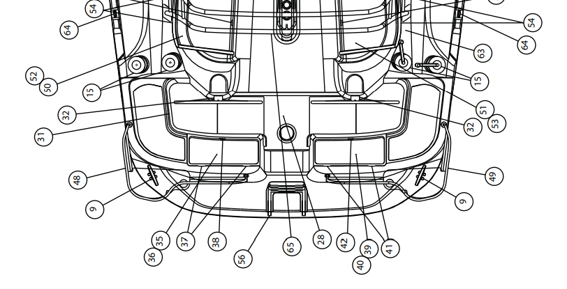

From the 45DS owner's manual below the stern cleats are part number 9. I would not relocate them. They look pretty accessible in my opinion.

Looks like there are a long cord and a folding gang plank obscuring the access to the cleat.
As I recall from a look that I took of that area its almost the same as the area of the present cleat. Tomorrow I'll take another look and will take a picture of that area in order to understand better that choice.
The folding gang plank is an added problem, but the solution for that is easy.
The access to the cleat is hard with or without the gangway at the port side.
Hi !
it is indeed part# 9 and from my experience with other boats and also with that one its not a very comfortable access.
Thanks anyway.

Udi
One possible solution is to clear the area around the cleats and use the area only for access to secure your cleats.
Thats exactly my concern. changing the cleat position may weaken the cleat ability to hold the boat secure to the dock.

Hi Udi, if you decide in the end to relocate the cleat to the new spot, be sure to back the cleat with an oversized plate washer in order to spread the shear/vertical load that the FRP bulkhead will receive. Also, the corner where that bulkhead joins to the transom, is it heavily or lightly tabbed or what type of joinery did MH use? If lightly, that could become a point of stress failure unlike where it is currently located.
If MH advises against that location, we hope one would take their advice and leave the cleat where it is and find a way to accommodate. It appears from the picture that the current location provides a better shear load strength than the new location, which seems to have a more vertical load placed on it.
