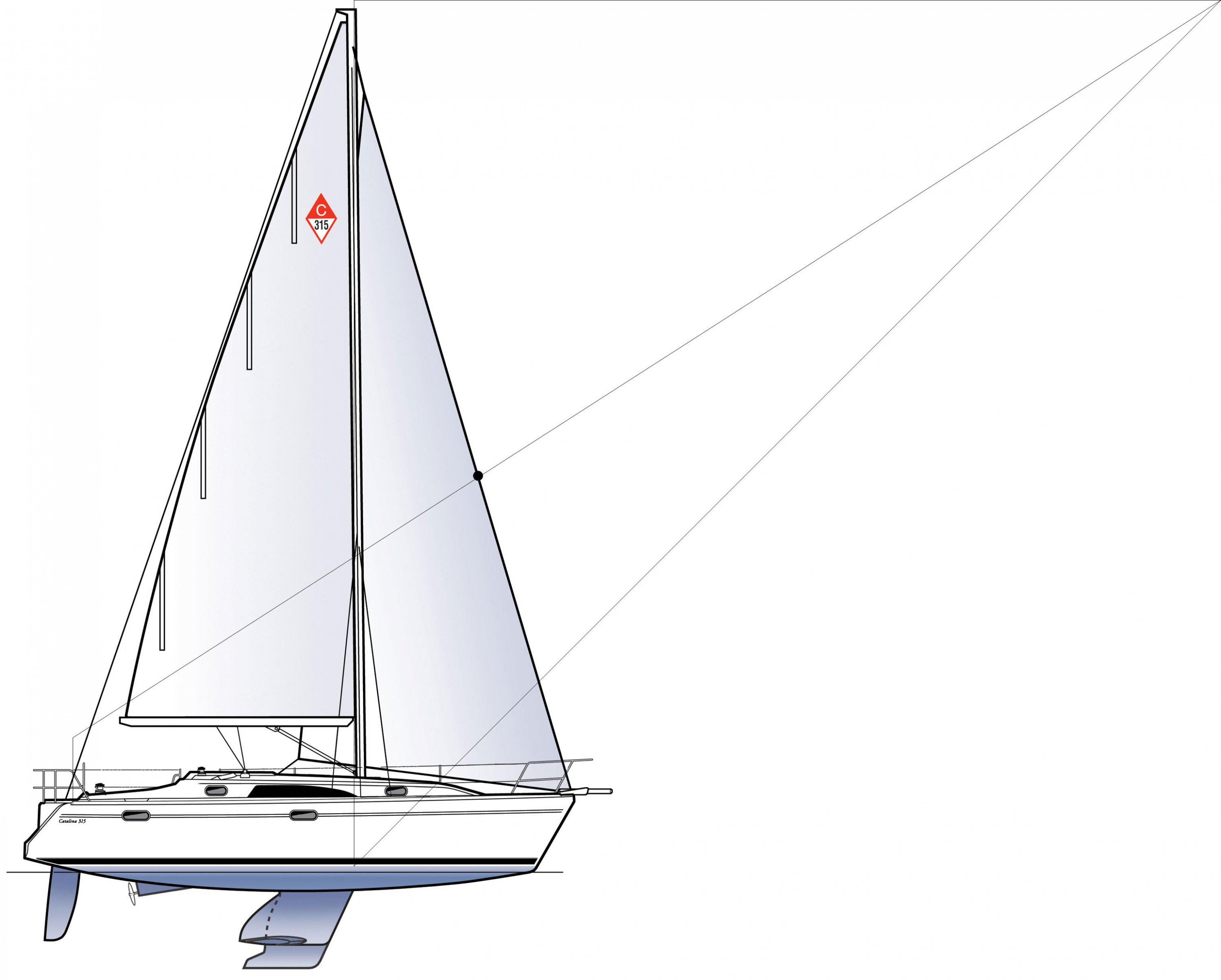

Like I said, I was bored. But the point is, if you know your mast height and you can find the correct angle from your helm that will equal about 2 boat lengths (maybe more - maybe less), then you should be able to judge if you have clearance. For me, the correct angle is a 31 degrees look angle. I would put a piece of white reflective tape on my forestay at 14' 7" from the bow plate. From my helm, that is 31 degrees.
Here is an image of a Catalina 31 I just grabbed to illustrate my point. The angle from the waterline at the mast is 45 degrees. That put a horizontal line out the same distance as the waterline to the top of the mast, maybe 2 boat lengths or so. The angle from the helm is about 32 degrees. The black dot is where one would site from the helm to see if the object is below (not good) or above (very good) from a distance of say .25 miles.
