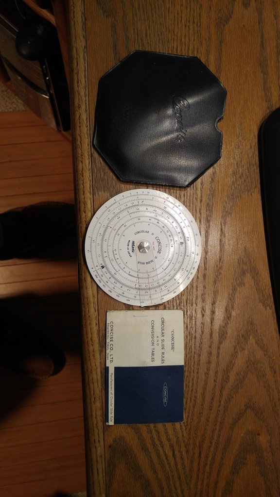

Two things:
1) I keep my circular slide rule in the nav table at all times. You never know when there will be an EMP these days. :yikes:
2) Use a sextant or other angle measuring device set to a predetermined angle (say 20 deg) from horizontal while moving at a constant speed. When the bottom of the bridge is exactly in line with that sight, start your stopwatch. Reset the angle to double the first angle (now 40 degrees). As soon as the boat has moved enough to double the angle stop the clock. Using the formula Distance = Speed x Time you will know how far you traveled. That is the exact same distance from you to the bottom of the bridge (Isosceles triangle with 2 equal sides). That distance is also the Hypotenuse of the Right triangle formed with the vertical distance from the bridge to the water and the base back to you. Solve for the height with Sin (your larger angle) = Vertical height/distance traveled. Add the distance of your eye above the waterline.
