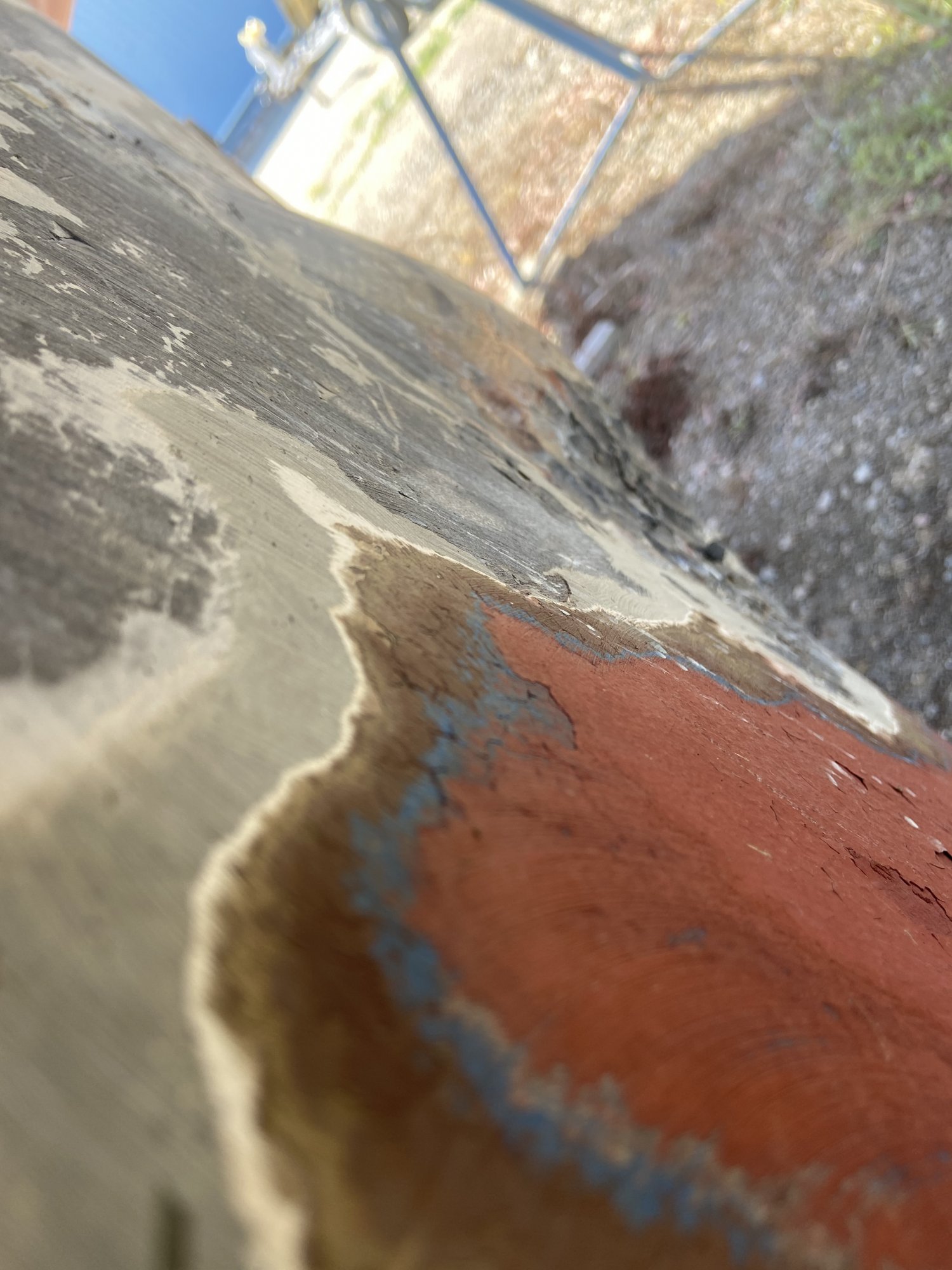

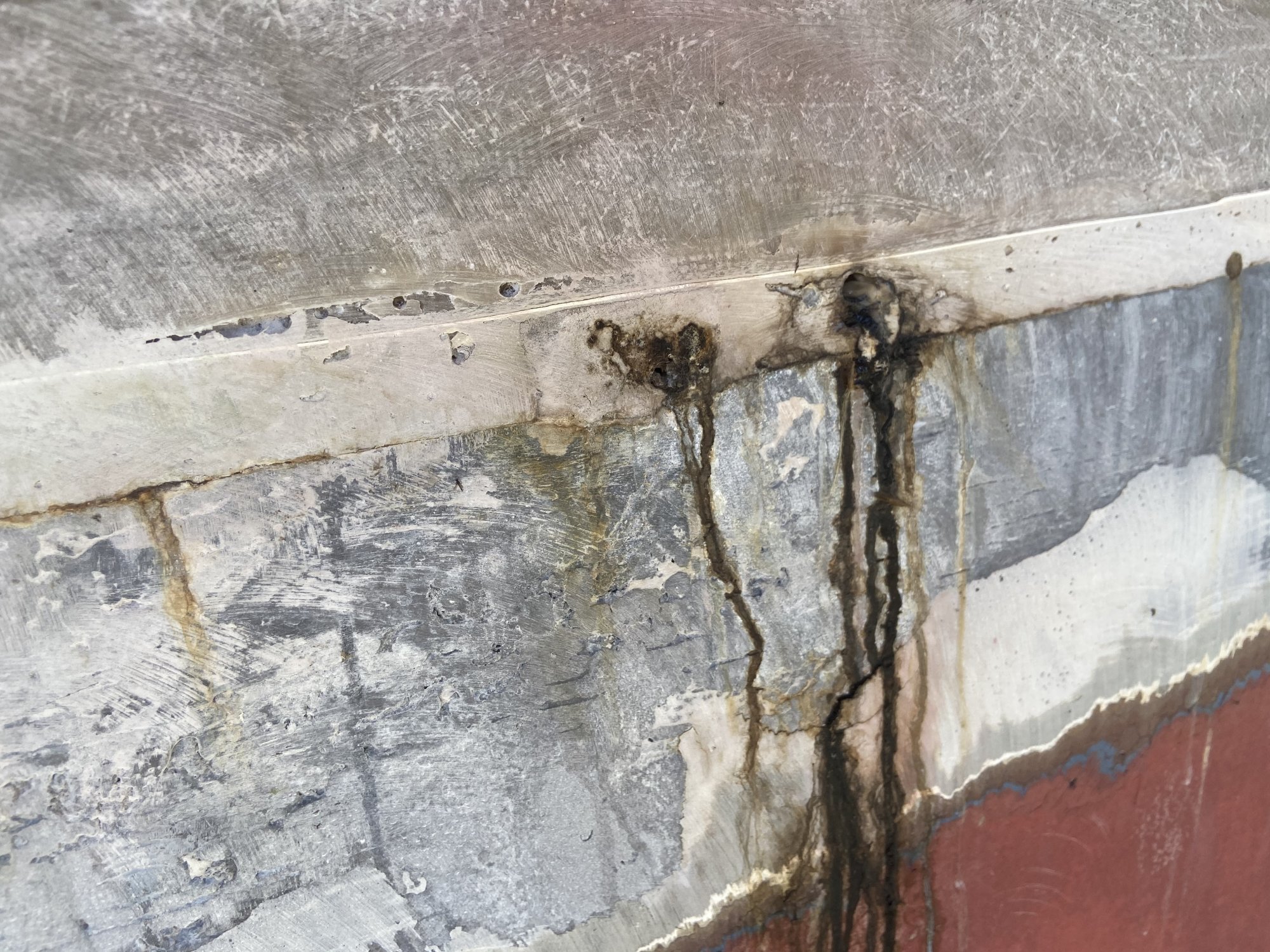

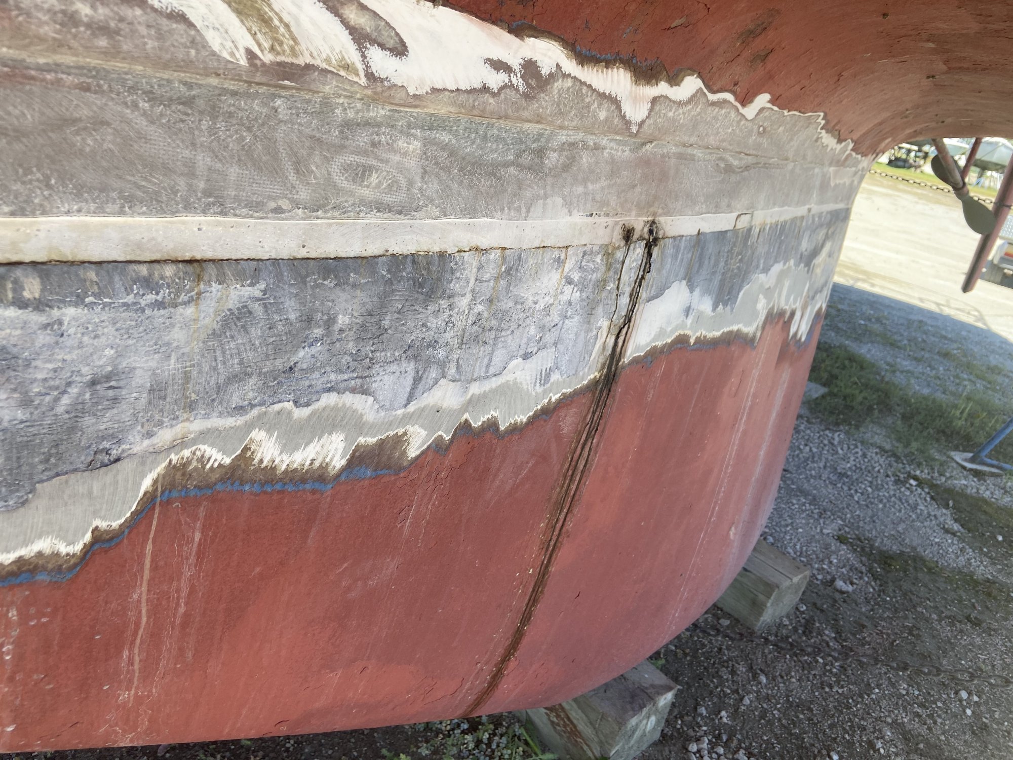

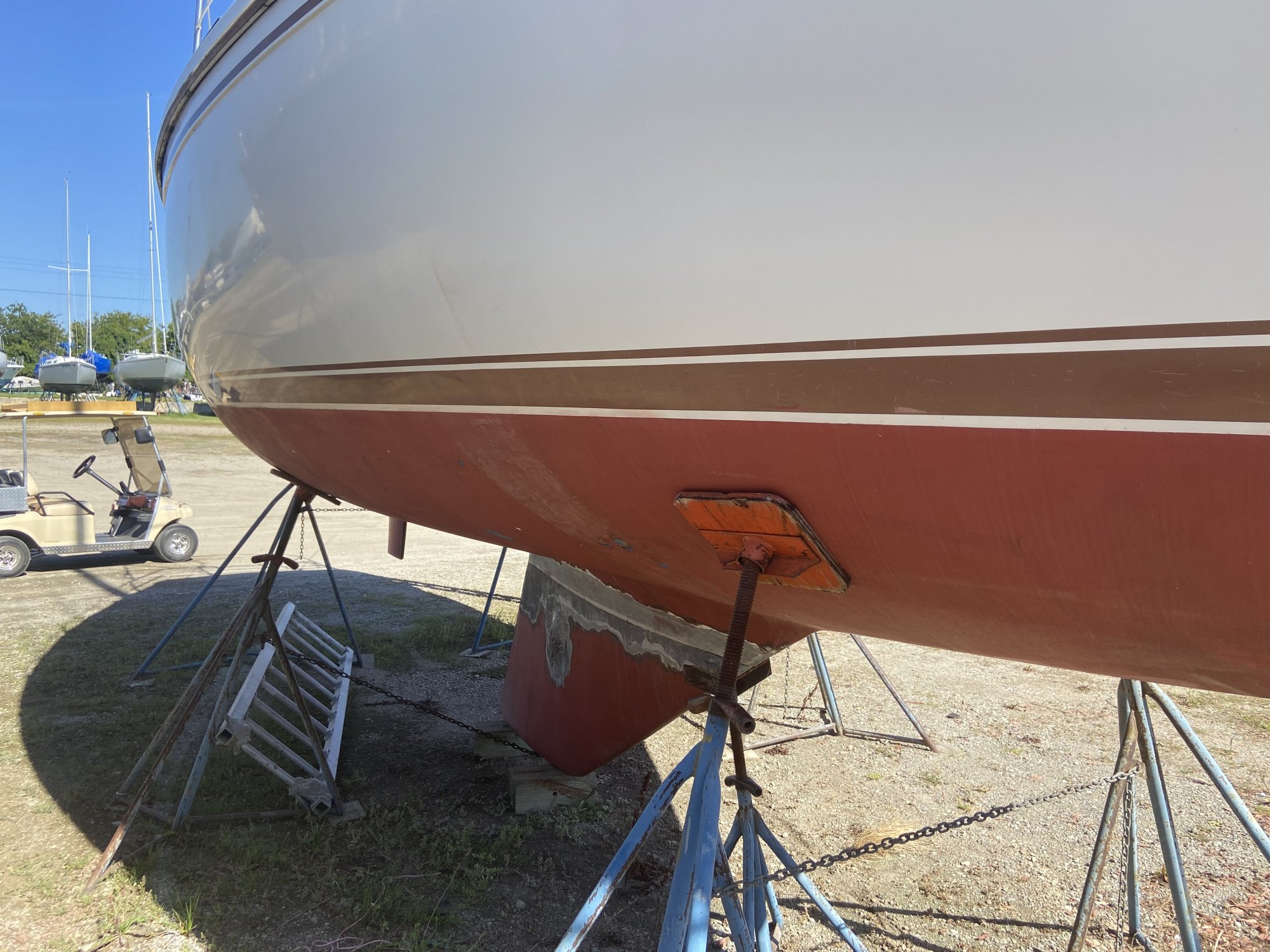

I am looking to purchase a 1983 Catalina 30 and I have some concerns about the keel and whether it is worth fixing. I appreciate any and all responses!

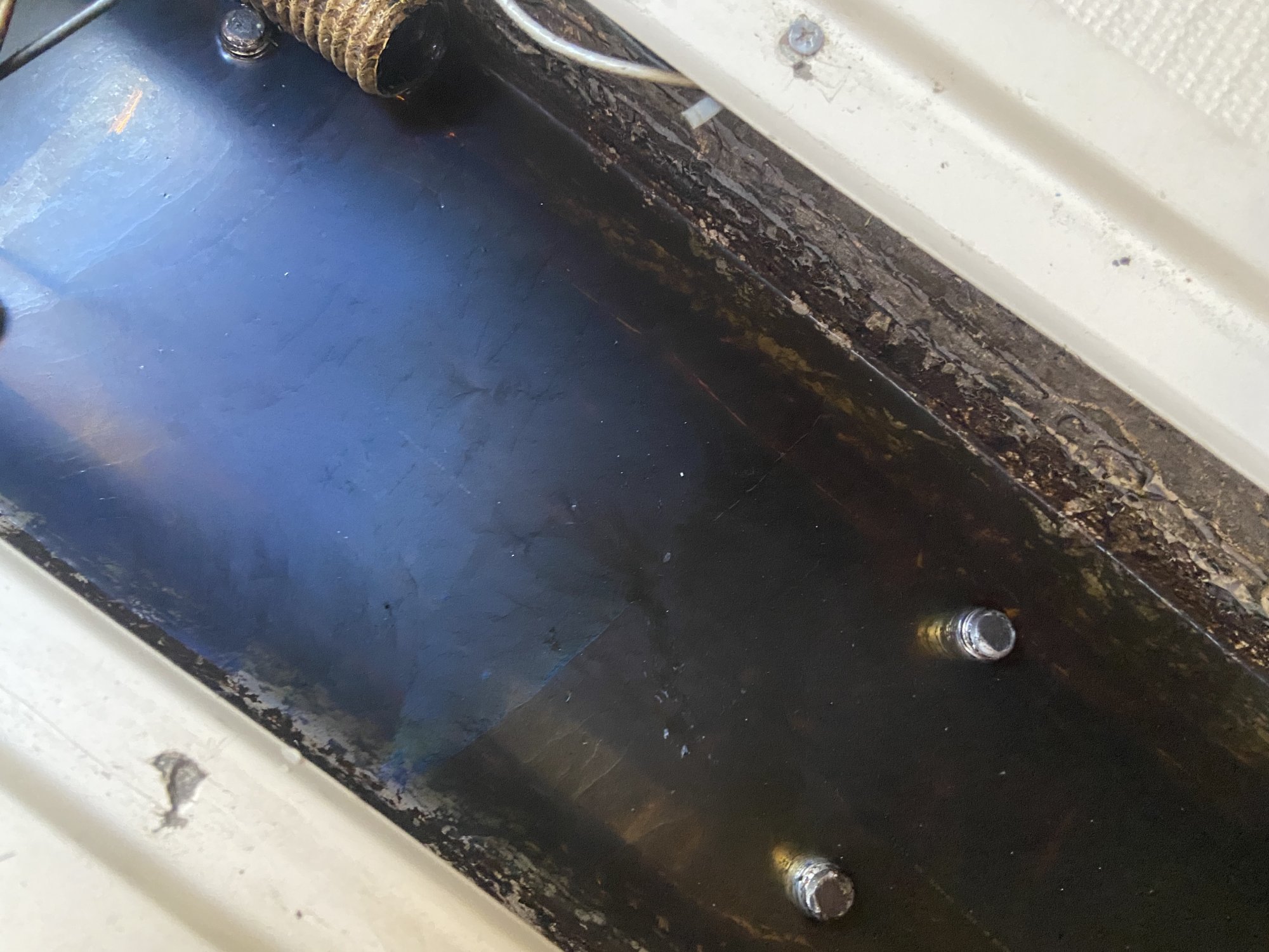

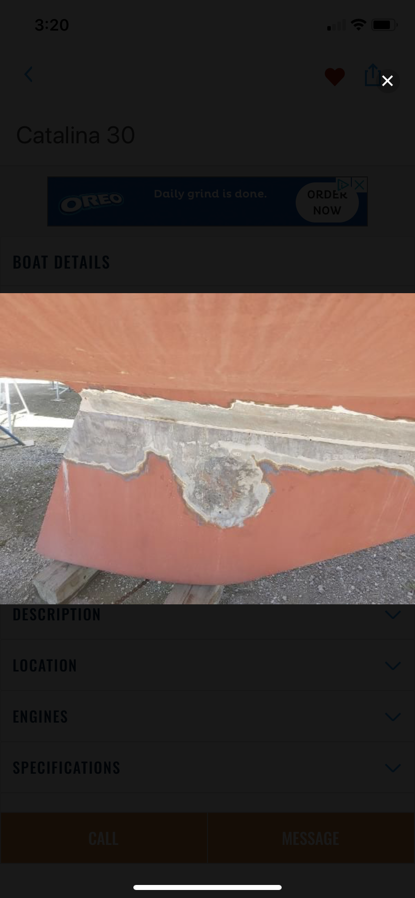

This is a lead keel and is showing signs of blistering and damage. My experience level is basic but my research would tell me that I should be able to grind this down, and fix. The issue i have is determining where the issue is originating in order to prevent it from happening again. When I go under the table and pull the board up to view the Keel Bolts, there is standing water in there. Does anyone have any advice on how I should approach this problem, and if the work is still worth the purchase?? I have trouble understanding how water can affect a solid lead keel like this --- but I suppose that is part of being new. Please see the attached pictures and again I appreciate your time! Thanks

It doesn't look too bad to me. The front needs re-sealing and keelboats checked. In 2208 there's evidence of water leaking out - probably from the water in the bilge which could easily be rainwater. You need to look into that. That doesn't look like incidental water in the bilge. Something is leaking - windows, mast and or partner, chain plates, deck hardware. A hose and a helper might tell you a lot. The bottom paint likely has copper in it. Maybe the lead and copper aren't playing nice? Or what is the "Zinc" situation? If you have to lift the boat off the keel to re-seal the keel, move on.

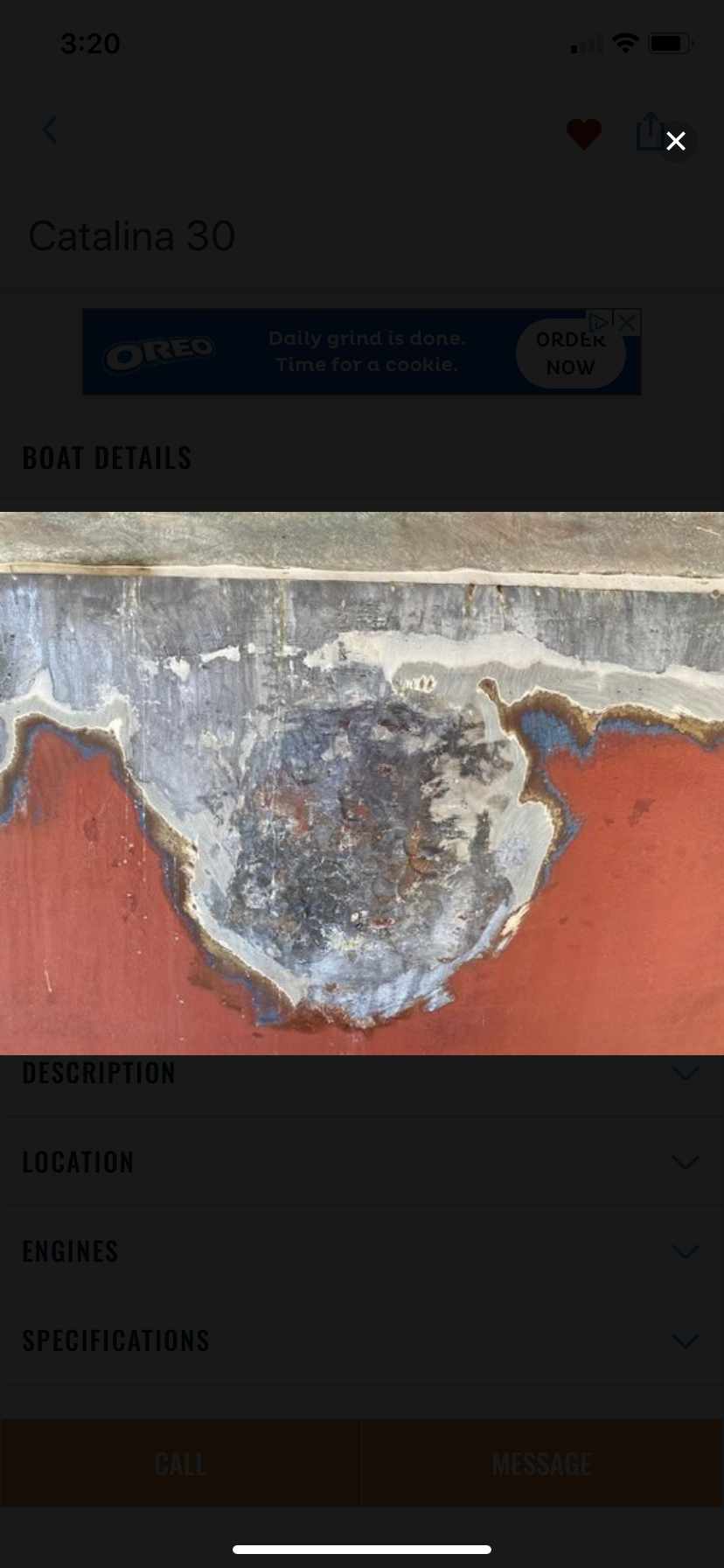

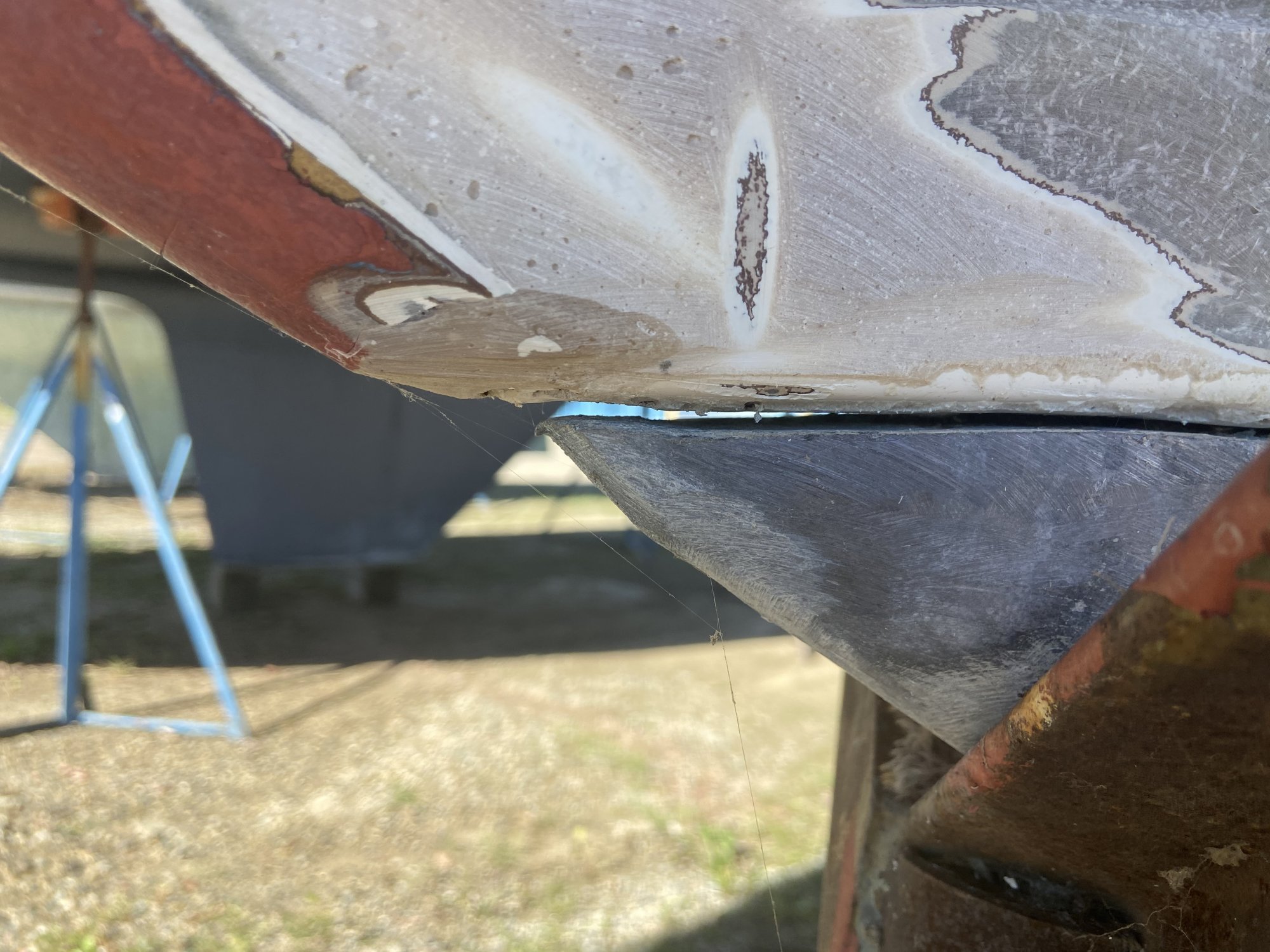

I hope you're getting a really, really good price on this boat to entertain the work involved. It's certainly do-able but as Shemandr said, you need to find out where the water is coming from. Maybe running a hose all over the boat, if you can do it the yard there. I'm more concerned about the separation in #2209. It looks as though it was a previous repair that hasn't lasted. Fixing someone else's bad repair can be a nightmare. Hope the surfaces can be joined back fairly easily.

In #2215 of the water in the bilge- I see a large hose on the left. Is that hose for a bilge pump that was removed? In 2208 where the water stains show water exiting- are there a bilge plug that was removed to let water drain? Is the water level inside at the hole position on the outside.
I too would be concerned about the separation in #2209. What does your surveyor say about that? If it is repairable, I would have it done by a professional. Also, is the separation the result of a hard grounding? You and the surveyor should look carefully for additional damage to stringers and bulkheads inside.
Lastly, can you find another boat that is in great condition that does not have any damage? You might be able to avoid this entire situation. Not every boat is worth saving.

Catalinas from that era are notorious leakers of rain water - there could be many sources. What is most concerning is the brownish ooze coming out at the hull-to-keel joint. Prior to 1988, Catalina 30's had plywood in the keel stub - if water gets into the plywood, it will rot and compromise the strength of the stub - the brown ooze is a pretty good indication this has happened. This can be repaired by removing the plywood from the inside and re-glassing - big job. You would also want to drop the keel and re-bed it.

Are you sure that keel is lead? I see rust on it which would tell me that it is steel. Much on the keel can be repaired but like the other comments I am very concerned about the seepage and the moisture. It is hard to tell the level of damage that has occurred due to that moisture and that problem must be resolved before the keel is repaired. I did some keel repair on my hunter 30 this past winter. Used Pettits faring compound and their rust inhibiting paint before applying underlayment and finally ablative bottom paint.

As captcoho said, you may want to find another boat. I say don’t walk away from this boat run away. To me the gap at the front of the keel along with the potential of stub repair due to that nasty looking stuff running out between the stub and the keel would necessitate removal of the keel to address those two problems. That job requires a high level of skill and a way to lift the boat off the keel once the keel bolt are removed. Although I have never done that I fully understand the work involved and would not take on a job like that myself. Further the marina will charge thousands to do that job. So I think it’s time to Put on those running shoes and hightail it out of there. There are plenty of other boats out there to choose from.
