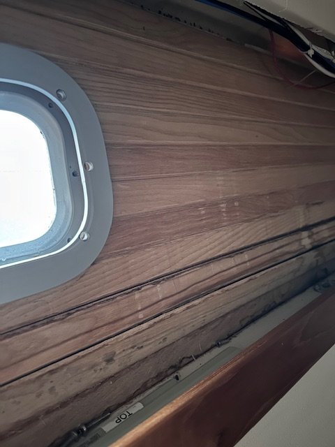

Does anyone know if there's a source for premade wooden slats that are on the interior walls of the C30 MKIII? I think some areas might be too far gone for sanding. Would prefer to buy premade than to sand, shape, lacquer, etc

The original supplier in California was a place in Rancho Dominguez that closed about a decade ago. I'd inquired about new floorboards and the owner advised me they supplied them as "trim to fit" because the boats varied. He said if I brought the old ones in he'd make exact fit. When I returned a few weeks later he had passed the night before. I don't think they made any 30's in Florida, but you might check with the factory for their current supplier.
BTW I don't think those are slats but Ash plywood.
24,817
Maybe you could find tongue and groove thin flooring or paneling to make your repairs.
Finding an exact pre-made match for the interior of a 30 year old boat seems to be looking for a unicorn. :what:
Perhaps finding a boat that was destroyed in a storm and being parted for salvage might be a possibilty. :)
Playing with mature boats requires a sense of wonder, a spark of ingenuity, and a lot of persistence.:biggrin:

I had a feeling these might not be available or worth jumping through multiple hoops just to pay through the nose. Thanks for confirming the material @Calif. Ted and @Stu Jackson. How successful do you guys think sanding will be? I know I wont be able to remove all of the stains but it's in the aft bunk so it's not very visible. What should it be re-coated with?

C30's were made in Florida starting with the 1990 model year until end of production. The PO claimed to have sourced them from Catalina in Florida and installed them on my 93 MkII.
You might want to give Catalina Yachts a call and check. I did when I needed a new mast head casting. They had two collecting dust. I bought one at what I thought was a very reasonable price. Maybe you'll find the same with the plywood slats.
And yes, they are plywood. I've had the one over the hanging locker off several times.

In my 1989 C30 they were definitely ash strips and not plywood, so they must've changed shortly after.

It's possible they were thin strips laminated onto plywood. I didn't look at it that closely but it did come off in one piece.

Nah this is a Catalina. They're too cheap to use extra material. This is glued directly to the fiberglass. So far it's falling off in one piece! I'll pull it off the next time I'm there
Try a small spot way far aft, got nothing to lose...

Mine are looking pretty bad and decayed. But hey it's an '89 also. I live in FL, not too far from factory, and have had good luck finding forgotten wood in their buildings. Will give that a try first.

I had an O'Day 26, which came with a burlap material on the walls. I liked the Catalina look, so I went on a quest to find the material you seek - I was unsuccessful. Not to be deterred, I bought some rough sawn ash lumber - 2" thick ×,10" wide x 9-10' long. I saw them into 3/8" strips and planed them to 1/4" - routed the edges, and sanded all smooth. I rubbed tung oil on them - about 7 coats. Tung oil makes repairs super easy if they ever get buggered up. In my experience - the finish is extremely durable and repair was seldom needed. I am now looking to add this upgrade to my Catalina Caprin26 - and will tell you - If I had old slats on the walls, I would refinish them rather than make my own lumber as I did for the O'Day. That was extremely labor intensive. If you look up "New Ceiling in O'Day 26" on you tube you will find a short slide show of the project. Anyway - I would be interested in finding a source for pre-made lumber myself!
