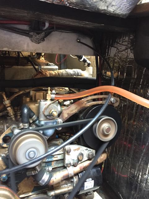

thanks Stu. I read that reference and there are many stories there. I believe you meant the description of pulling the 3/8" hose off the thermostat and pouring coolant into those till it comes out the thermostat nipple. Sounds like a great idea. I'll try that next time I'm a the boat after one more (probably) final round of burb
ing via the technique I also found on this forum. I've attached a picture of the approach I used yesterday.

Sometimes it's hard to get air out of a SYSTEM by just filling from the top. Think about it. Maine Sail's idea of an air vent is that it lets the air OUT at the top. You're filling from the top. Where is the air going to go? How will it get out? It can't. By using the linked method, you are pouring water into one side while forcing the air out the other.
Good luck.
