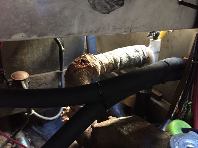

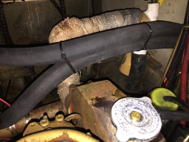

In this photo I see the seal cooling system reservoir. Behind it is that asbestus wrapped hose/pipe and at the bottom to the left, could that be the heater exchange system I need to inspect?

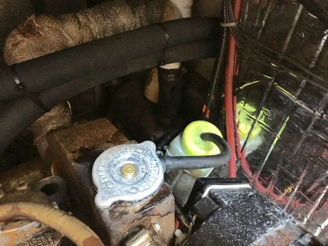

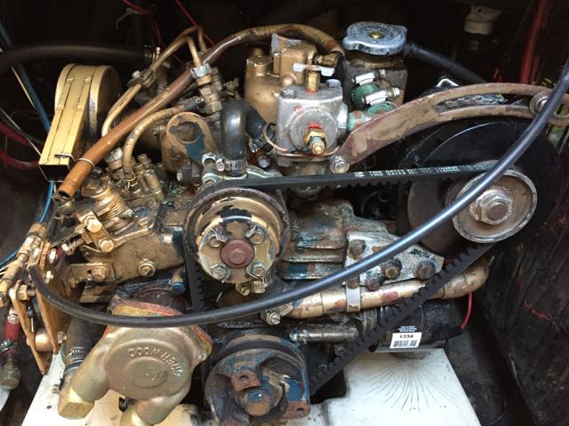

Reading the manual it sounds like the exhaust manifold and coolant engine expansion tank where I add coolant are one and the same thing. I was envisioning an exhaust manifold like I'm used to see on car motor. In the photo the top right is the coolant reservoir and the exhaust manifold, is that right? What is the procedure for cleaning out the exhaust manifold - does it normally require an acid dip?

The manifold serves as the engine expansion tank to allow for expansion of coolant as it is heated. You also fill the system at this point. In some cases when hot water heaters are installed an expansion or surge tank may be required to prevent air from entering the system.
Should your engine overheat, first check coolant level to make sure it is not low which would cause air locks to develop. If air does enter the system, it may require a couple of fillings to remove the air pocket. A momentary increase of engine RPM to approximately 2800 to 3000 RPM may aid in moving the air from the system. In some cases it may require doing this 2 or 3 times. Do this just as you notice the temperature starting to rise above normal.
I suspect you can remove the manifold to give it a cleaning. and I would suspect a radiator shop could service it. Beyond my experience but is makes sense based on automotive experience.
