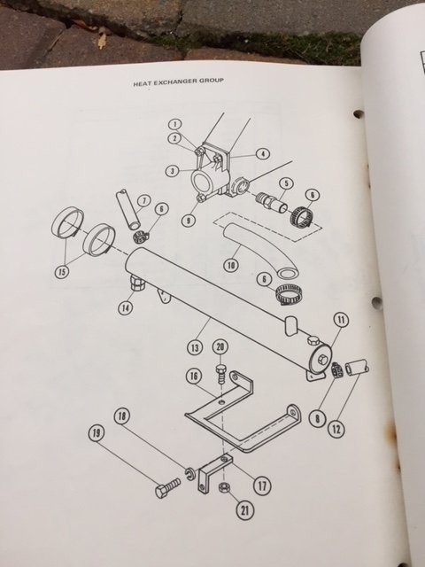

I pulled off the heat exchange and used descaler and ran a dowel thru it. There was one rubber pieced of an impeller wheel in it but not much beyond that. Hard that causing all my problems. I hope this will solve it. I'm also replacing the fresh water pump (though the last one does not look bad) and a bunch of hoses. Guess that car radiator hoses won't cut so I'm trying to order the right replacement hoses online. My original repair manual lists part numbers that are helpful but the digram in the book has one less connection in the heat exchanger than my HX has. Please see photos. Any tips on what that is? I'm not at the boat now to re-examine what the adjoining hose goes. Could it have to do with my water heater that I've not yet tested and it probably doesn't work? Does anyone have a full set of hose part numbers and a source I can order from? I'm using DiscountMarine and am asking them this same question as the unexpected HX hose fitting.
Gotta have an inlet and an outlet for both the raw water and the coolant.
I believe what looks like the unnumbered hex nut to the left of the 11 in your parts diagram is where the nipple sticking up at the bottom left of your photo is screwed into your heat exchanger. That's your fourth connection. I think it is the raw water out but can't be sure without looking at your setup. EDIT: Looked at mine today and that is indeed the raw water out. It goes to a vented loop and then to the injection nozzle in the exhaust riser.
The diagram in this attachment shows it as 3/8 NPT:
http://inetmarine.com/skuni298633cnheatexchangercuni.aspx?gclid=CMy5-cX2iNACFQyffgodYLQHCw
That doesn't help you though with what size hose you need for that nipple on your HX. Gonna have to measure that.[/QUOTE]

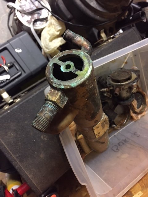

that link you posted looks like the HX and the price is good on it. I can measure the diameter of the threaded
connection. Here is a new photo of my HX. My Hx has that same part number on it 298633 but that is also the same number listed in the engine manual that displays with one less connection on it.
I'll contact the business at the link you sent to see if they have the right hose.

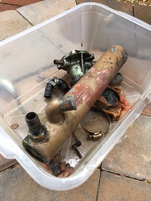

that inetmarine site not only shows the HX I'm trying to match ,it also has a price about 1/2 of what I've seen elsewhere. I'm tempted to buy a new HX instead of re-installing my cleaned-up, but visually beat, 32 year old part. Do you have any experience with them? Is this a quality replacement part? Hopefully they can help me identify the hose I need.

I recall reading in the owners forum about replace zinc when you deal with the HX or at least inspecting it. I recall my surveyor saying the boat zinc looked good but cannot recall where he found it. From my photos of the HX do you see a place for zinc or is it under the boat on the shaft in my case?

The zinc is item 14 on your schematic (not visible in your photos but it is at the under side of the tube at the top end of the picture on Tuesday's post). It is a pencil zinc as described here:
http://shop.toadmarinesupply.com/sh...l+Zinc+Anode+1/8+NPT+X+2+inch&sectionid=Zincs
It should be readily available at most marine supply shops.
You should check the zinc every three months or so until you get an idea of how fast you go through them.
If you pick up and shake the HX does it make any noise like there are small bits of old zincs rattling around in the end?
I don't know about the company or the particular HX I sent for an example. It was just something that came up in an internet search. If you have doubts about your HX you might be able to take it to a radiator shop and have them pressure test it for you.
I don't think the hose you are talking about (raw water out from hx) is a stock part because it would depend on the installation of the engine to the particular boat. Just get a section of the appropriate hose of the length and diameter you need.
You might want to consider getting an appropriate hose barb fitting instead of what looks like a pipe nipple in you photo.

so I descaled the old HX and had it tested and it came up as no leaks. I went ahead and replaced it anyway, along with all the hoses and the fresh water pump. I inspected the raw/sea water impeller and it looked fine and the one I purchased did not fit so I'll do that later. As a reminder, I already replaced the thermostat and cleaned the exhaust manifold. I took her for a test motoring and for 30 minutes or so she ran at 140 degrees. Then she spiked back up to 215 on a motor that should 180. I noticed a tiny leak in the lower thermostat housing - a crack. I've ordered a replacement for this part. My local mechanic, who has serviced the boat in the past, commented that I should flush the block. Earlier when he cleaned the exhaust manifold he partially flushed it by pulling the lower thermostat hose off when he ran water thru it. Now we found the drain plug/faucet on the starboard lower side of the block. I'll siphon out as much anti-freeze from the overflow reservoir and the exhaust manifold. Then I plan to open her up (open the drain) and she if she drips or is clogged up. If clogged, I'll remove the plug completely and if needed poke in the hole with a wire to open a flow up. Once I get her open, I'll attach a water hose to exhaust manifold/reservoir and flush her thru. My question is, how do I catch the flow and avoid having it simply go in the bilge and be pumped out into he harbor with the antifreeze residue? The drain is only inches from the bottom of the boat so there is no room to put a receiving pan underneath it. Can I hook up a hose and siphon it out? If I have crud in there it will clog my siphon but I can throw that out. How have others done this? A mechanic friend told me to drain it then fill it with water and toilet bowl cleaner and run the motor a while, then drain, fill with baking soda and water to neutralize the acid in the TB cleaner, drain that, flush with water and finally fill with antifreeze mixture. I'd like to avoid those several cycles of flushing if I can and if water alone has done the trick for you fellow boat owners.
