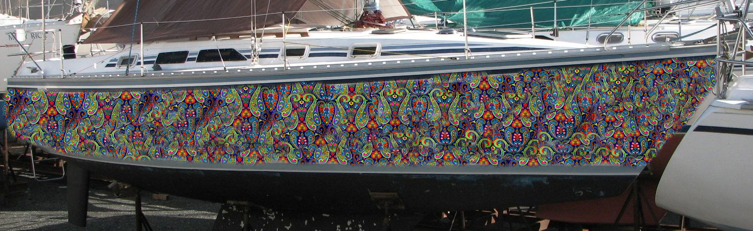

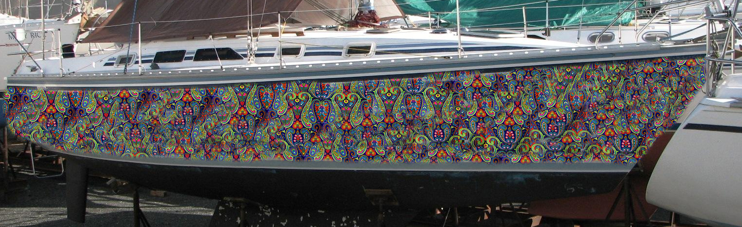

If I were going to paint my topside, I'd go with a greenish brown that matches the stains that the water is going to impart anyway.
Oct 24, 2010
2,405
Hunter 30 Everett, WA
Go with something really ugly so my boat will look a little better.

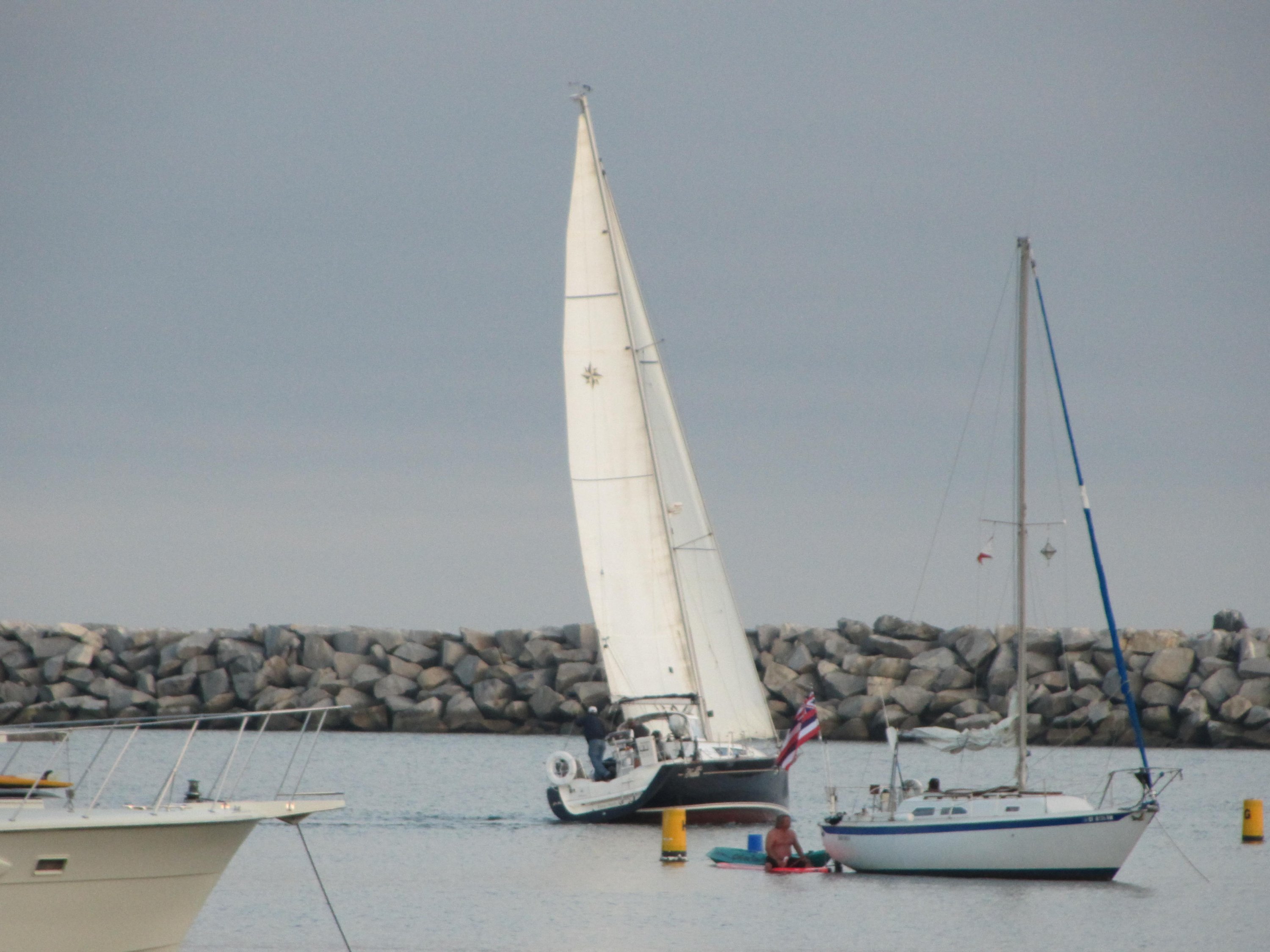

My friend's 06 Jeanneau also has the dark blue Imron paint, we get complimentary comments everywhere we take it. It's held up really well except we just noticed the docklines were wearing the paint, a couple stainless strakes will cure that problem.
