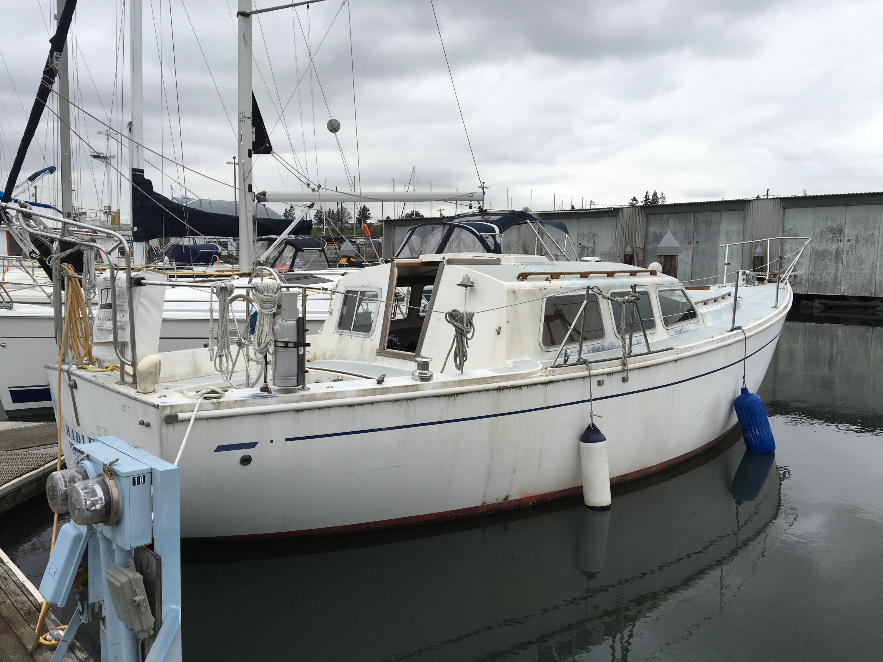

My temporary motor boat. In need of new hull paint.

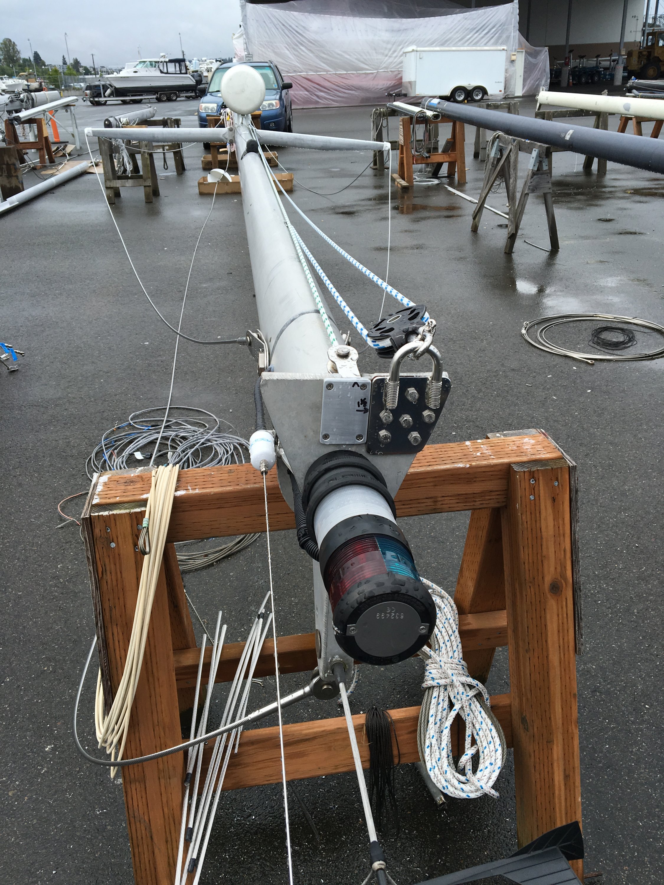

Mast just about done, new wiring, self tailing winches, all new rigging
Mast head with new Navigation/Anchor light, Spinnaker halyard/block, VHF/AIS antenna, and base for wind indicator.

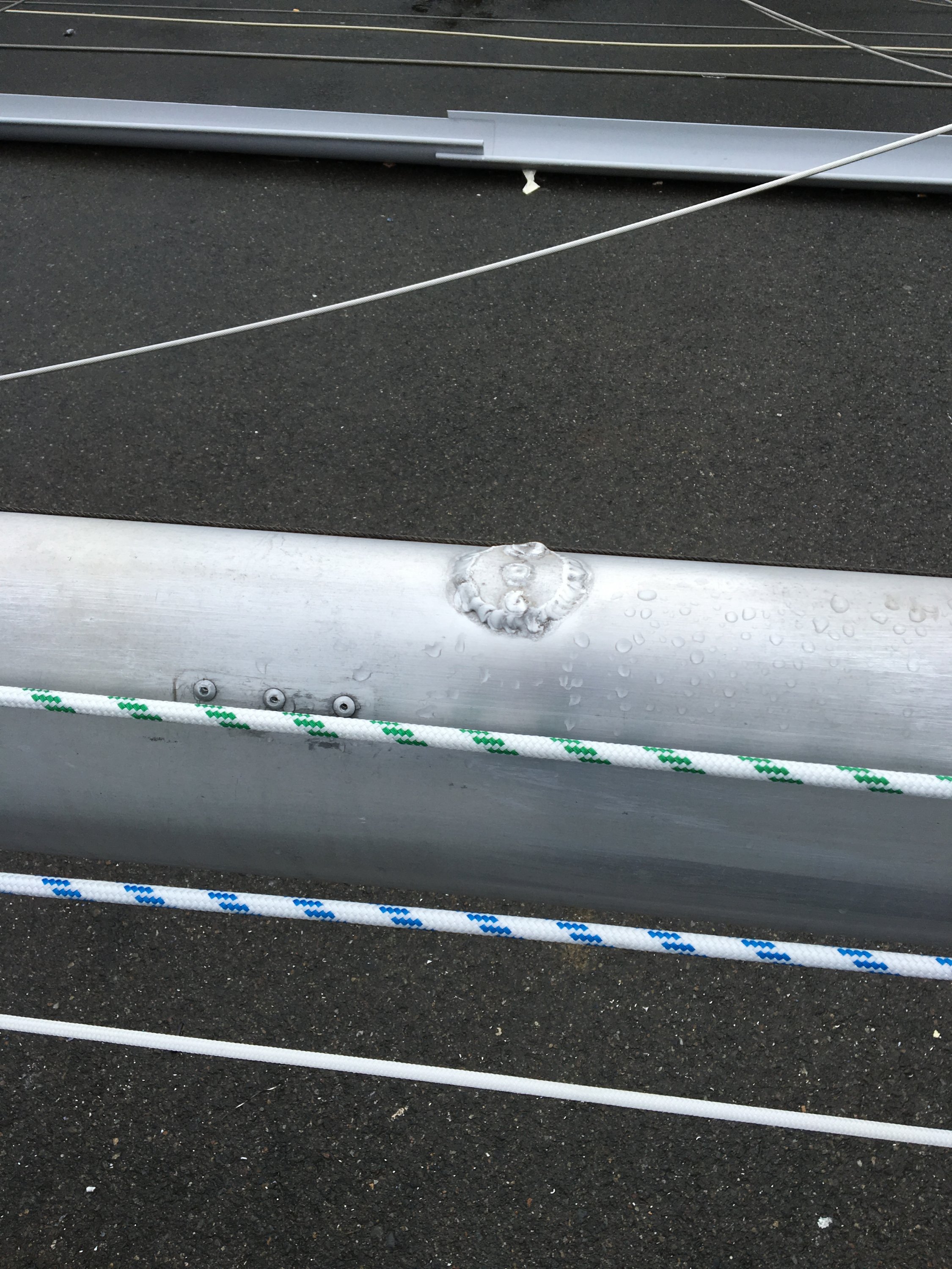

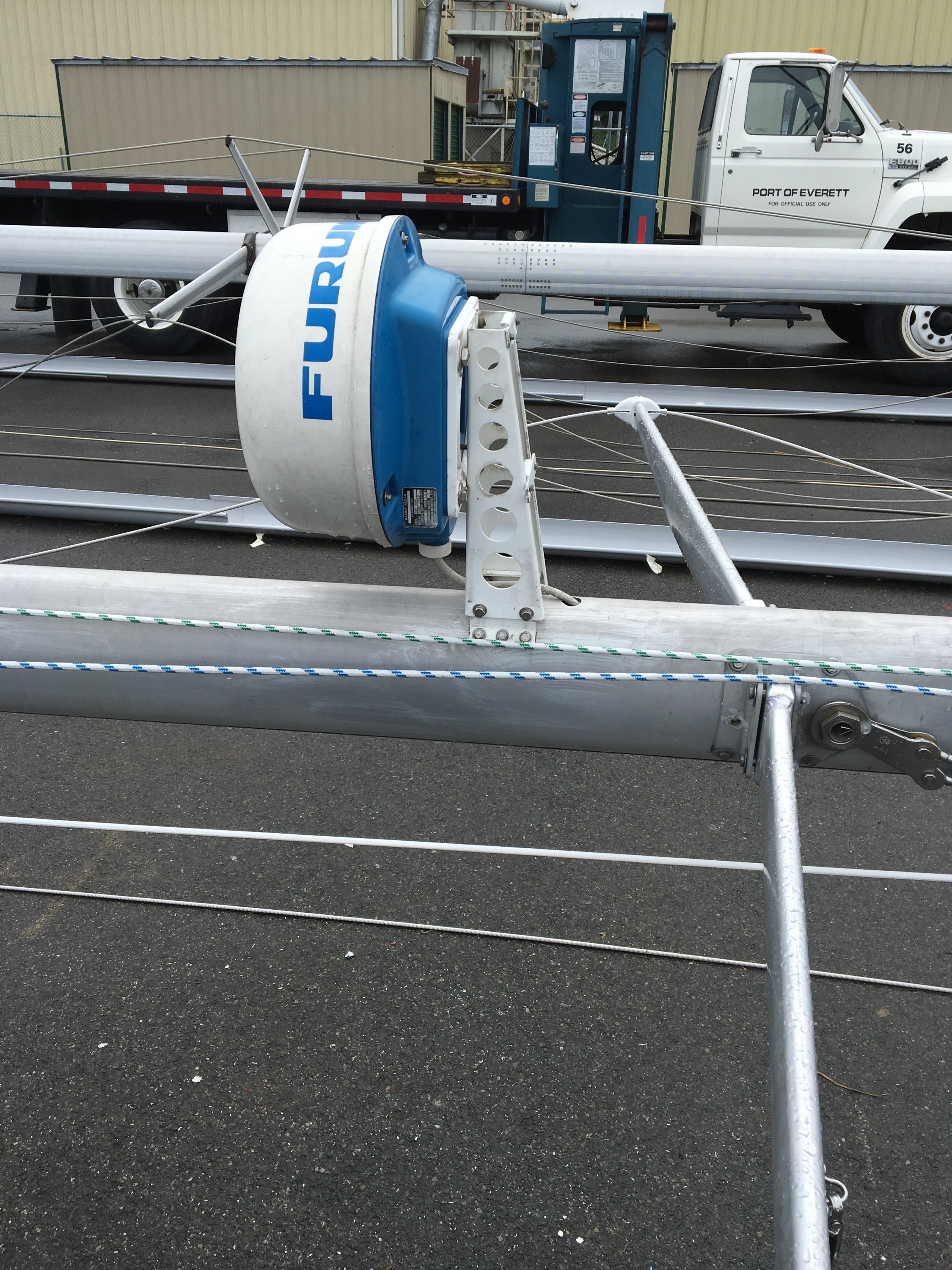

New location for radar. Opens up possibility for cutter rigging
Old radar hole plugged

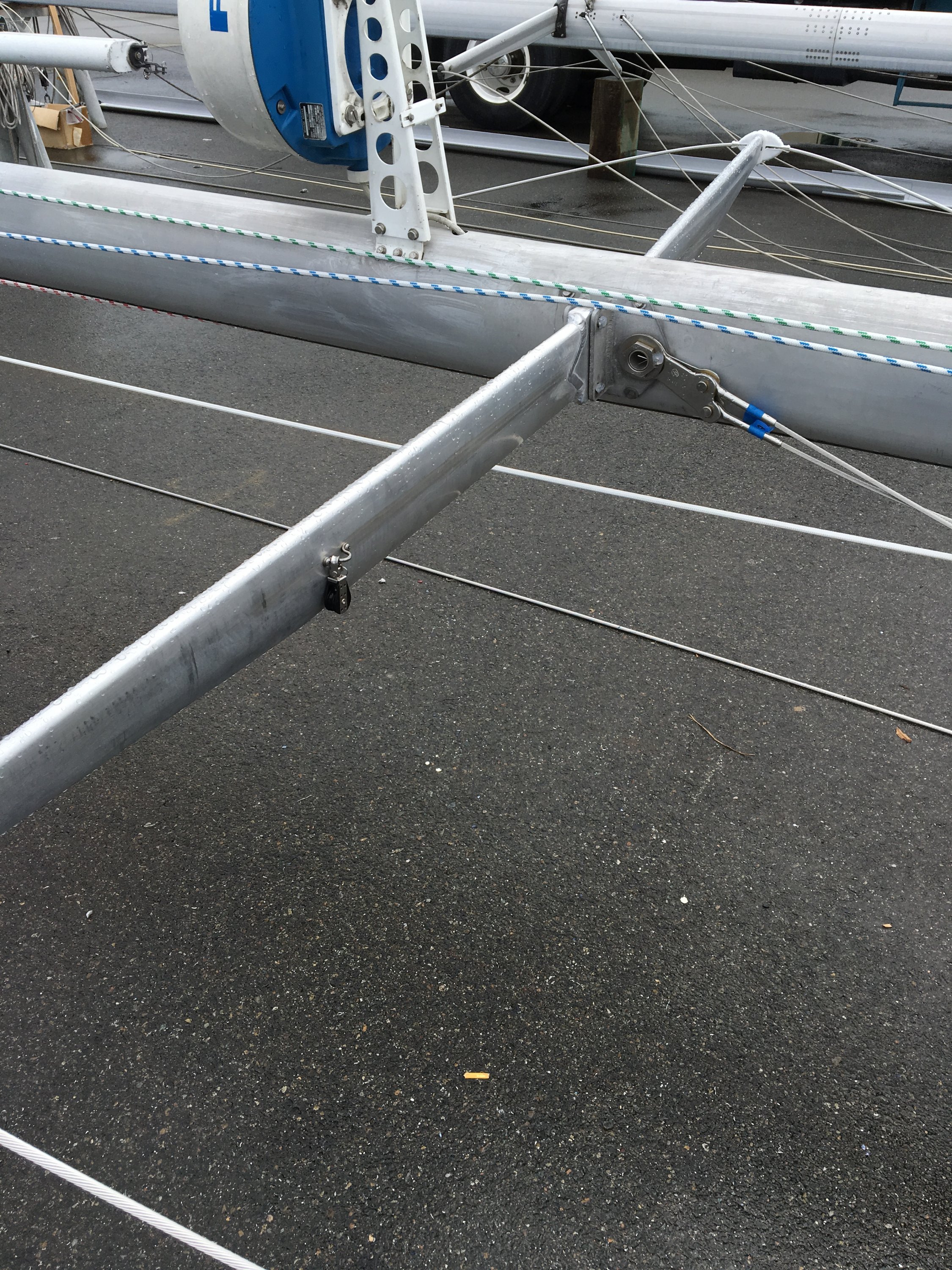

New aluminum spreaders.
Original wood ones rotted. Do not know how the mast stayed upright.

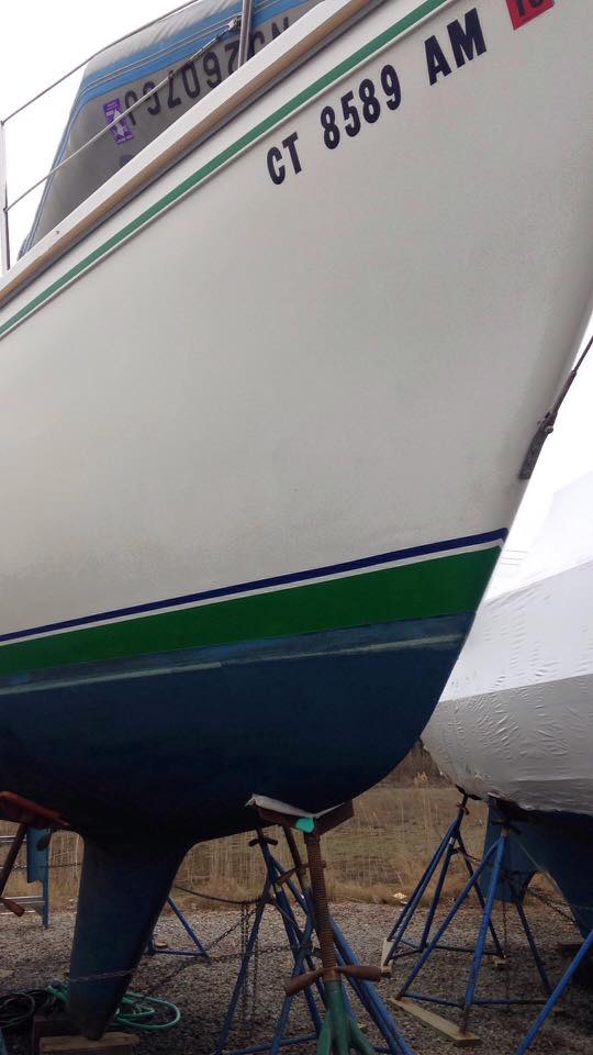

I agree that painting your hull is a LOT of work. We just finished our boot and cove stripes and it was very labor intensive.
Check the link that Stu provided, some great info there. 13151736_10209291830193176_6875608909386949734_n.jpg
As for paint we used Pettit EZ-poxy (due to color choices) and the roll and tip method. Prep is very important or the new paint will fall off in sheets.

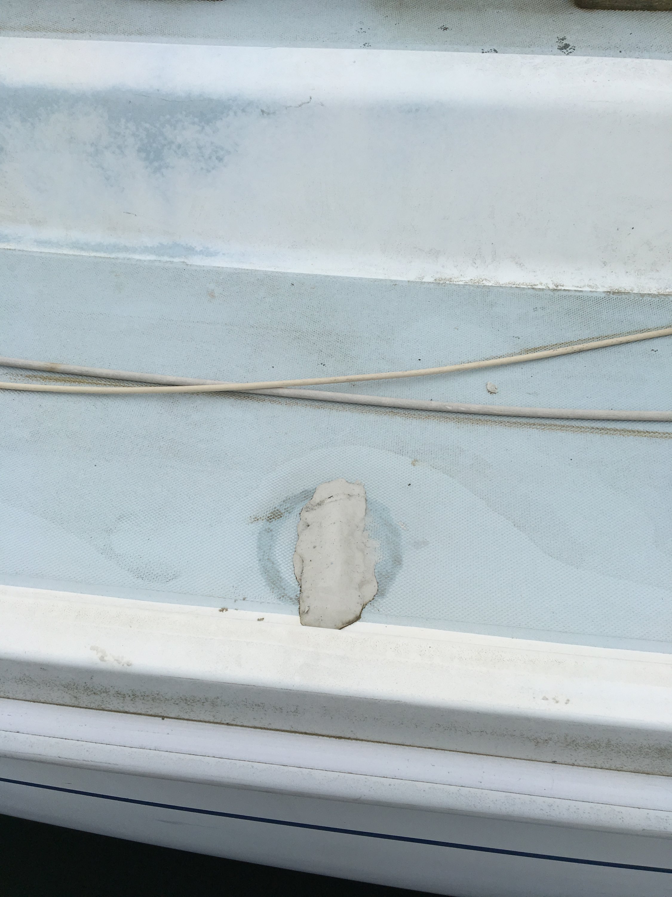

This is an image of the port side deck. In the foreground is one of the chain plate holes. Plugged with non-staining plumbers putty till the chain plates cane be prepped and installed. The non skid is a baby blue paint. The smooth looking stripe in the upper third of the image should be white gel coat side of the cabin. It is oxidized and the PO buffed/compounded/ or sanded through the gel coat till the light blue color of the fiberglass is starting to be exposed.
This smooth deck is what I am thinking to paint white. A smooth hard two part epoxy paint is what I think would work. I hope I will be able to do this in the marina on a couple of good weather days. It would need to be done in sections. Prep the area, tape off all the non painted section. Paint and then clean up.

You know, I would tend to think along the lines of a single-part polyurethane, rolled or brushed, and tipped, doing small sections at a time; sanding and prepping over small areas. Small bites; you can fly under the radar. Less critical areas to start. I think you can get a formulation for non-skid too (outside of California). She can't help but look far nicer with your effort and you won't be a slave to it. Good luck whatever you decide and nice job bring a nice boat back. Enjoy her!

I believe I would do that deck with either Brightsides, or EasyPoxy. Both are single-part polyurethanes. Have not used the Pettit product but the Interlux Brightsides is a really nice working paint that doesn't require any special skill, levels nicely to a good hard shine.

So tell me about the single part polyurethane's. Hard enough for non walking deck surfaces? How do they go on? What are the drying times? I was looking at the 2 part epoxy because of what I thought to be a hard surface paint that would give me a longer usable life. Perhaps this is misguided, or the process would be too complex and better to look at shorter life and easier process.
