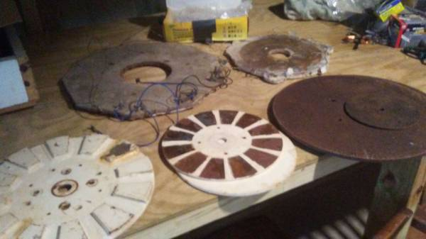

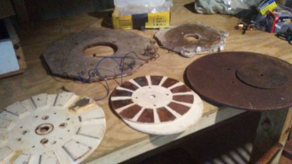

As for the wind generator, save your money and put it into solar and storage batteries. There are so many negatives the little power you get overnight is not worth it. The output on those things like the typical "Air" brand are always overstated. I have built several wind generators from parts and I mean literally pieces. Hand winding the coils, calculating how many turns per coil for a good cut in voltage, casting the stator and casting magnets on a steel disc...
Solar and good storage. I repeat, solar.
Actually, I have an ad on c-List trying to get rid of my old parts,

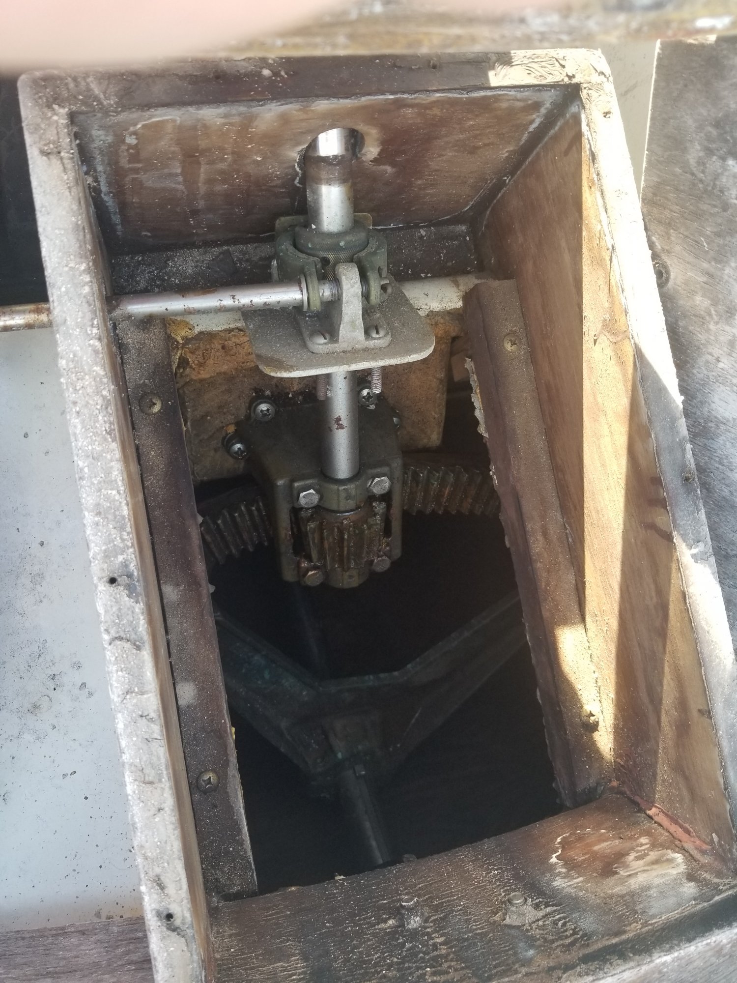

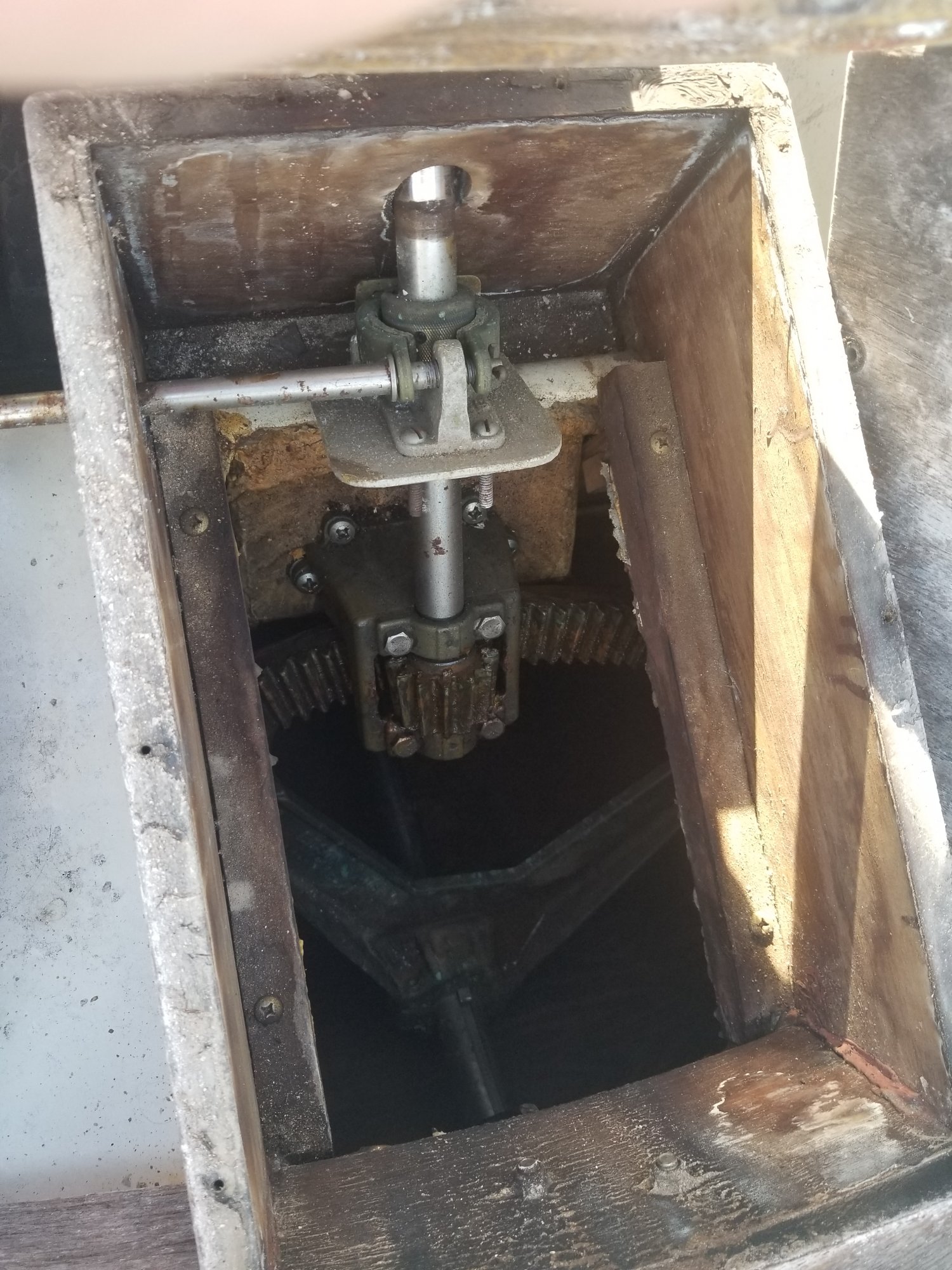

My steering set up.
That's exactly what I expected. Those are quite robust steering mechanisms, and your's looks to be in decent condition as far as I can see in this image. The difficulty, in my mind, is how do you easily move the position of this steering mechanism. You pretty much have to redesign and build a completely new steering control mechanism. I'm not saying it can't be done. It just may not be an easy thing to do. Are you going to move to a cable system? Hydraulic system? How will you set up the pulleys or piston? Are you going to modify that sector gear attached to the rubber post to accommodate your new system? Build a new attachment mechanism?
Hey, maybe you have a slick idea, I'd love to know what it is...
