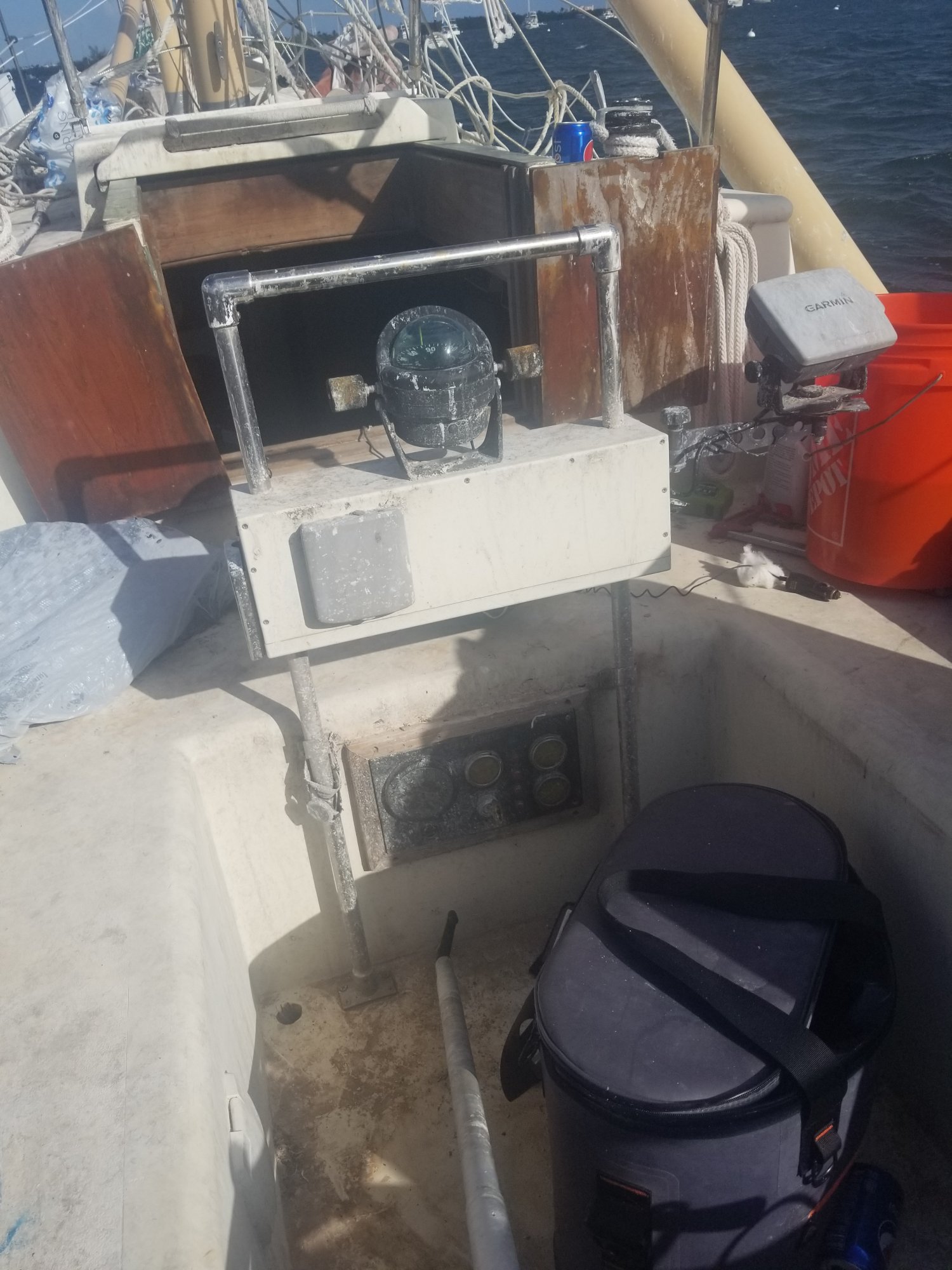

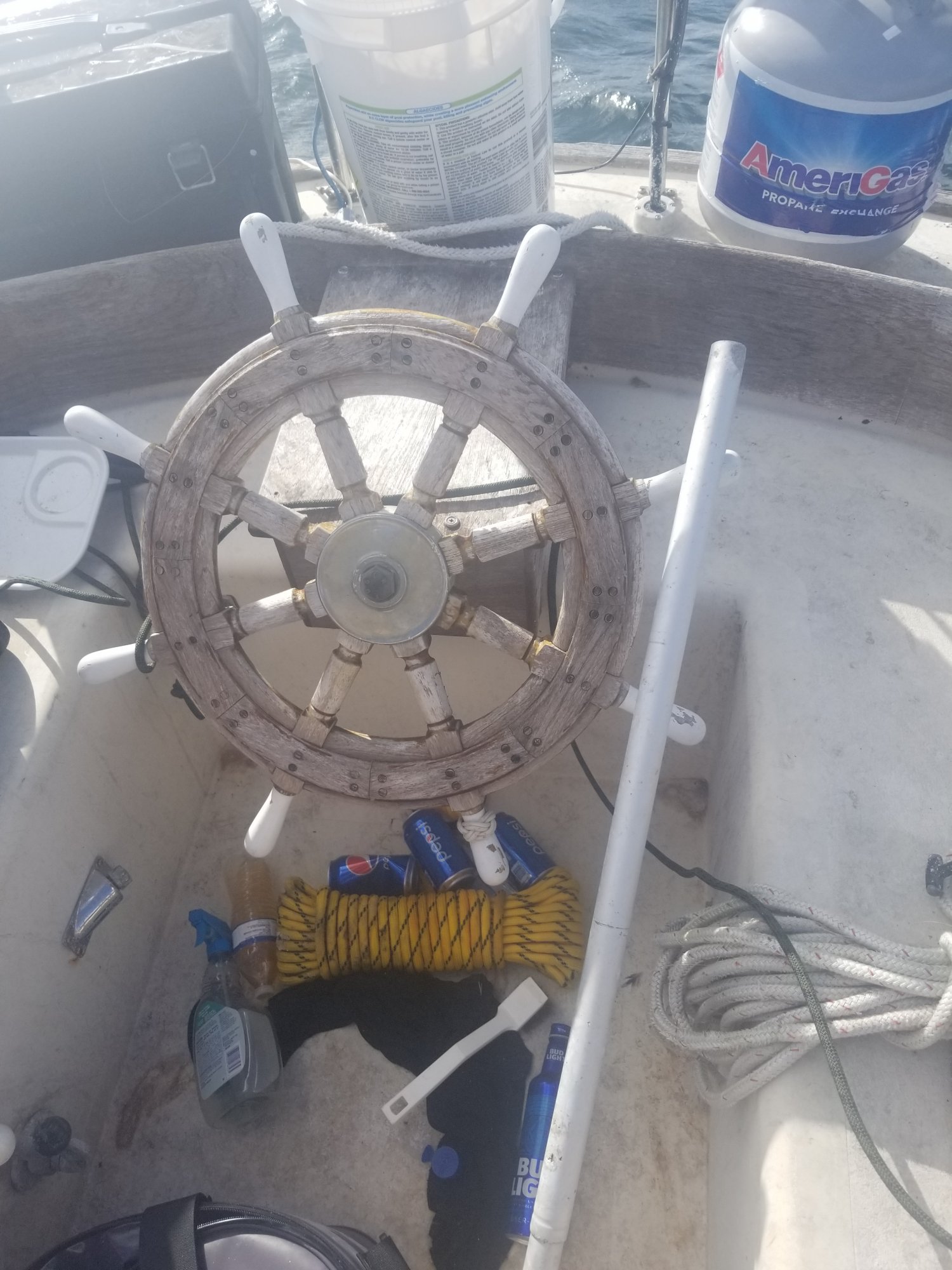

Ok so I'd like advice guys. And this is not. Today thing but a wait until after repairs are made.
I want to relocate the steering. For easier and more comfortable steering. The 1st pic shows where it is and the second shows where I'd like it to be. Since there is already a stand there I figure it shouldn't be to hard. Even if I pay someone to do it

I think it will be much more difficult to do than you expect. The mechanism you will find inside that box behind your wheel is not as simple as just moving the steering wheel.
dj
I agree. But feel it must be done for better visibility as well as safety under power.

I would get the boat motoring and sailing before I moved the wheel. I think that will be a fairly involved move if done properly. If you have to pay for others to do it, I don't think it will be cheap. You may find that it's a fine location where it is. I would be more inclined to get that other stuff out of the companionway. The current wheel location seems to leave the cockpit fairly open.
I used my boat for about 2 years before I started changing anything significant. Took that long to get a feel for what needed changing.
But, your boat, your choice.
Thank you. And I agree. It is something I want done only after the repairs. But it is not a easy job. So I figure get advice now and save it for later rather then trying to do the job and gather info at the same time
Jan 5, 2017
2,483
It would be a lot easier to move if you change from mechanical to hydraulic steering.

Pop the cover off and shoot a picture of the steering setup. Hard to give meaningful input without knowing how it's built.
Linkage/fab-wise this is probably spot on. But, if I went hydraulic, I'd want a readily available tiller backup.
For sure. My CT37 had an arrangement like that and changed to hydraulic. A cover plate gave access to the rudder post for a tiller.
I will get pics of it tomorrow.
I do agree with the need for a back up. I think this boat has one. But I will double check tomorrow.

The location and design is certainly old school. It is a sit beside and steer idea. From the side location you should have reasonable sight lines while sailing.
Issue with the new location is that the binnacle will be right in front of the engine dashboard. Hard to read the gauges while standing at the helm. Or do you thing you’ll be moving them as well.
You’ll want to consider your moving about the cockpit to manage the sails. I’m guessing, because you really need to see the physical space and consider crew movement, but it appears the new steering position will conflict with managing the sails tacking.
The hydraulic suggestion is a good one by Michael.
I need to replace Tue gauges anyway as plastic faces are unreadable. So a relocation is planed as is relocation of the compass mount location
