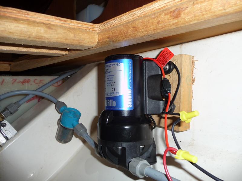

While my boat is at the dealer's, this week, to address some warranty issues, I have been reading through the Hunter's Owner Manual. Three things I want to ask other owners about before I go to pick up my boat tomorrow.
1. The owner's manual Chapter 9 page 7 (9.7) "Fresh Water Layout" shows a water filter just before the water pump. Looks like a good idea but I don't believe I have one. Did a filter come fitted or have you installed one since or are you thinking of installing one?

1. filter would be a sediment filter, if there is one, stainless steel screen, attached to the water pump, not a separate filter.

Fresh Water Strainer
Here is the fresh water straineer in my old 34.. the little blue topped mesh strainer.. It keeps the larger rodents and reptiles and rocks out of the pump.. but I wouldn't call it a filter.. If ya have one, it is probably very similar.

1. a Fresh Water Pump Inlet Strainer not a filter is plumbed at the water pump on the inlet side. Installint and inline charcoal filter will now go on the to do list. Also plan on using a sediment (5 or 10 micron) filter with standard garden hose connections for filling the water tank at dockside in the future.;
