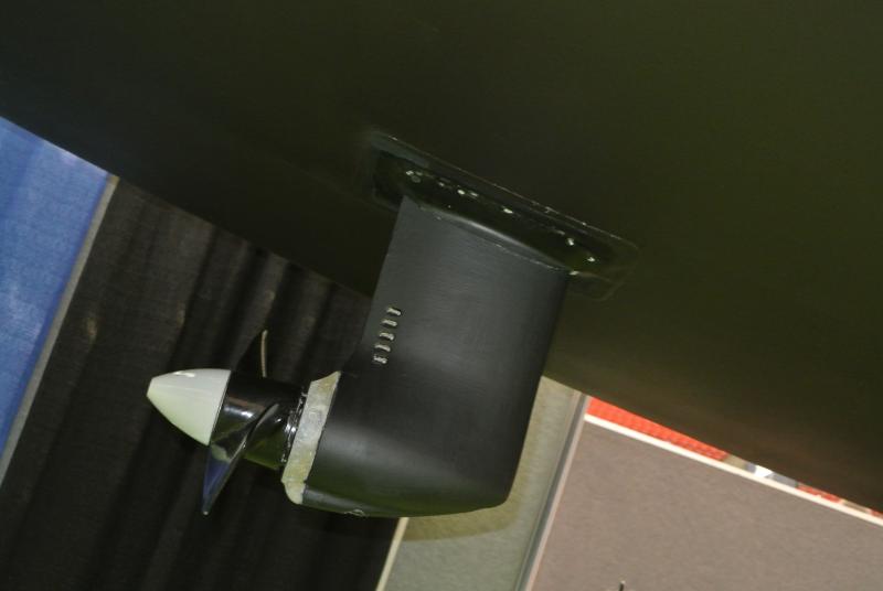

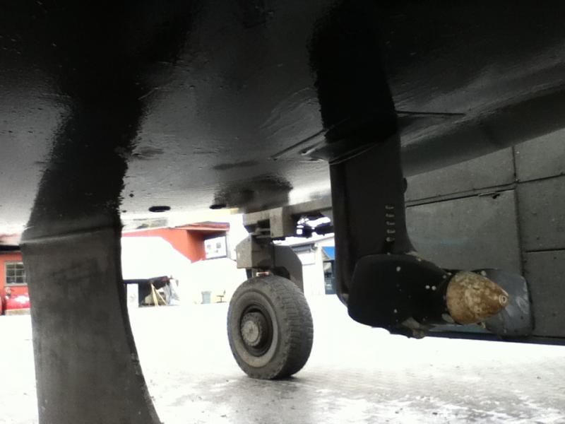

From the looks of your photos, the stress crack(??) could be: the iron keel itself, epoxy 5 coat barrier, gel coat or bottom paint. I am betting one of the middle 2 although it is unlikely that there is gel coat over the epoxy. Once the various layers come off during inspection the culprit will be known.
As far as the saildrive fairing boot goes, it just looks like it has come loose from the hull for some reason. I believe it is secured to the hull with adhesive. There are many posts on other boat forums indicating this is quite common. I think this is a quick fix where preparation is the key to allow the adhesive to adhere to both the hull and rubber boot. I would give it a good check to make sure it has not been damage or deformed while it has been flopping around.
As an aside, do you have any sort of anti-fouling on the saildrive leg? I understand that the dealer applied 2 coats of Interlux Tri-Lux II on mine. There is better out there but that is about all that is available in Canada.
