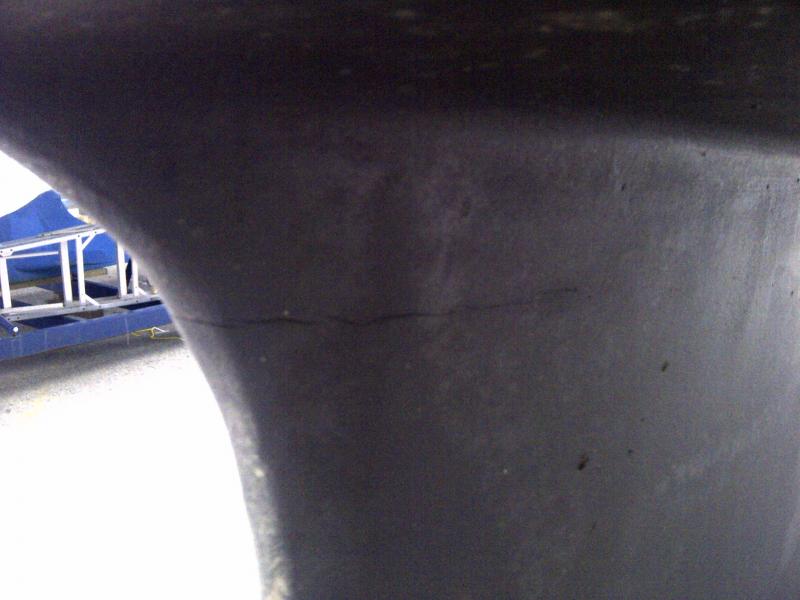

It's the dead of winter and new boat is sitting in it's cradle on the hard. I went to look at her yesterday and noticed crack forming where the cast iron keel is connected to the fiberglass hull. The crack starts at right at the front edge and long both sides of the keel...currently about 4 inches horizontal cracks. Is this normal, what needs to be done?

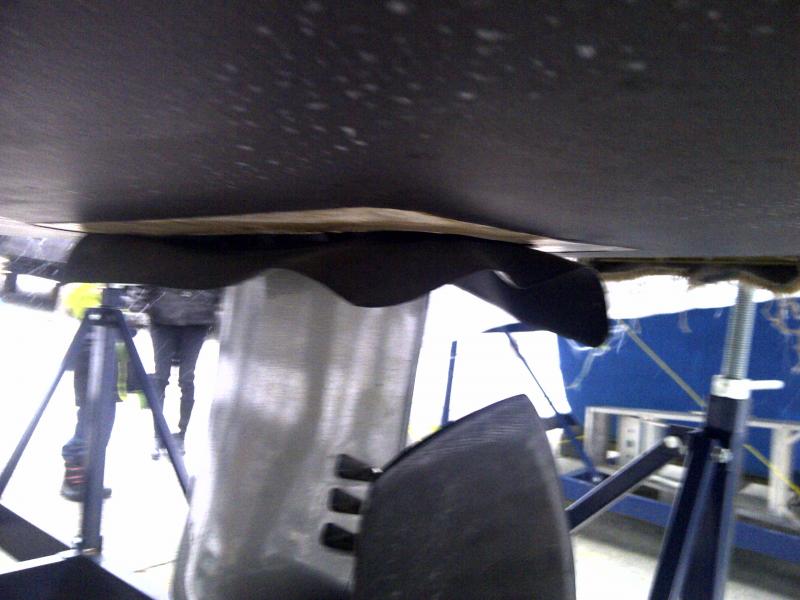

Another issue. My boat is equipped with a sail drive. There is a rubber membrane around the opening of the hull where the end of the drive leg comes out. The membrane has come loose from the hull. Is this going to be an annual repair?

Yikes. Sounds like there is a problem but you are looking for someone with more knowledge and experience then I, particularly on a new boat.
My boat was hauled last Wednesday by the dealer in preparation for it to be shown at the local boat show. Unfortunately, I was not there to witness it. They were to paint the bottom and sail drive and change the sail drive oil. I would assume that if the service manager noted anything amiss I would have known by now. I will be viewing our boat out of the water a week from today, so I will have an opportunity to have a look.
From what you wrote I should think that both issues would be covered under warranty the Hunter (for the keel) and ZF (for the sail drive).
How has your dealer been supporting you?

The dealer has been quite good. They noticed the rubber membrane issues when the boat was hauled and they mentioned that this will be address before launch.
Also, I had an opportunity to meet and talk with Greg Emerson (Director of Sales - Marlow-Hunter) at the Toronto boat show last month. He had asked me to email him a list of concerns and questions I had. I had a good feeling everything will be resolved.
At the time I spoke to Greg, I did not know about the keel issue, so I have emailed him some picture this past weekend. I'm looking forward to his reply. When the boat was hauled last fall, there were not signs of any cracks. A service tech from my dealer went around the boat with me.
