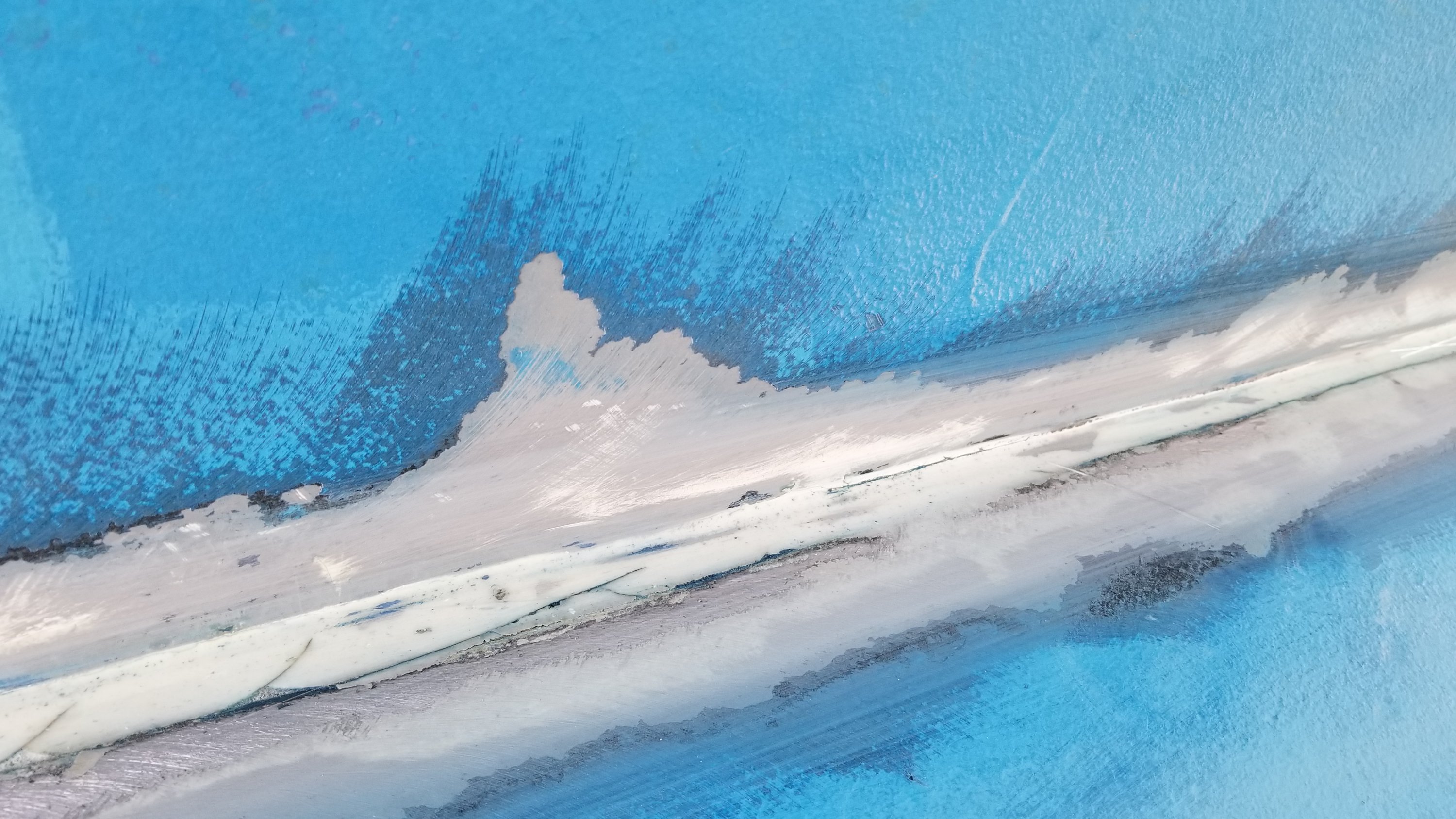

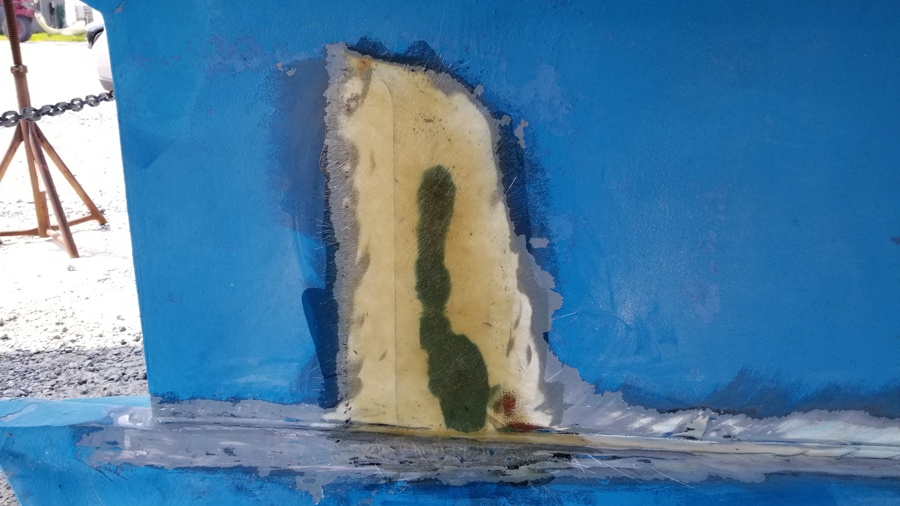

Update. Had a glass guy grind down the cracked material. Turns out it was a lot of fairing material. They ground it out and put some other "better" material. Not sure what it is but it was green and then they glassed over it. You can see in the pic. Also the joint to the lead bulb had cracked fairing so they re putting something more flexible to seal that section.

Thanks for the update. I will be looking closely at my keep this coming week and I hope to rule out any seepage at the keel stub to lead bulb area. Doyou have any idea what caused the joint to the lead bulb to crack? Any hard groundings?

I bought the boat in 2016 and last season was my first in. My guess is it's been this way for a while at the bulb joint area. The part that cracked looks to be a poor fairing job perhaps many years ago. When we took the piece that cracked off there was perfect gelcoat underneath that was glass smooth. Not sure how they got that compound to adhere as it was so smooth, but I'm sure it separated and a small crack let water in between then it froze and cracked outward. I don't think she was ever grounded and the bulb looks perfect, probably more from the flexing is my guess. That fairing material theytused is very brittle.

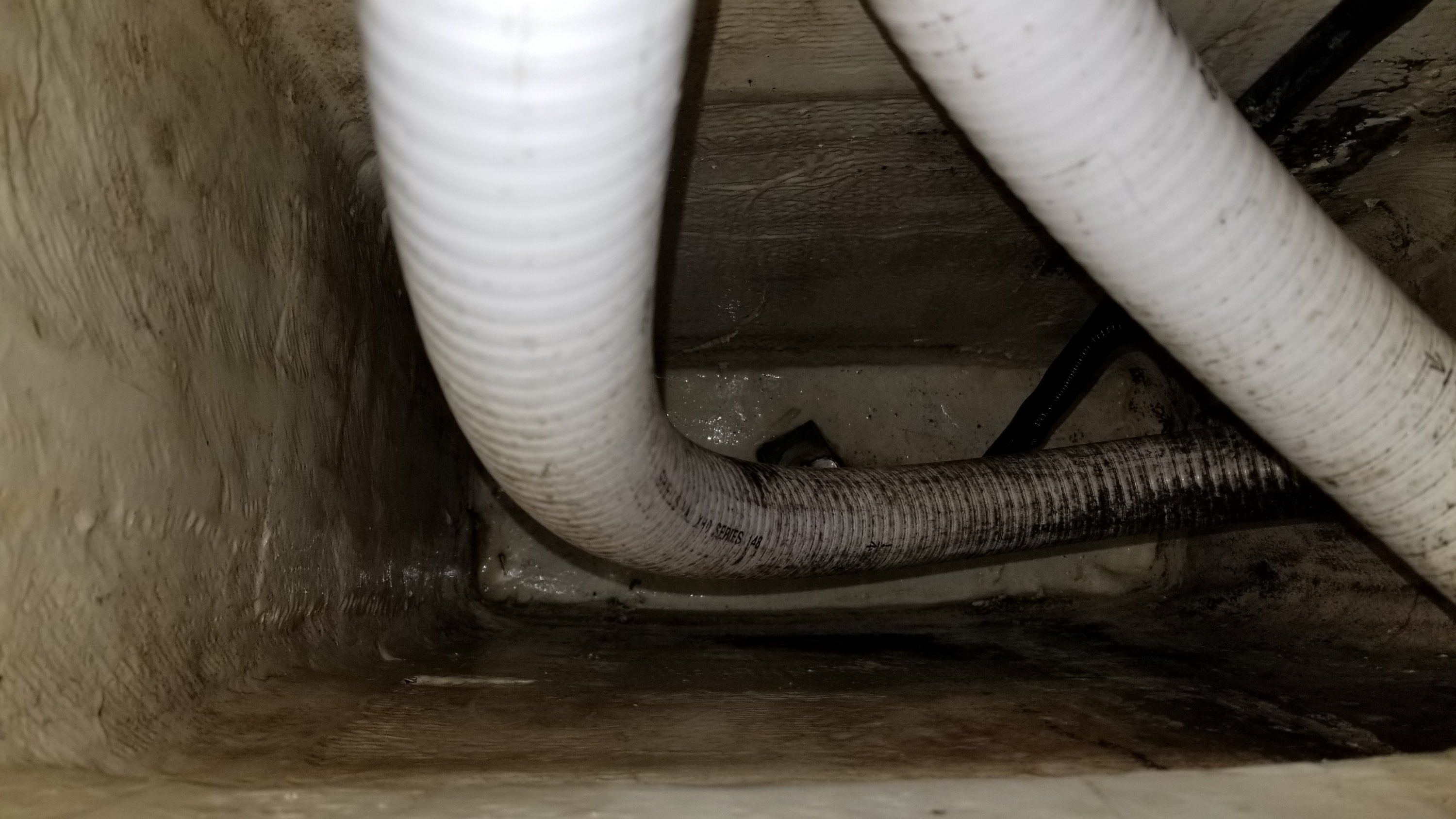

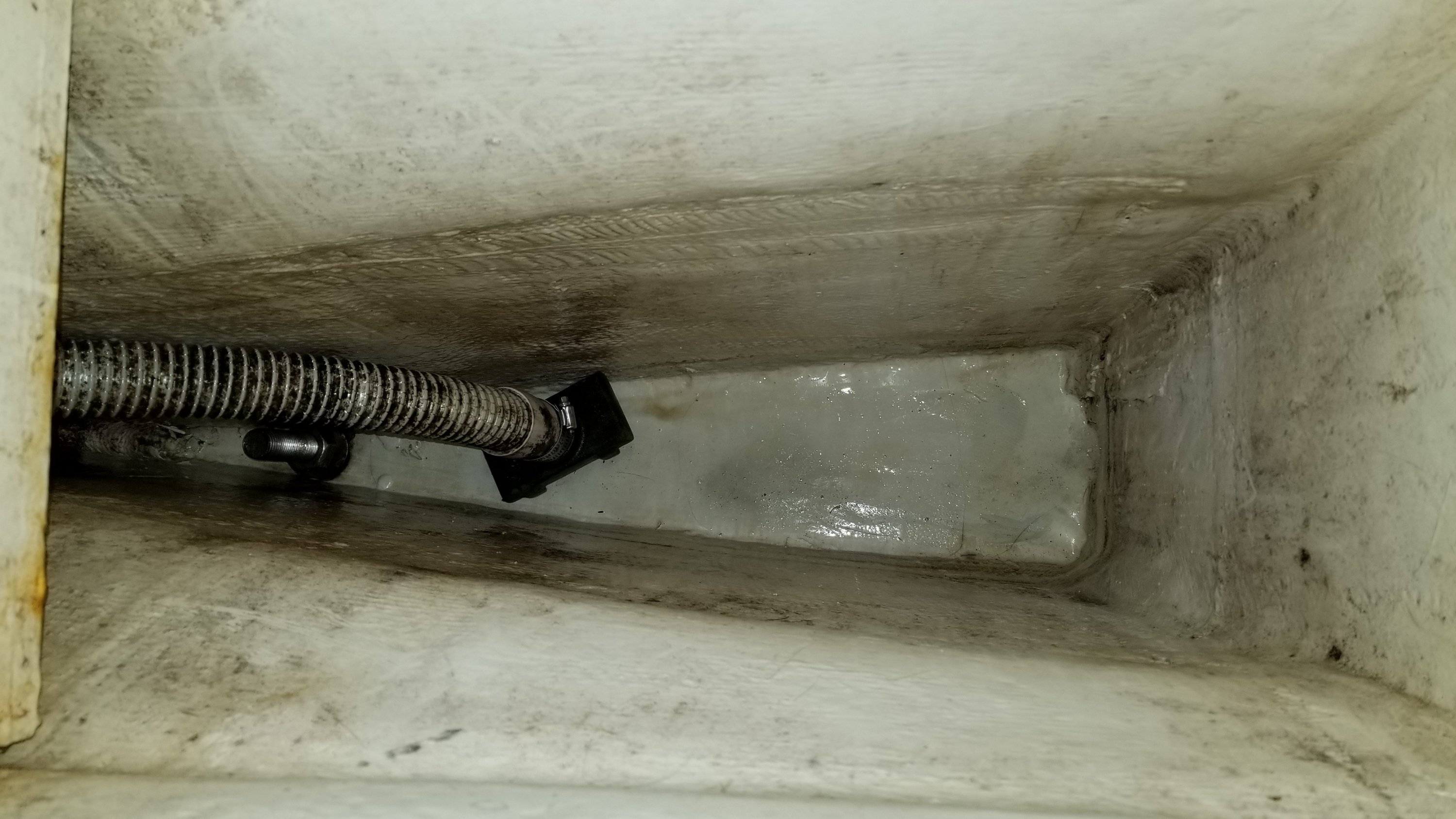

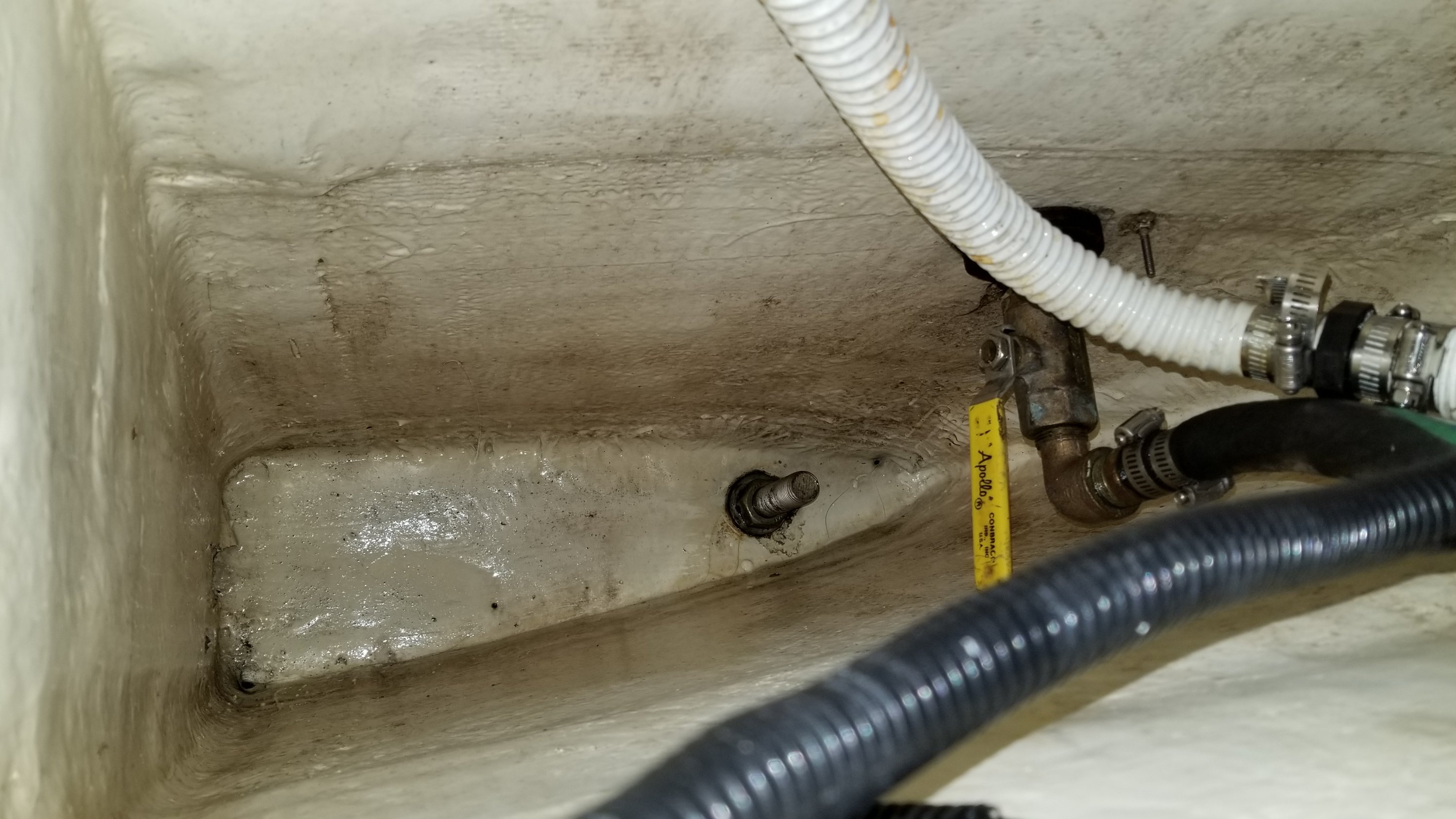

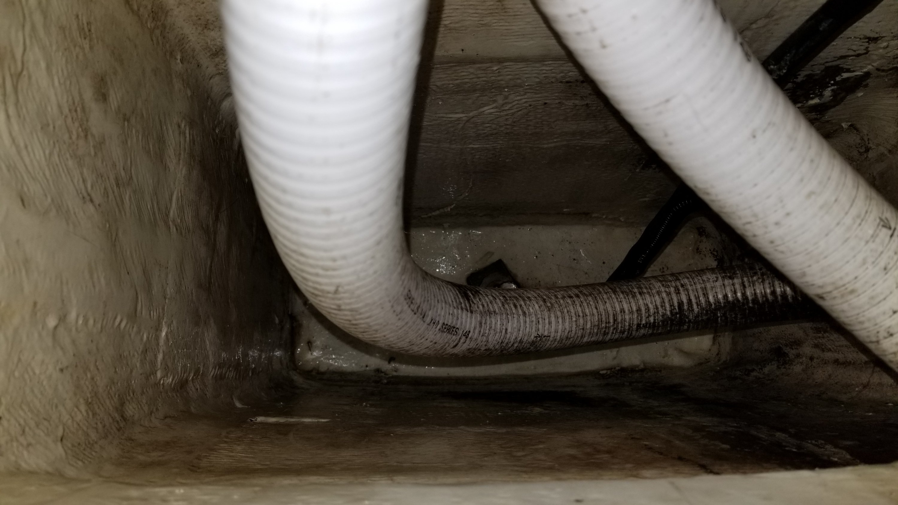

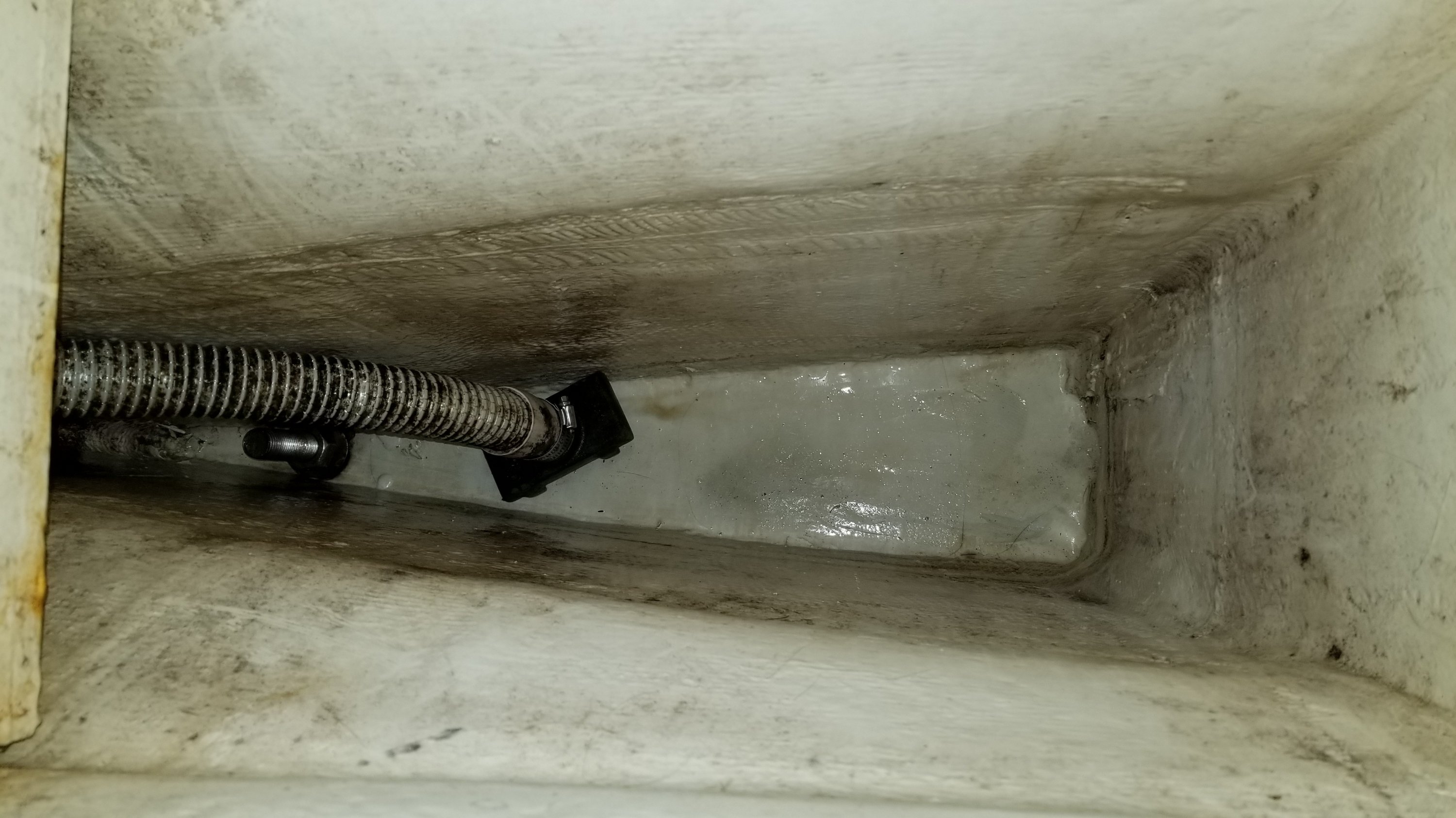

Ultra deep bilge of a 1997 Hunter 40.5. PITA to keep clean as it's so hard to reach especially the center compartment.
Amazing pictures. I have never seen the three bilges like this. And only now I can see it's three bolts that hold the keel.
