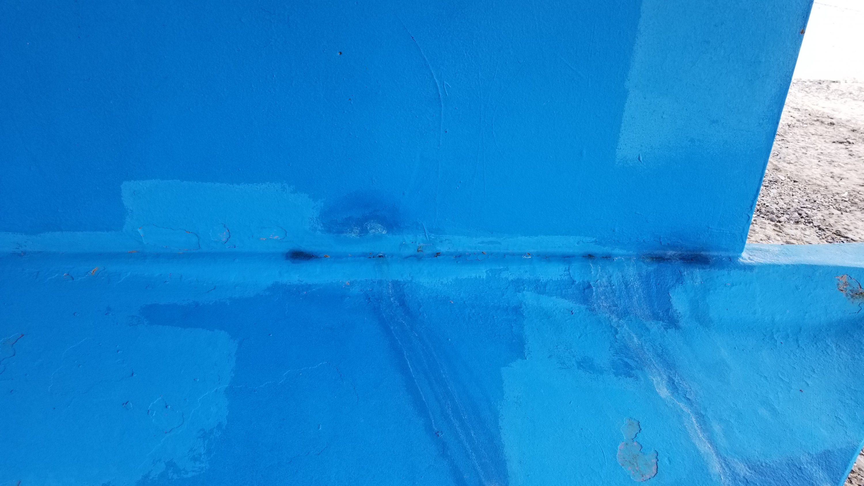

Hi All,

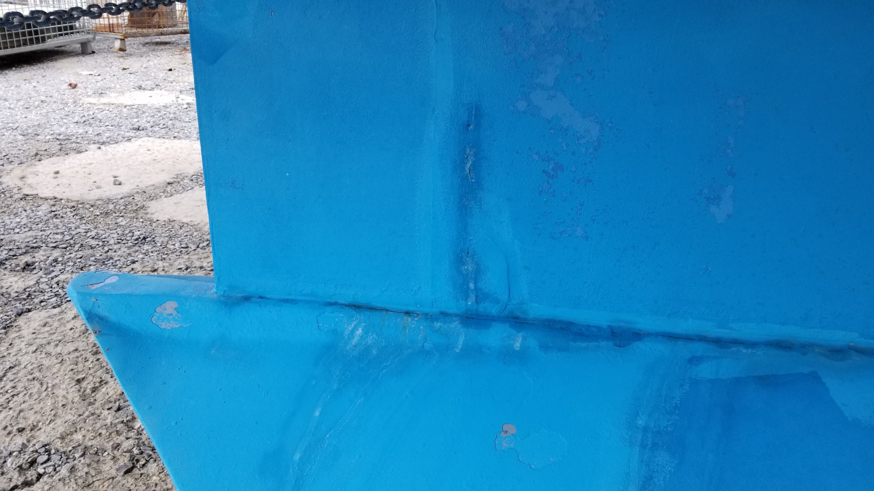

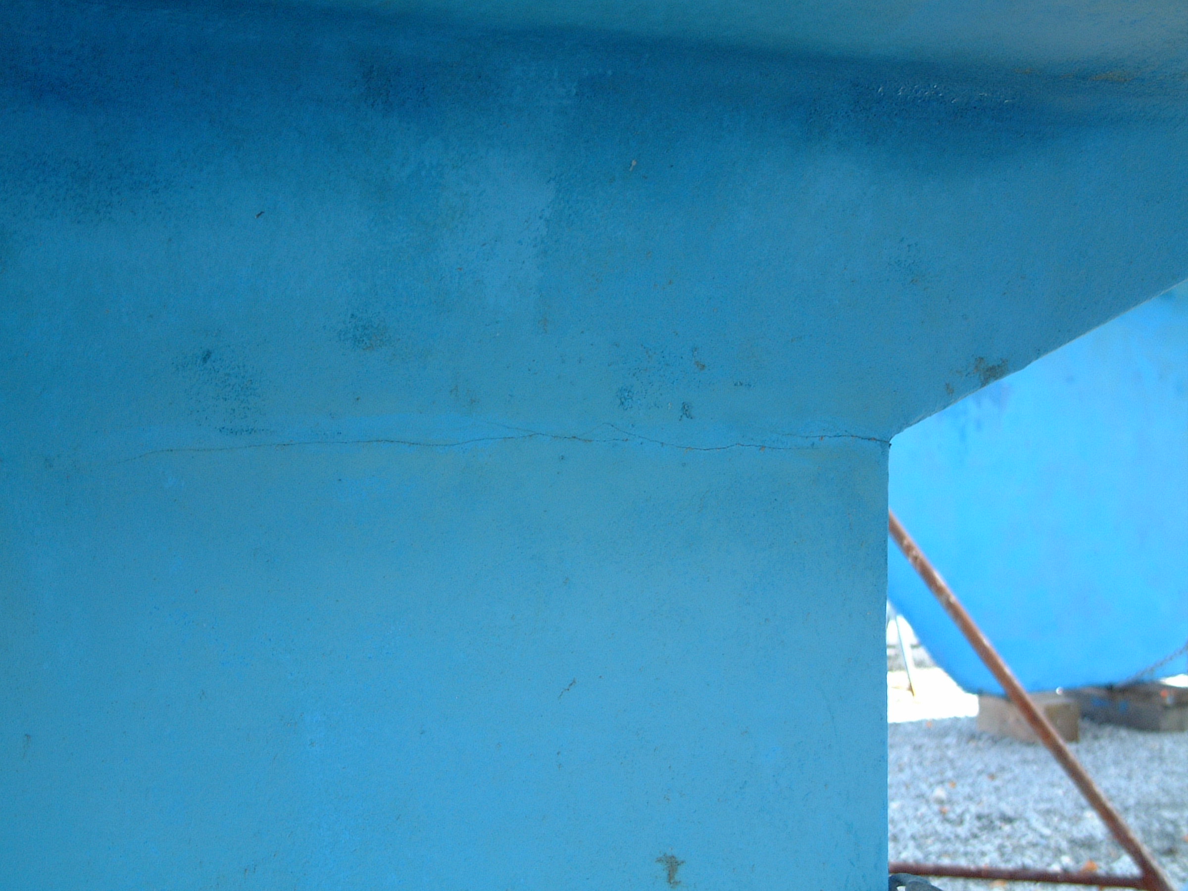

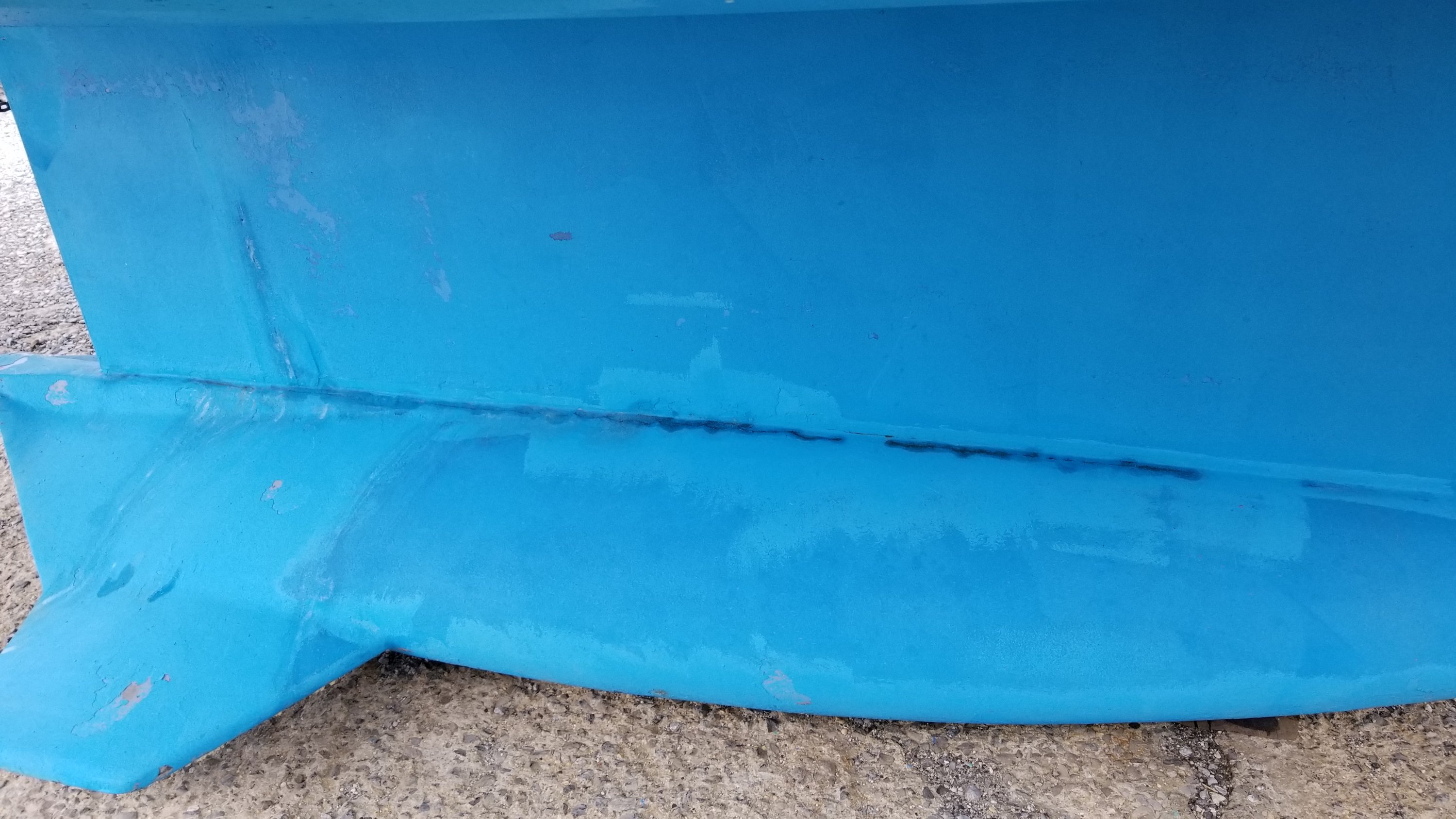

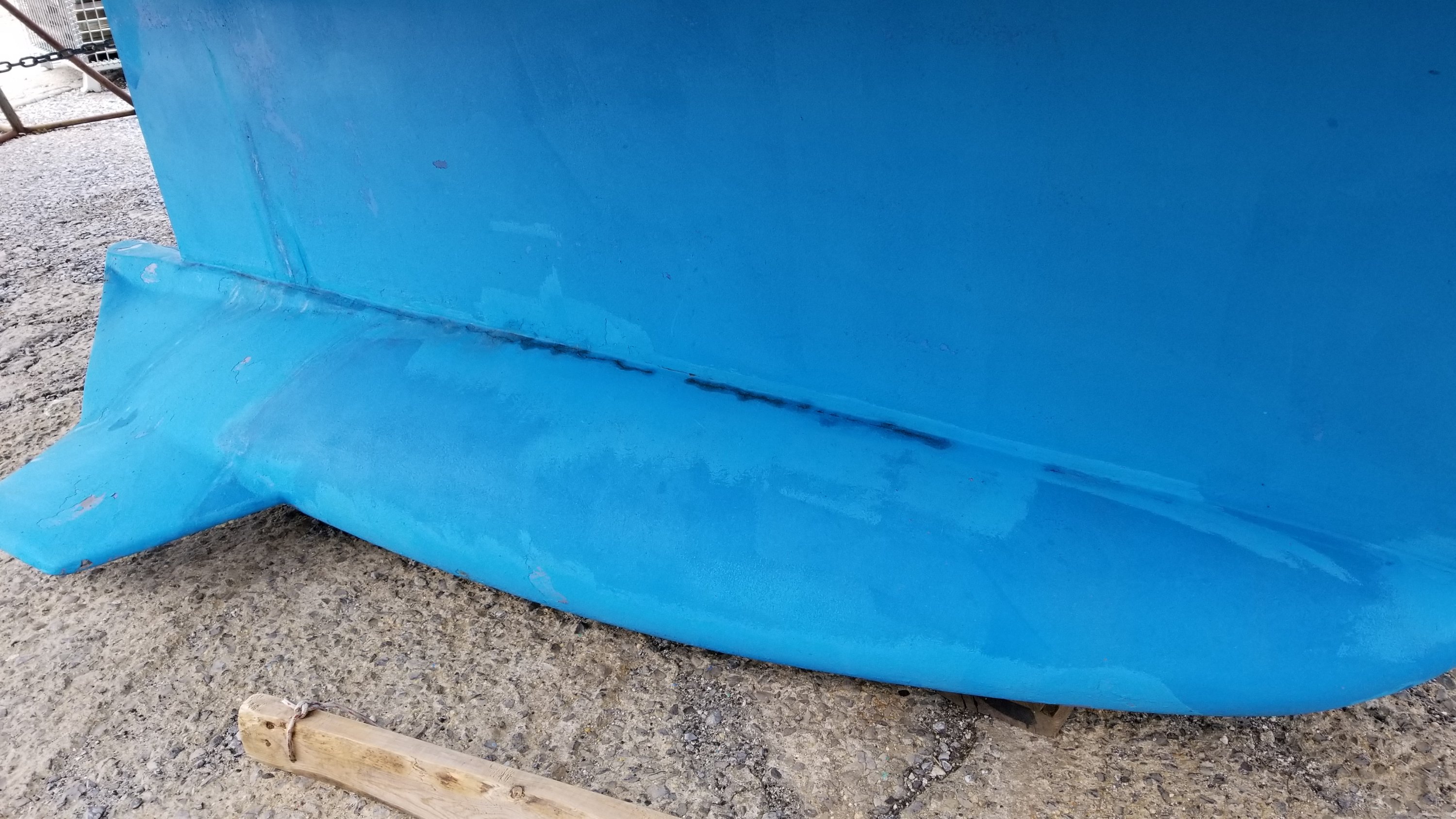

My keel on my 1997 40.5 has a moisture line where the stub meets the bulb on the bottom. I ground it out and it looks like the fairing has cracked most likely from flexing. I want to get thoughts from other 40.5 owners as I think it's a common issue that just needs to be recaulked or faired again.

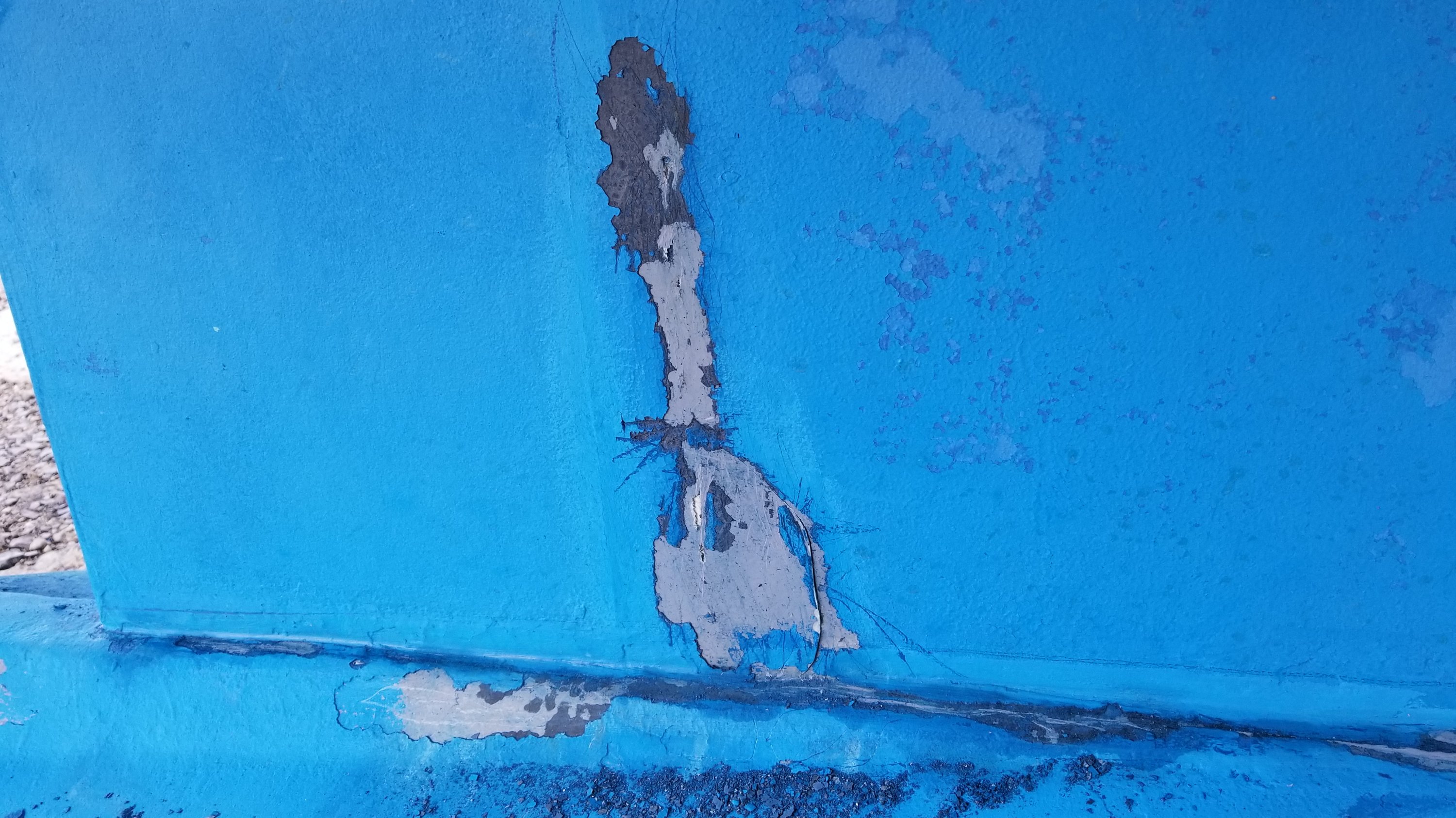

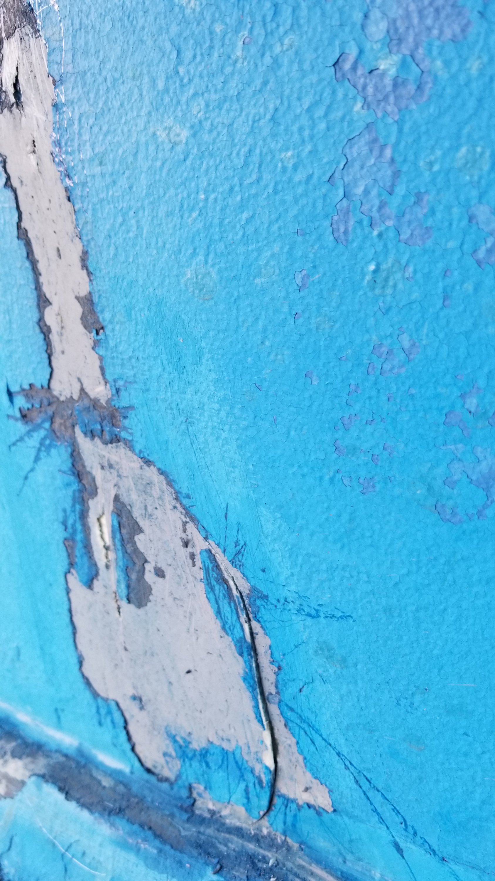

Also there is a section of delam that I am getting repaired. Looks like this happennd in the bad winter we had as it was not there last year. Pics attached.
Sep 25, 2008
7,751
Alden 50 Sarasota, Florida
We used to have a 40.5. As I recall, the aft portion of the stub is hollow and there should be a drain hole in it near the bulb which, if plugged with paint, won't drain that portion. From the pictures, it's difficult to discern but the damage certainly looks like trapped water froze in there.

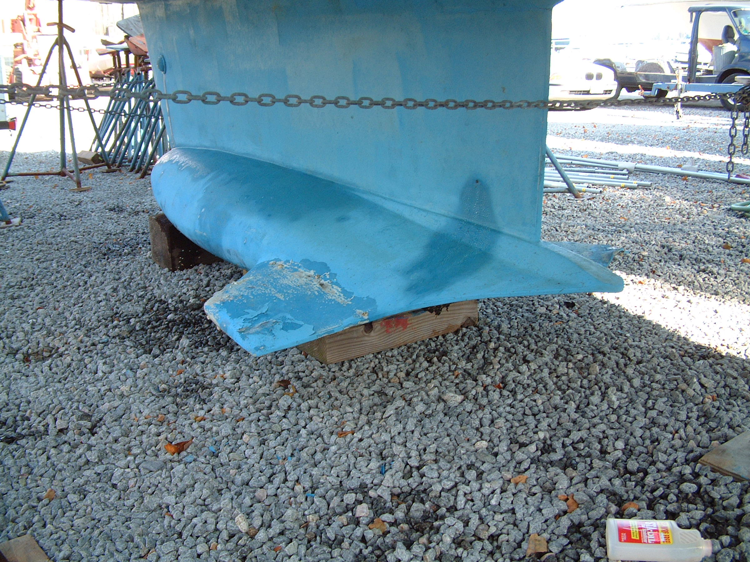

I also have a 1997 h40.5 but I have not observed any evidence on the outside at the stub-keel-joint. Do you also have weeping inside the stub? The aft part of the stub is hollow as Don claims and there is a weep hole that allows any water inside to drain.
Looking back through my pictures, I think there are drain holes on port & stbd at the bottom and a vent hole on the stbd top of the stub. I can't see a vent hole on the port side top of the stub. See attached. You definitely want to make sure these are not filled with paint so that trapped water does not freeze and damage the stub.

I don't think it's weeping inside. I think the long section is cracked fairing at the bottom that accumulated water then froze / thawed. I didn't see weep holes so I will have to look and see if I can find for the aft section. I have a glass guy looking at it this weekend and will hopefully get a better picture when we expose it. If they were clogged it would make sense as to why the delam cracked in that aft section.
