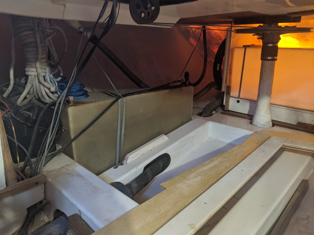

Aug 10, 2020
29
Hunter 34 Austin, TX
"molded well" might be an overstatement (at least for my H34, MY 84). The tank basically sits between the ribs of the inner hull mold. Sure it will hold some spilled fuel but if that thing ever cracks I'll have diesel in the bildge.
337
Hunter 34 Herrington South, MD
THANKS for the picture. I wasn't sure what a "molded well" that could hold spills actually meant. I have the same set up.
