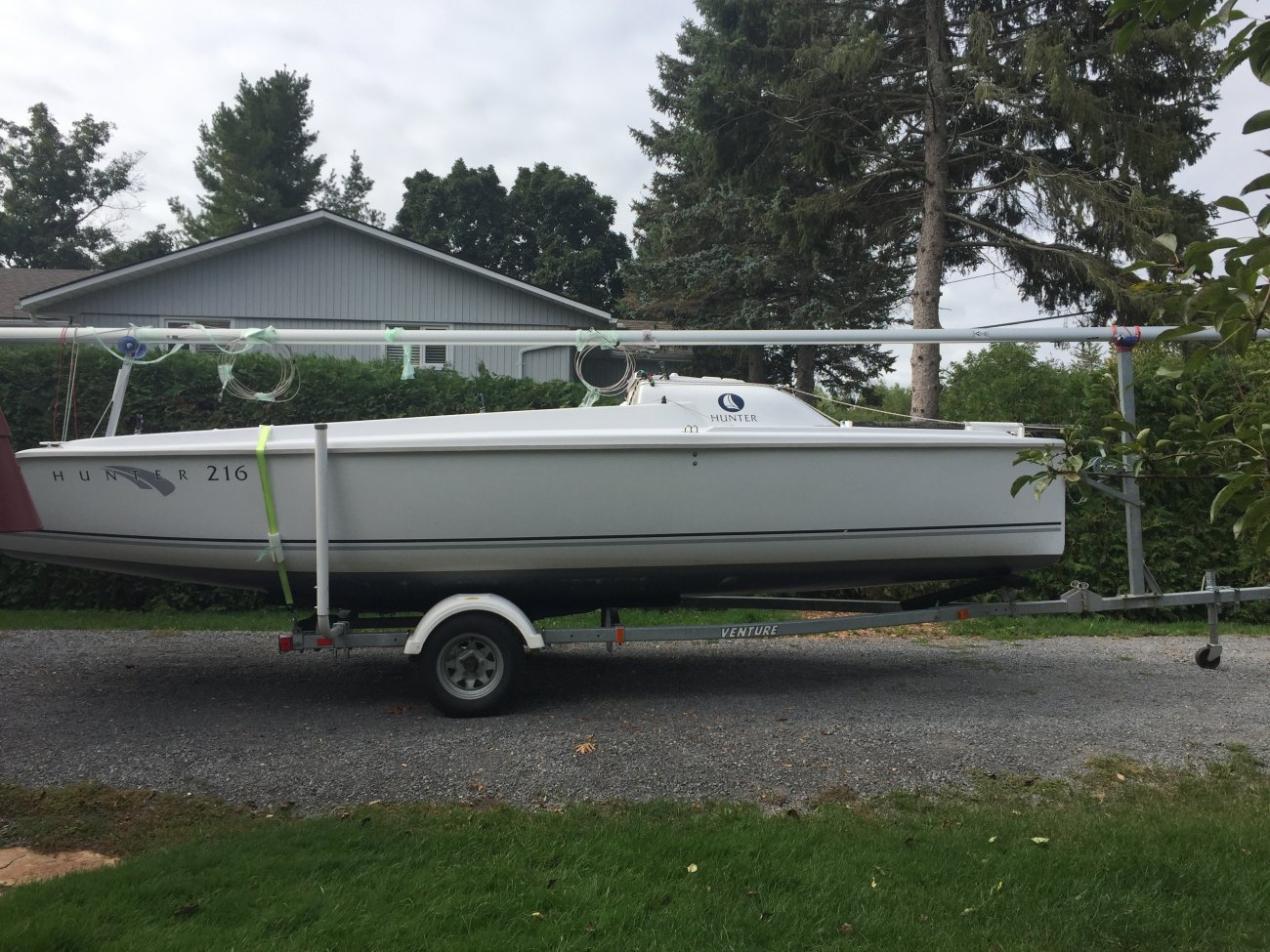

New Hunter 216 owner. I recently purchased a 2008 216, so probably one of the last produced. Originally sold to a non-sailor in Michigan. Sailed only ten or fewer times. Hull in great shape, however the rigging a cordage was a disaster. Not sure how it could have been safely sailed.
First sail last weekend on a 550 acre lake east of Lake Geneva Wisconsin. Replacing/upgrading all the cordage and much of the blocks and tackle and may update much of the controls. Experience from racing Lightnings, Flying Scots, and Buccaneers on Lake Michigan the last 17 years, so the Hunter is a new experience.
