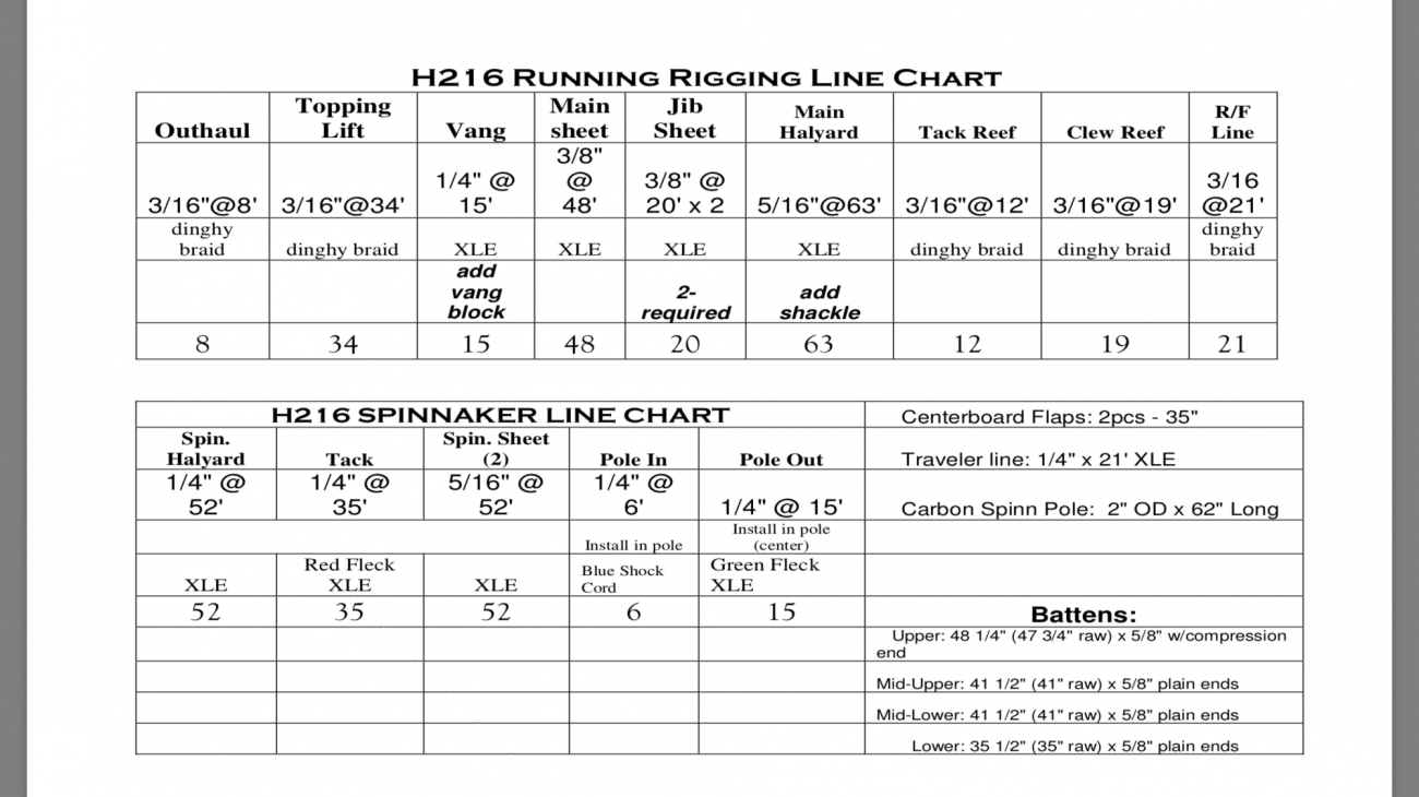

Is there a list of running rigging sizes and lengths of line required for Main sheet and halyards?

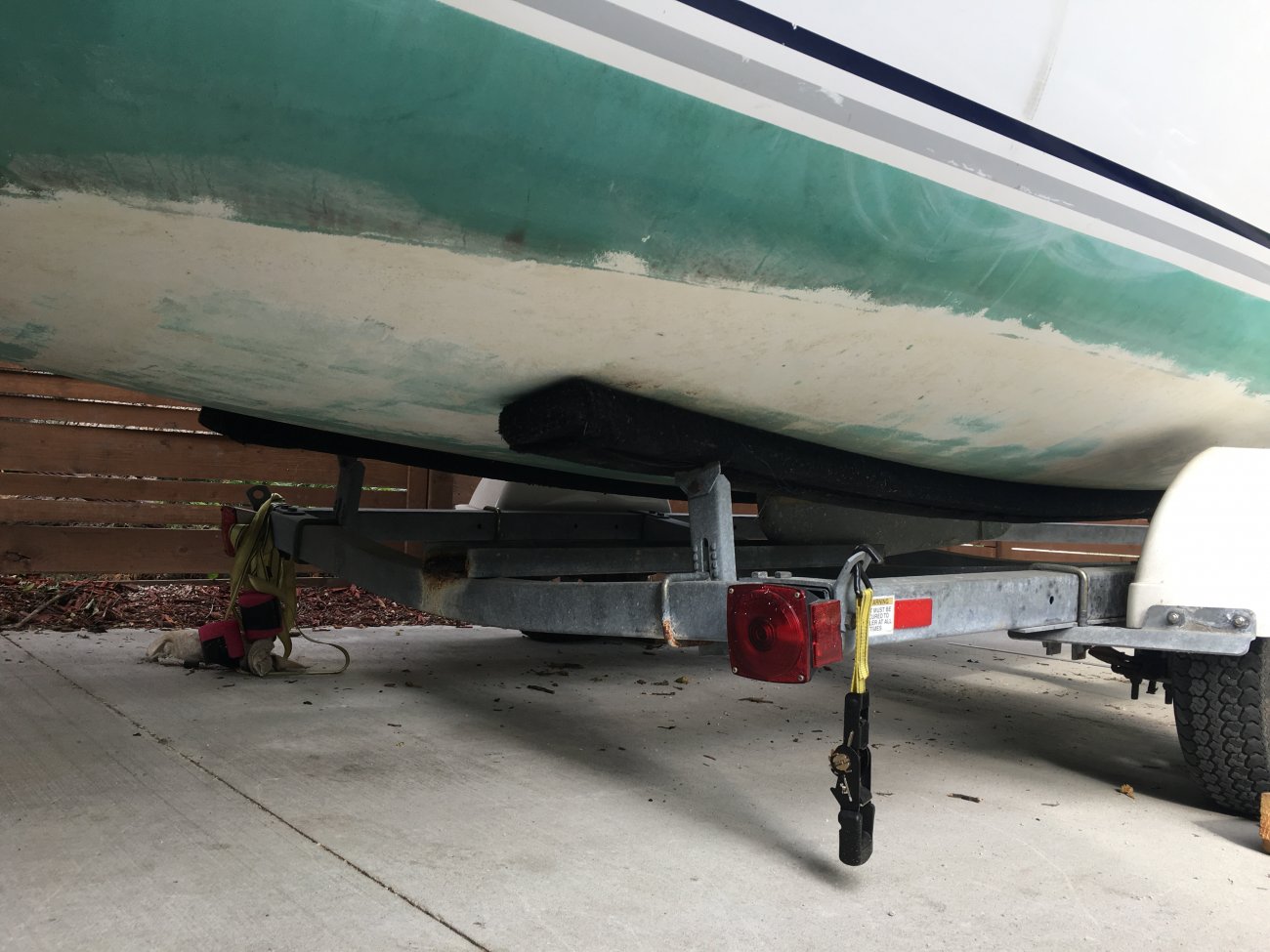

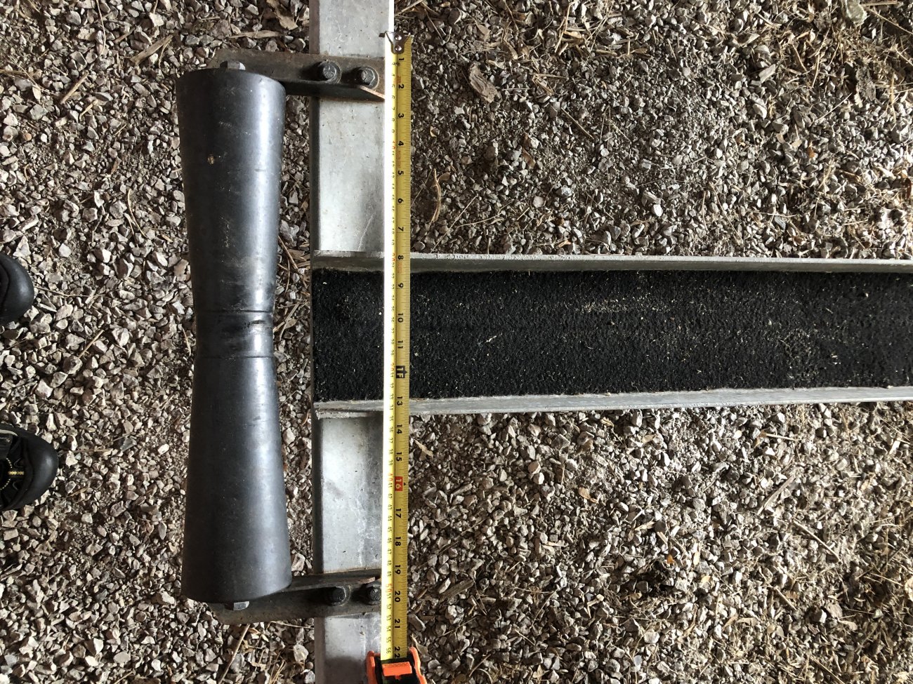

Yes there is a keel tray on the trailer and the keel is resting on it. This is what is intended for storage and travel, it takes all the stress off the keel frame and boat bottom. Because how my bunks are setup, even with the sailtec in the full retracted position the cable doesn't take any load. This will cause the keel to slide on the tray during launch, but I guess if I go deep enough the boat will float off regardless. I will send some pictures later today.
Sep 22, 2018
1,869
Hunter 216 Kingston
Glenn

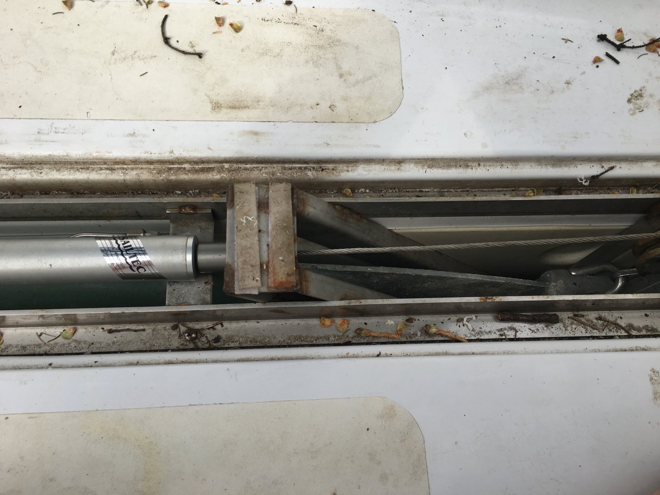

I intend to document this a little better but for now:

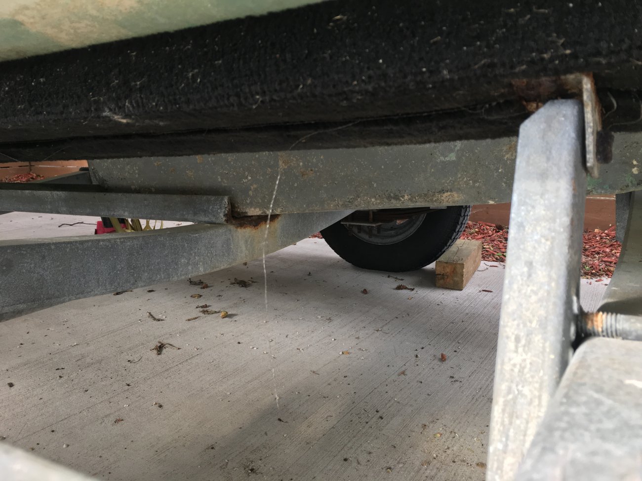

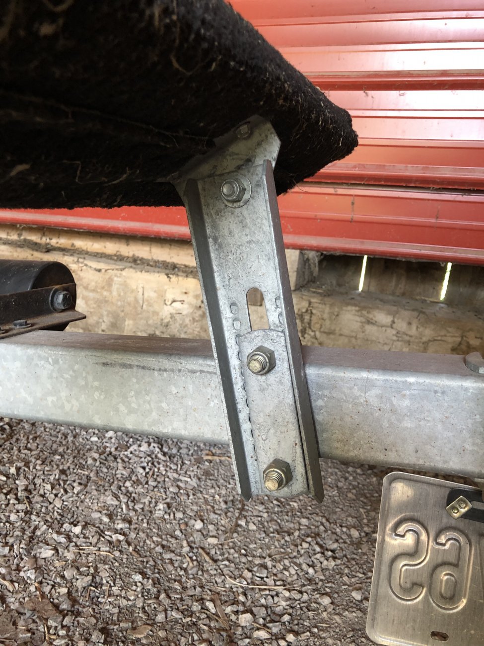

My trailer is made by Venture so if yours is different these dimensions may be off:
The distance between the u bolts forward is 38 - 1/2", Rear is 42", u bolt to outside of frame forward is 13" and rear 11"
The bunks are 2X6 carpeted and if I flip them parallel to the road surface the vertical distance between trailer frame and bottom of the bunk is about 4 1/2 - 5 " at the front and 6 1/2 - 7" at the rear.

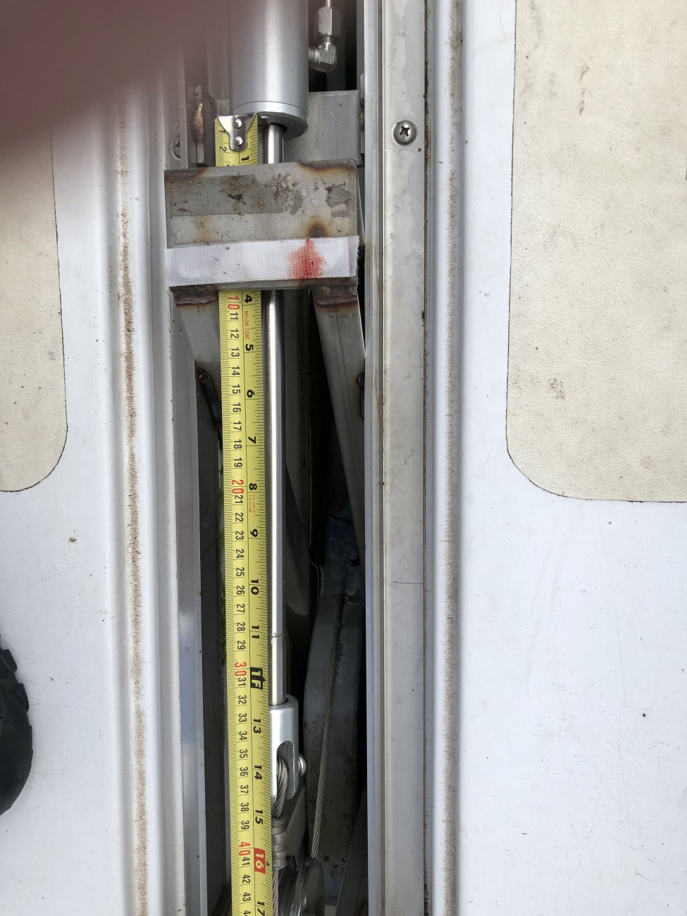

The length of the exposed ram (measured from end of cylinder to base of fitting on end of ram) when all the way up is 1 5/8" and all the way down is 13"
EDIT: When board is all the way up there is 8 1/2" from the "trailing" edge of the end tip of the foil to the top of the frame. (aft most point in the slot).
A couple of photos for reference.

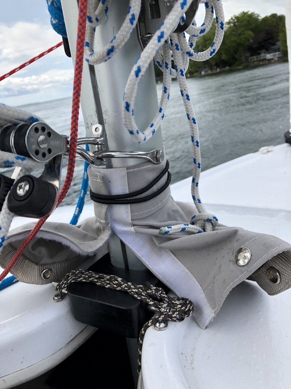

I’m great at spending other people’s $$$ so here is a pic of two items you might want to consider getting from the SBO store.
The canvas helps keep out the bulk of rainwater. Note I also siliconed the mast slot full to keep water running down through there. It’s not a perfect seal but better than having it open.
The black plastic mast “wedge” really stiffens up the mast.
