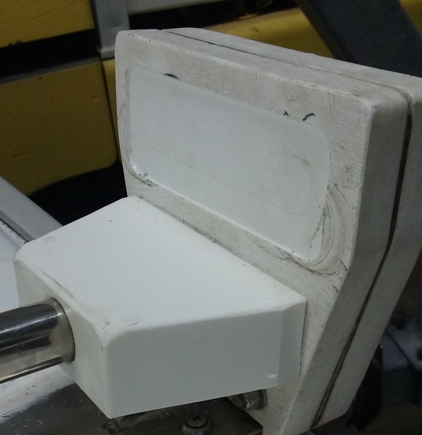

One interesting issue i have with those plastic mounts is i cant get a good grip on the clamps. When i turn the prop 90 degrees the motor tries to free itself from the mount.

I agree about the plastic on the motor mount being a little too slick for comfort. If you look closely at the picture of my finished mount, you might be able to see the pocket that I milled into the plastic. The way it is now, the motor can only slide sideways about 1/4" before it hits a hard stop. In order for that motor to come off, a piece of HDPE needs to actually break or the mounting clamps on the motor need to loosen by more than a full revolution. I still use a safety rope though. I'm a belt+suspenders kind of guy when it comes to preventing motor loss. I've rebuilt enough salt logged outboards for one lifetime.

Yeah, thats the ticket, cut a seat for the clamp. Liking the leash idea. It came free once on me and once on my son as he attached it and was docking pilot. Thing turns on ya like a buddy bitten by a zombie beserker.
Told my son id rathet tbe clamp break from overtighting while its sitting on a trailer than lose tbe motor while fighting wind next to a million dollar catamaran.

The close-up picture below shows the pocket that I milled into my motor mount.

I might try that milling idea. The block cost $115 so its a measure twice, cut once deal. Then buy a new one if i get a gas engine with a different mount.

I milled my pocket a little tall & a little wide. The pocket has room to swap between several different motors. It will fit a Honda 2.3, an Evenrude (Tohatsu) 3.5 & a Minn Kota trolling motor. It will probably fit most other motors, that are an appropriate size for the boat, with no other changes.
I should be able to make another one of those blocks from scratch for you, if I have enough scrap material of the right thickness kicking around in the shop. Please let me know if your motor mount looks like mine or not.

The plastic plates on mine are each 3/4" thick. They are 6-1/8" wide by 6-1/8" high. The taper starts 2-1/8" down from the top. The bottom is 4" wide. For the pocket, you can figure 2" high by 5-1/4" wide by 1/8" deep, starting 1/2" down from the top edge.
