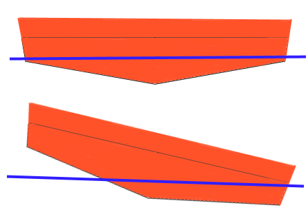

OK, so this is for everyone but Dave. ;^)
When about boat (in particular a flat bottomed boat like the 170) is sitting flat on the water is has max wetted surface area, and max parasitic drag. A large bottom area drawing 1-2 inches of water. But when a boat starts to heel, now the reserve buoyancy in the now-submerged bilge/hull provides the required displacement with more draft (4-6) inches, but in a much smaller area as the same number of square feet are providing buoyancy. See this pic of a 170, the entire port side of the bottom is out of the water, the buoyancy for displacement being provided by a much wetted smaller area on starboard. Other factors might effect the particular boats optimal ability, but this point is a universal truth.
Looks like this.

This is going to end up sounding like hunter didnt appy much science to the 170 and this would be a cool new thread.
If the hull was perfectly ellipsoidal at all angles of sail then the wetted area would be equal at all angles of heel. There is actually a patent for a hull of this design. The 170 is not perfectly ellipsoidal so it cannot have the same wetted area at all angles of heel. The bottom is in fact very flat and square past the centerboard and very triangular in the front. In any situation where the beam stretches the ellipsoid out the wetted surface must decrease as the hull on the opposite side is forced out of the water. Displacement must also not change, so the hull will go deeper, adding some new wetted surfaces. Extra credit, does the lwl get longer also affecting hull speed?
Hobie cats heel lifting the opposite hull out of water, reducing the wetted surface of one completely while sinking the other slightly.
Heres the rub. The more wedge like the hull shape, the more a center rudder comes out of the water and vectors the water flow along a suboptimal direction with increasing heel. Lots of pizza slices have a duel rudder so that as the hull leaves the water, another purpose built rudder can take its place. With a single centerboard heeling raises the draft and also causes the foil to fail its applied purpose. Think of dehedral wings on a plane. On planes the wings make a slight v shape upwards. More heel is like trying to take off from a runway while your wings are folding upwards. You have speed, you have great foil shape, but the lift is not not in the right direction.(its inwards versus up) Lots of pizza slices also have foils that are raised and lowered for each tack so that there is a purpose built lifting daggerboard.
So there it is. The 170 is pizza slice that has less wetted surface when heeled, but does not have the foiling appendages or centerboard weight needed for excessive heel. It sails faster with extreme heel but at the expense of control. Loss of control includes rounding up as well as no rudder control and slipping. Downwind with centerboard up, heeled some, you're gonna fly.
The beam was made wide to fit your wife and kids. Hunter stopped the science there.

Jack, thank you for the picture. I was wondering how much freeboard was normal on that boat. Now I have a reference. In addition to that, I too though that Dave's statement about the way wetted surface changes with heel was a typo when I first read it. Thank you for checking on that.
