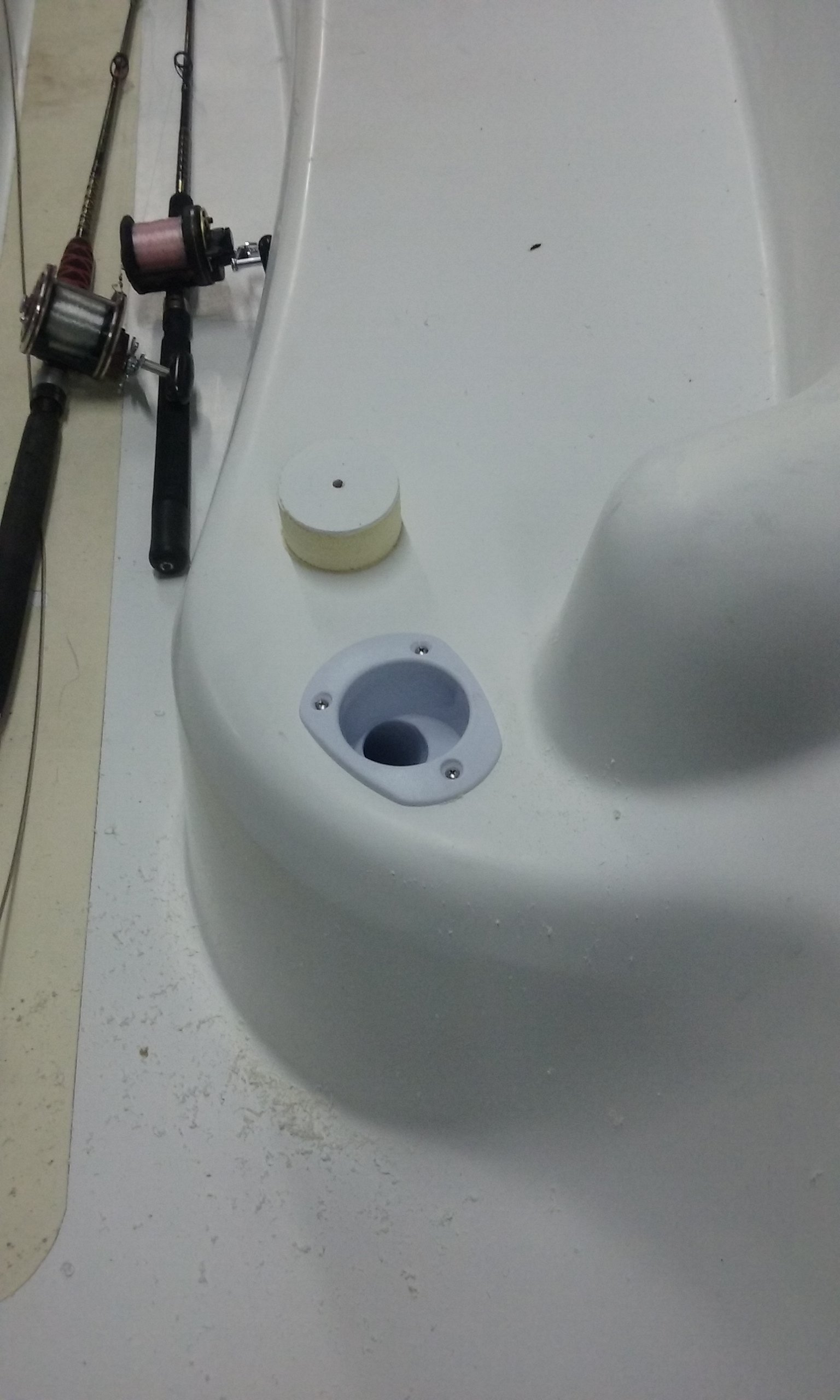

Dave,
If you are still looking at this thread, I have a question that probably only you can answer.
I'm thinking of putting a couple of combination cup/rod holders in the aft portion of the seats in the 170. This would involve punching some holes in the top side of the bench seats with a hole saw. The problem is, I don't know what materials are in there nor how the structure is set up. I was able to install the same cup/rod holders successfully on my 212, but in that boat, I had access to the under side of the seats from inside the cabin, so I knew what I was cutting into & I knew where things were located. On the 170, I would be flying blind with the hole saw if I went at it today & that is not a situation that I want to be in. Any information that you can give me on how the 170 is put together, would be greatly appreciated.
Thanks,
Jim
10,497
-na -NA Anywhere USA
Same process as the 212. If using a hole saw only fine and I mean very fine blade at a slow and I mean slow speed to avoid cracking and overheating of material. Otherwise you could crack the material
Likes: JimInPB
Aug 22, 2017
1,609
Hunter 26.5 West Palm Beach
It was just like you said Dave. The foam was about 1/4" thicker & the backing glass was slightly heavier compared to the 212, but other than that, the material & construction seemed to be exactly identical.
My installation was a success.
Thank you.

Coool AF.
That core belongs in a museum. If you still have it suggest a closeup be added to the hunter 170 download page or you add this project to the 170 customization page.
It would be nice to add duel water tight cabinets undet both seats by the centerboard, or one deep one on floor of cuddy. Preformed plastic just like cup holder.
Does cup holder drain to inside hull?
