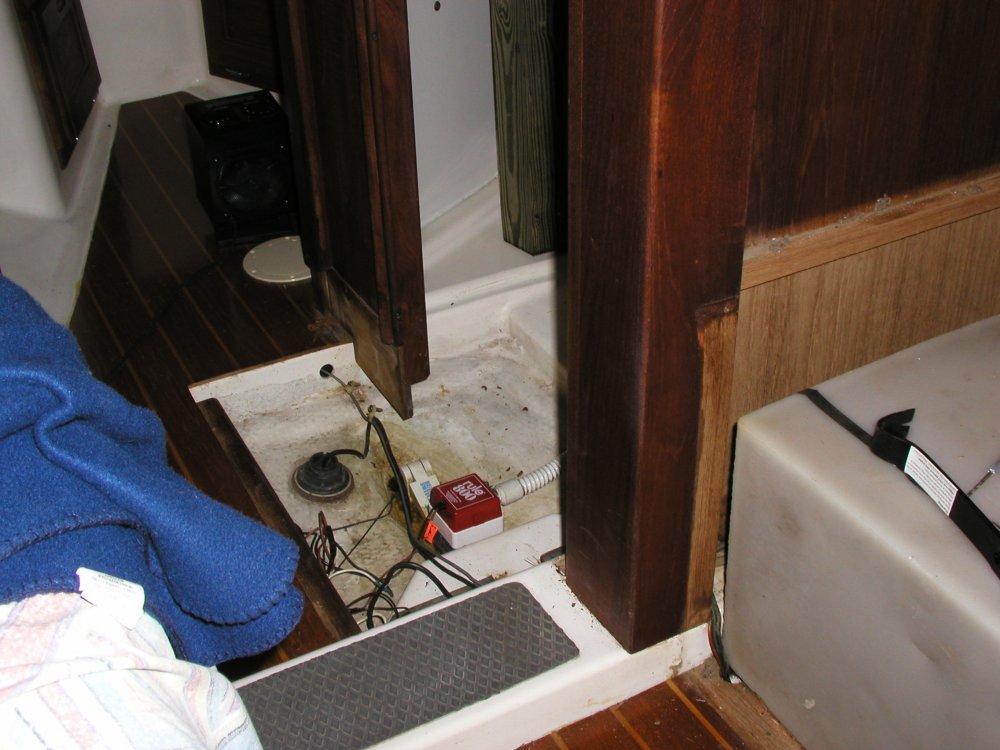

I don't have good information on the thickness.. The picture shows my depth sender in the little shower sump and the speed transducer under the white cover just forward and very slightly to stbd .. Both are standard length transducers from Signet Instruments.. I think the hull thickness is around 1" at the speed sensor and a bit more in the area of the shower sump where the depth sender is..

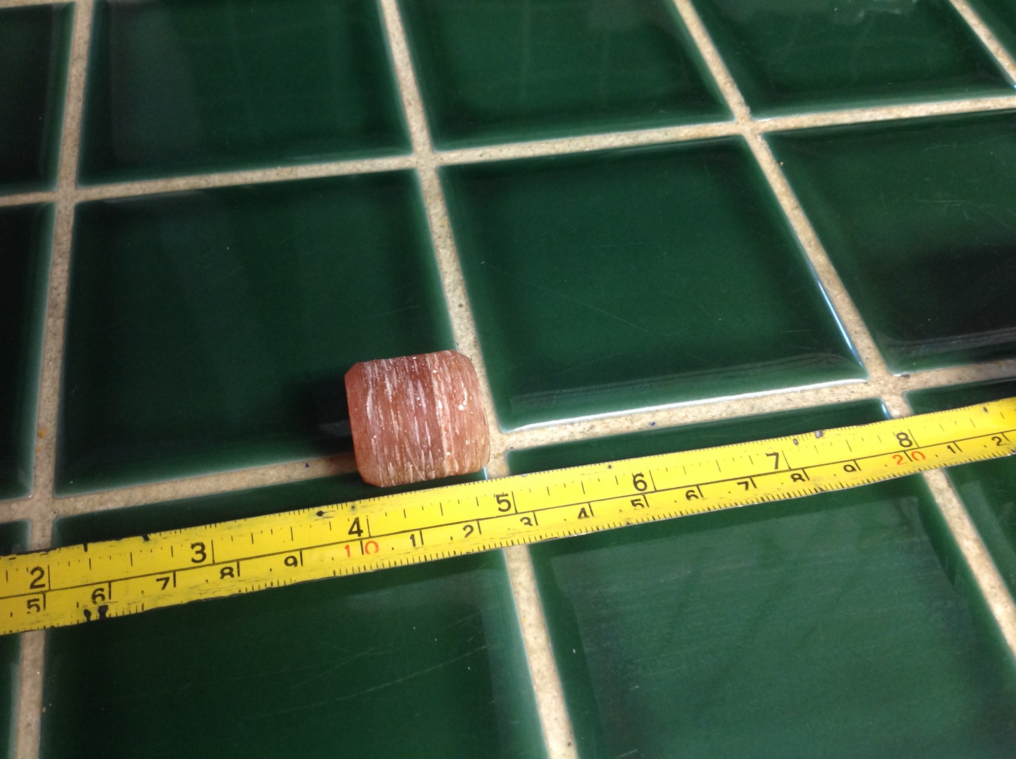

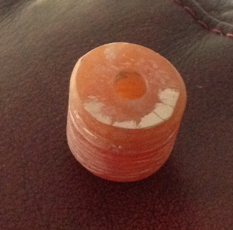

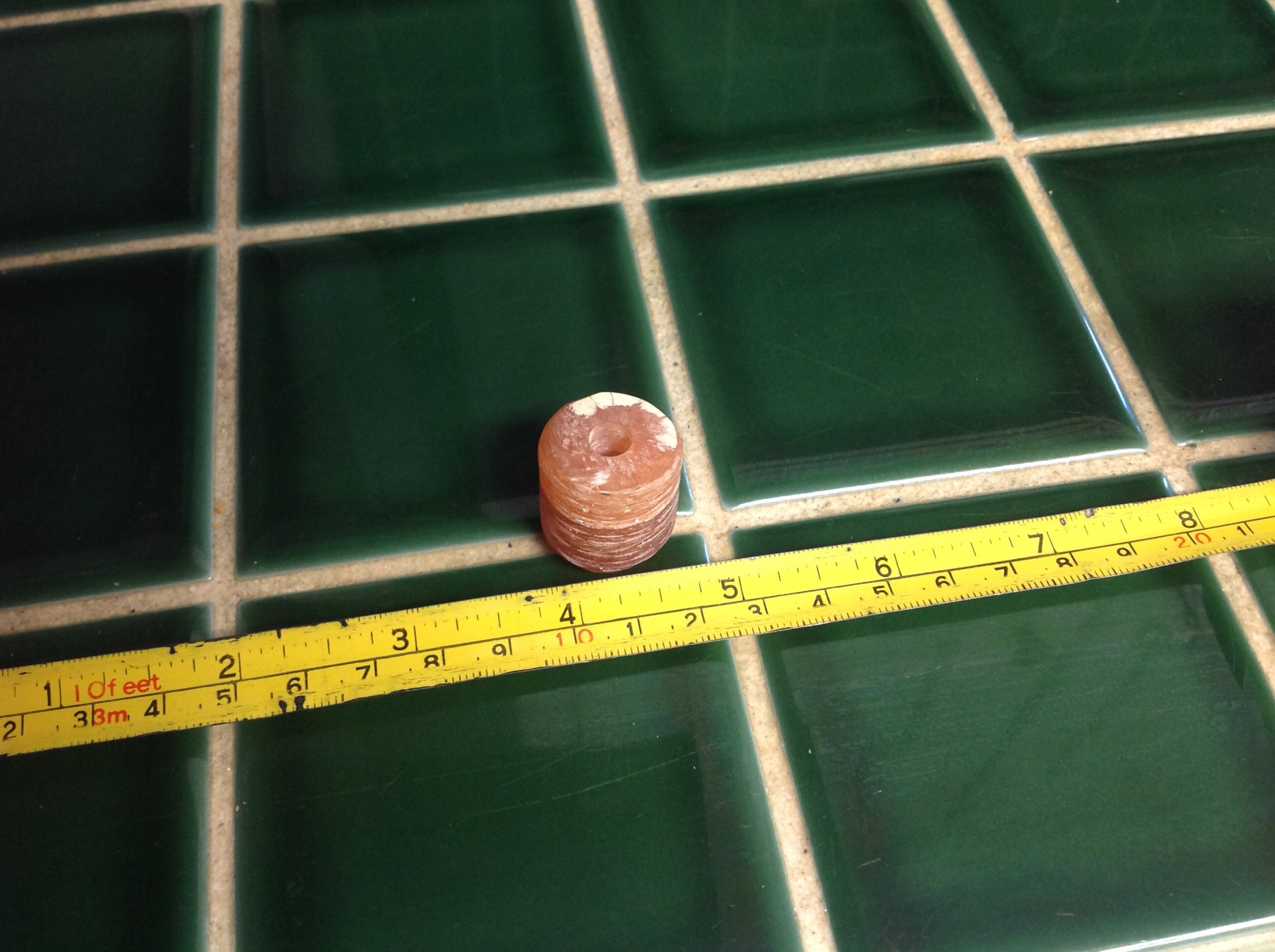

I installed an Air Conditioner Unit on my 2000 340 in 2006. It took me a while, but I found the plug that was drilled out. (I looked all afternoon, I got to get better at this finding stuff.)
As Kloudie and Capt Robbie have said, the flattest area is forward of the keel and the best location.
My intake for the air conditioner is 4 inches from the front of the keel on the starboard side. For my boat that is the most forward part of my bilge area and flat.
It's just under 1 inch thick. Here are the pictures of the plug.
I hope this helps you.
