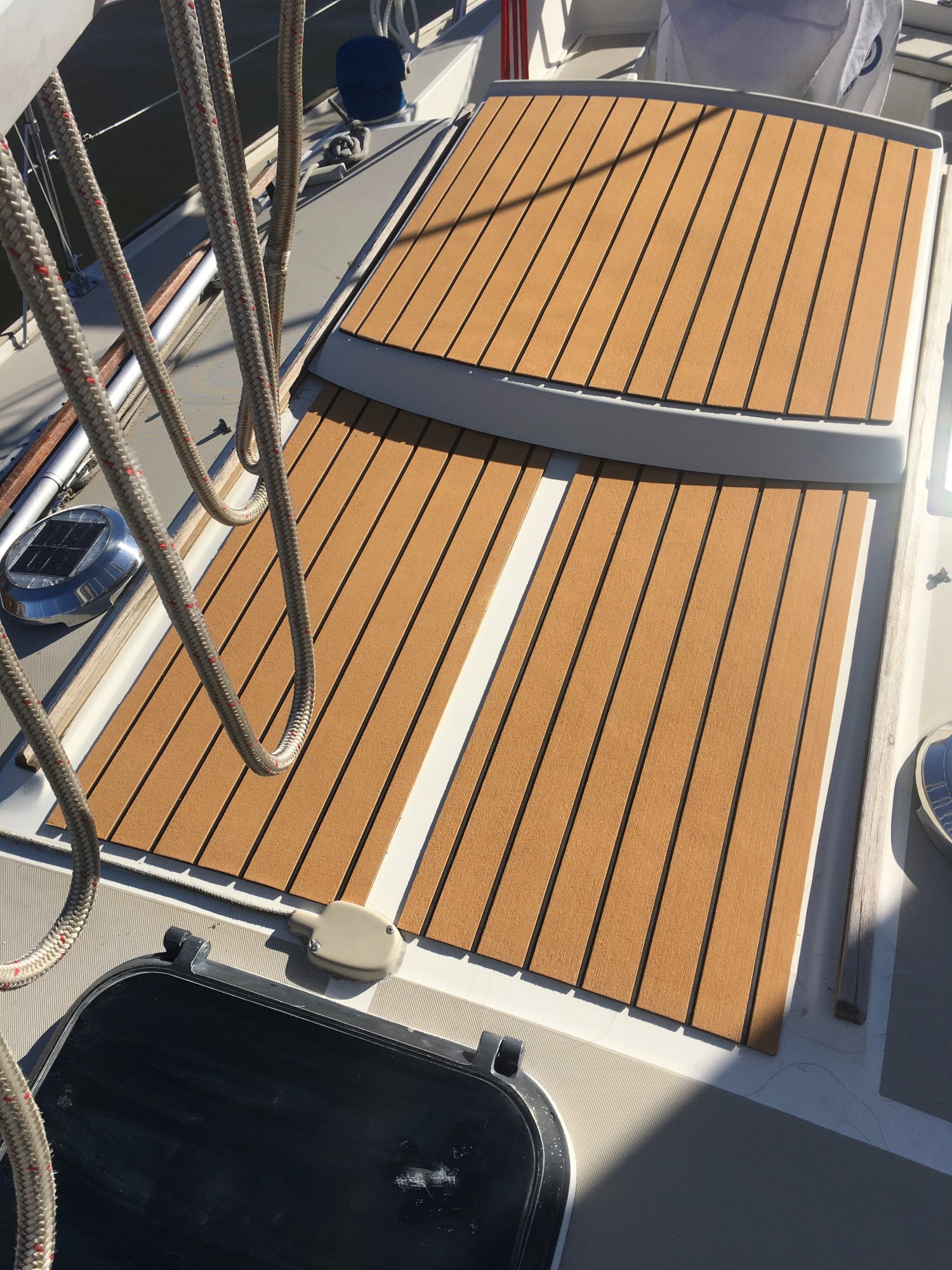

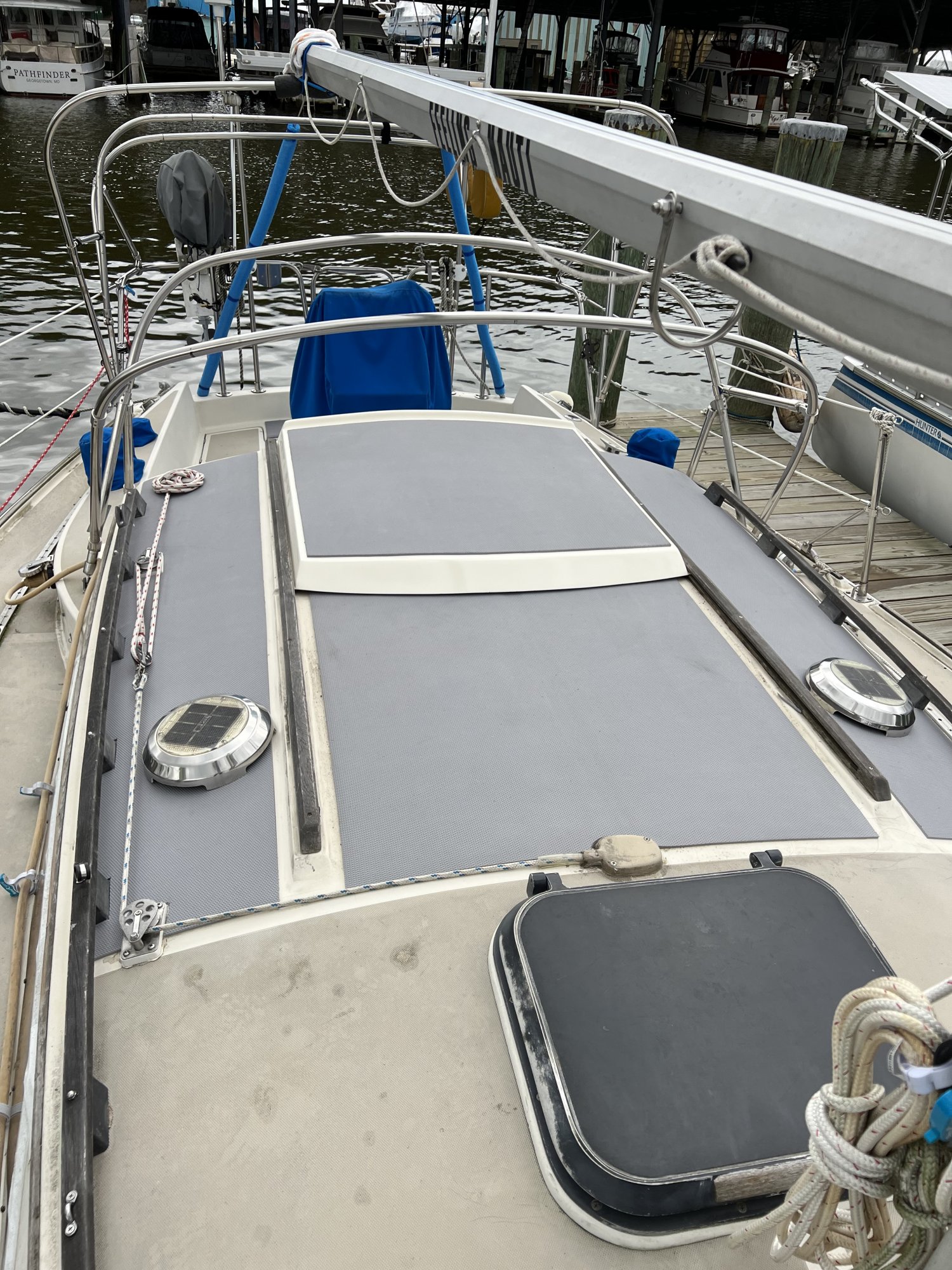

I have used this product, not inside but outside. Over a two year period with the boat in the water I found the following.
a) it will keep every little pit mark given to it. It also rips easily.
b) it is not UV resistant. It breaks down into a fine dust
c) it is not water resistant, it acts more like a sponge.
I removed everything from the outside and replaced it with SEADeck. ( picture showing gray product)
I have it in one place inside my boat, namely on the inside of my deck hatch/port to hide the bad spackle and paint job for the moment until I do some major cosmetic upgrades.
I have a lot of left over pieces if you want them, you would invest in the shipping to you.
