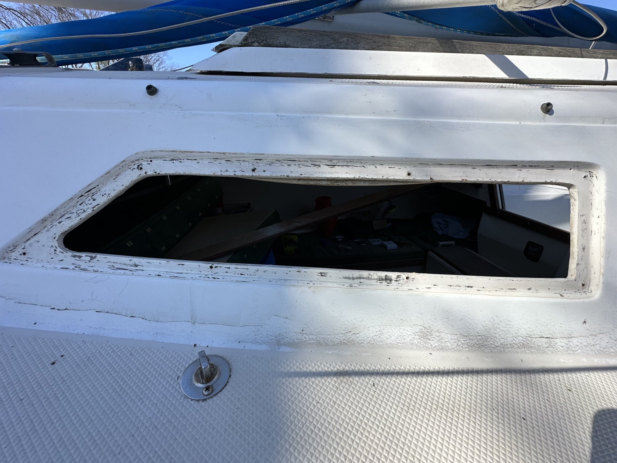

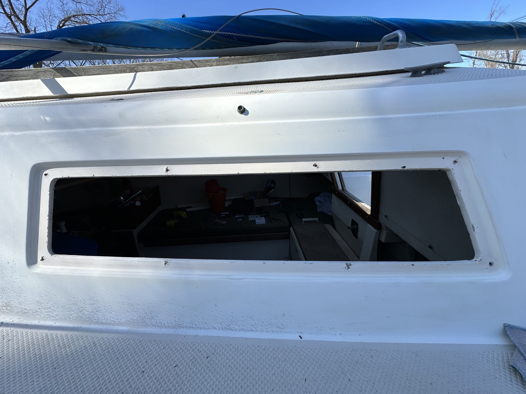

Finally warm enough to finish the window job this weekend. Adhesive needs 60+ degrees.
I did not try debond, b/c I never ordered it, but acetone wins over mineral spirits to clean the old adhesive off. Acetone and a lot of rubbing and thumbnail scraping. But it eventually comes clean. See pics.

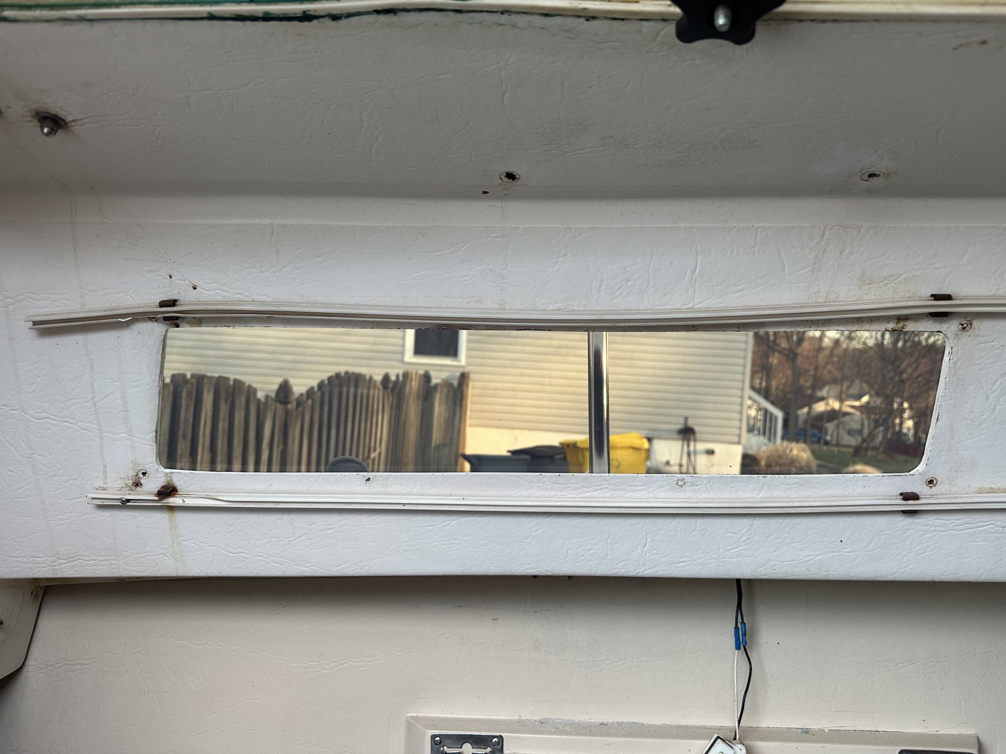

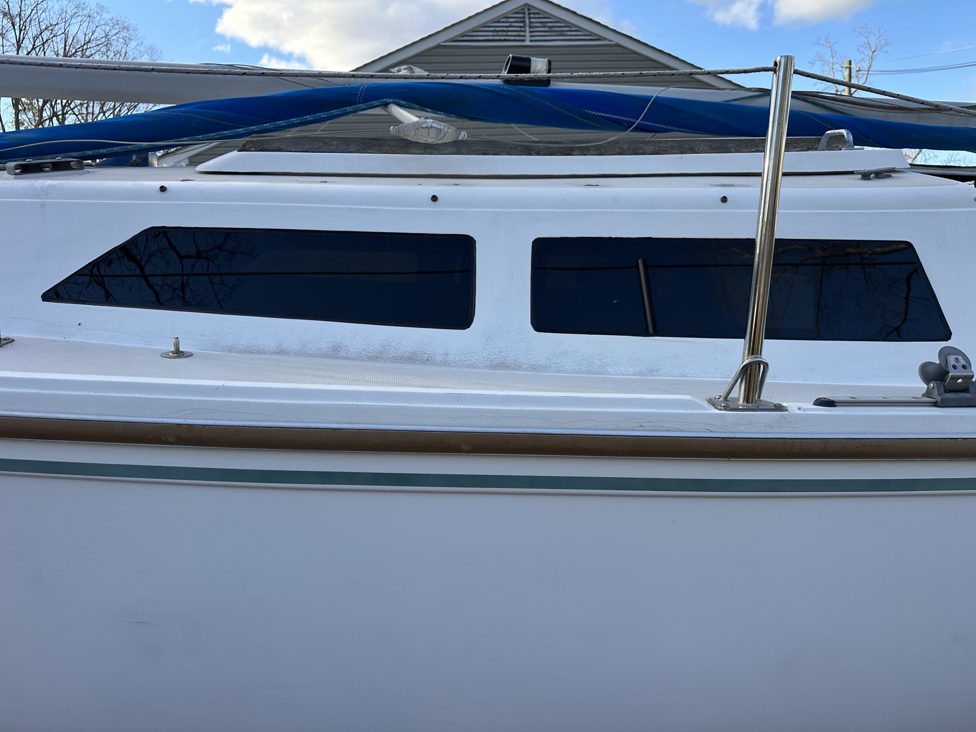

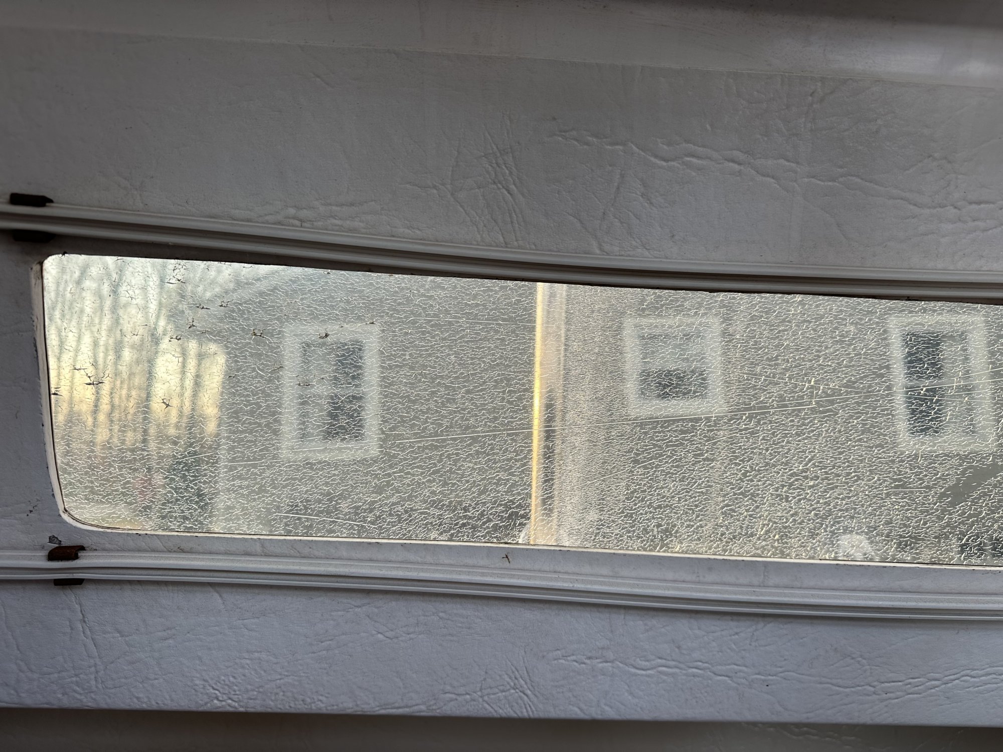

I installed the 2 on the side that was leaking this weekend. The difference is amazing. I included pics to show the difference b/w the old crazed plexi and the new.
Did not need to reinstall screws. VHB tape is all that is needed for the next 30
