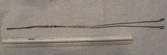

if you have an eye splice in each rode you can pass one line through the eye of the other then back through its' own eye. It is good practice to eye splice triple strand also instead of just whipping the end to keep it from fraying I like to use a backsplice, very professional looking and very easy once you do it a few times. If you are using braided line you can make the eye splices using my "Magic Splicing Tool" that I have advertised right here on this site many times. I am not making a lot of money on the "Magic Splicing Tool" because they are free by making them yourself.

Thanks I'll look for the "tool".
Would these lines then always be together or would you make the splice on the spot or what? I want to keep the rodes separate unless I need to put them together to get the length. At that point I might be trying to anchor/tie to shore at a difficult time and/or place, like in the picture, and need to do it quickly.

Here is another picture of the "Magic_Splicing_Tool." Somewhere in the archives I posted directions for use. Search on magic splicing tool to find them. This tool is fantastic and it is virtually free. I've used the fancy expensive tools, in comparison the inventors should be in the cell next to Bernie Madoff. They stink. The magic splicing tool was invented based on a tool I bought that worked great but broke after a few uses. I looked at it and said I can make the same thing out of a coat hanger for free and it will never break. I still have the original tool and it is going strong. For smaller line you just need a piece of smaller diameter stiff wire to do the same thing.
Triple strand is simple to splice but braided takes some practice, so if you are in a rush this is not the way to go but if you splice your lines in advance with eye splices then they are ready for use as dock lines. Putting in a thimble as Ross suggests still requires a splice so use the tool.
