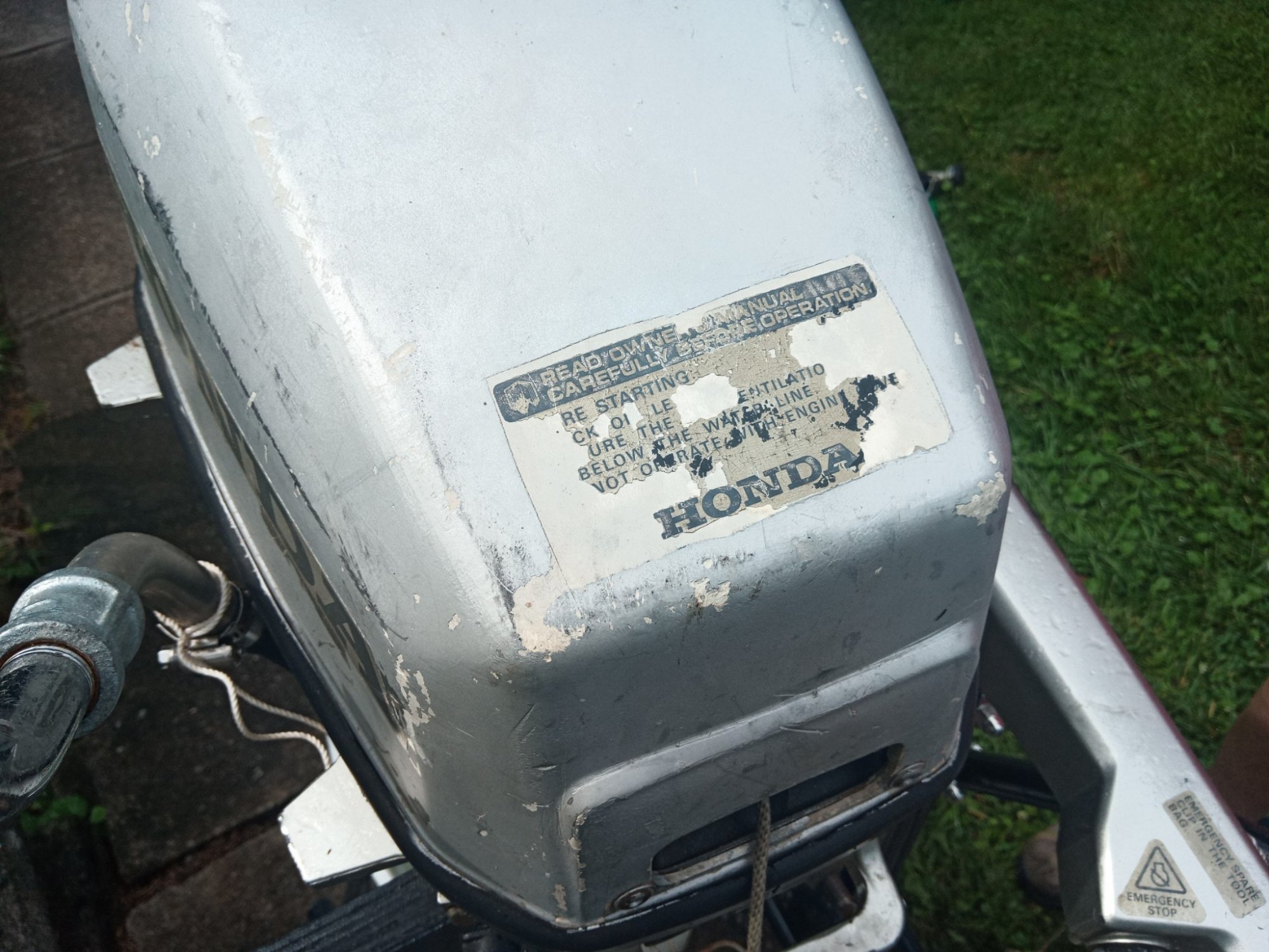

Also can not figure out the year. I've looked everywhere cant get a confirmed year so I can get the manual.

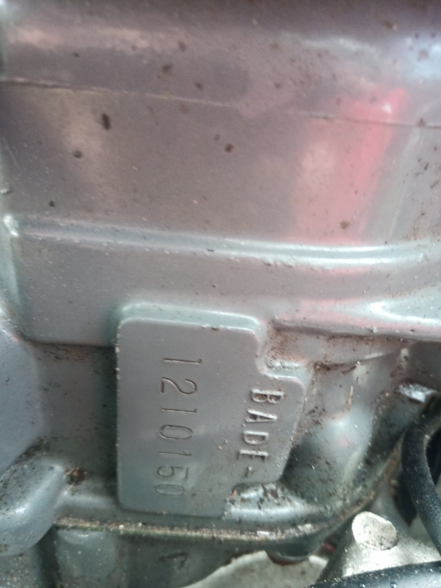

I did find the stamped Engine serial # bade1210150

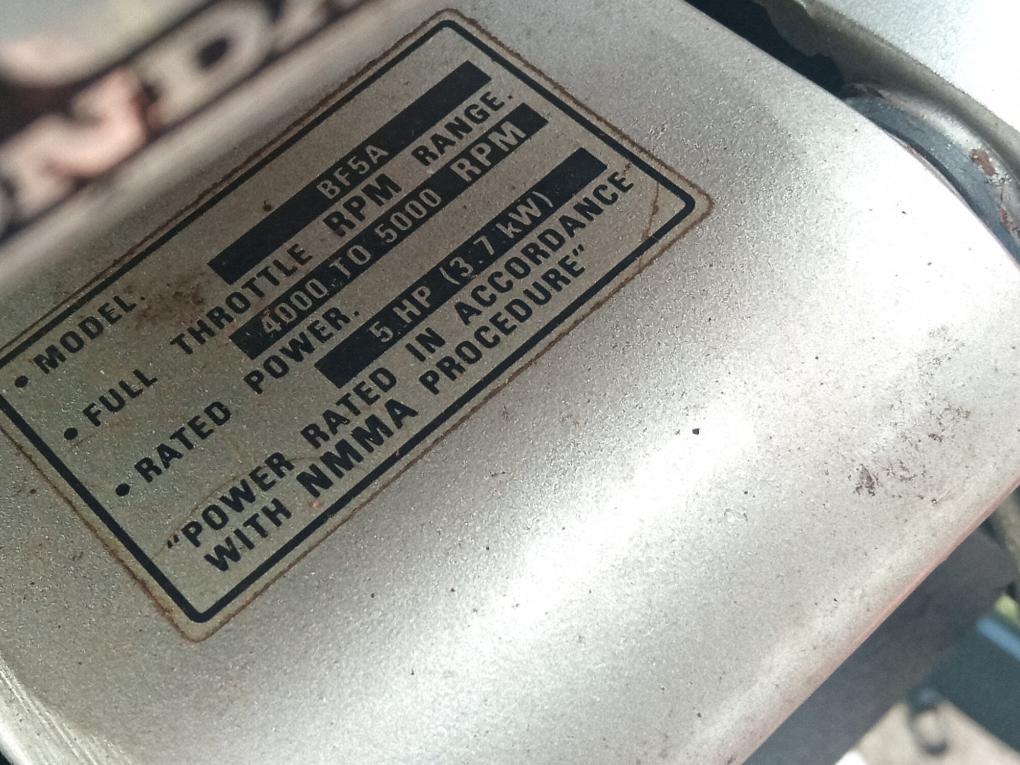

Says model is BF5A. But can not find the product # and cant figure out the year to get the manual and order parts.(Says product # should be stamped on swivel case.. but It's not, looked everywhere, 3 times, lol)
Searching for year/model using these numbers.,... I'm seeing anywhere from a 1991 to a 1997? Can anyone tell me what year this is and where to find the manual for it online?

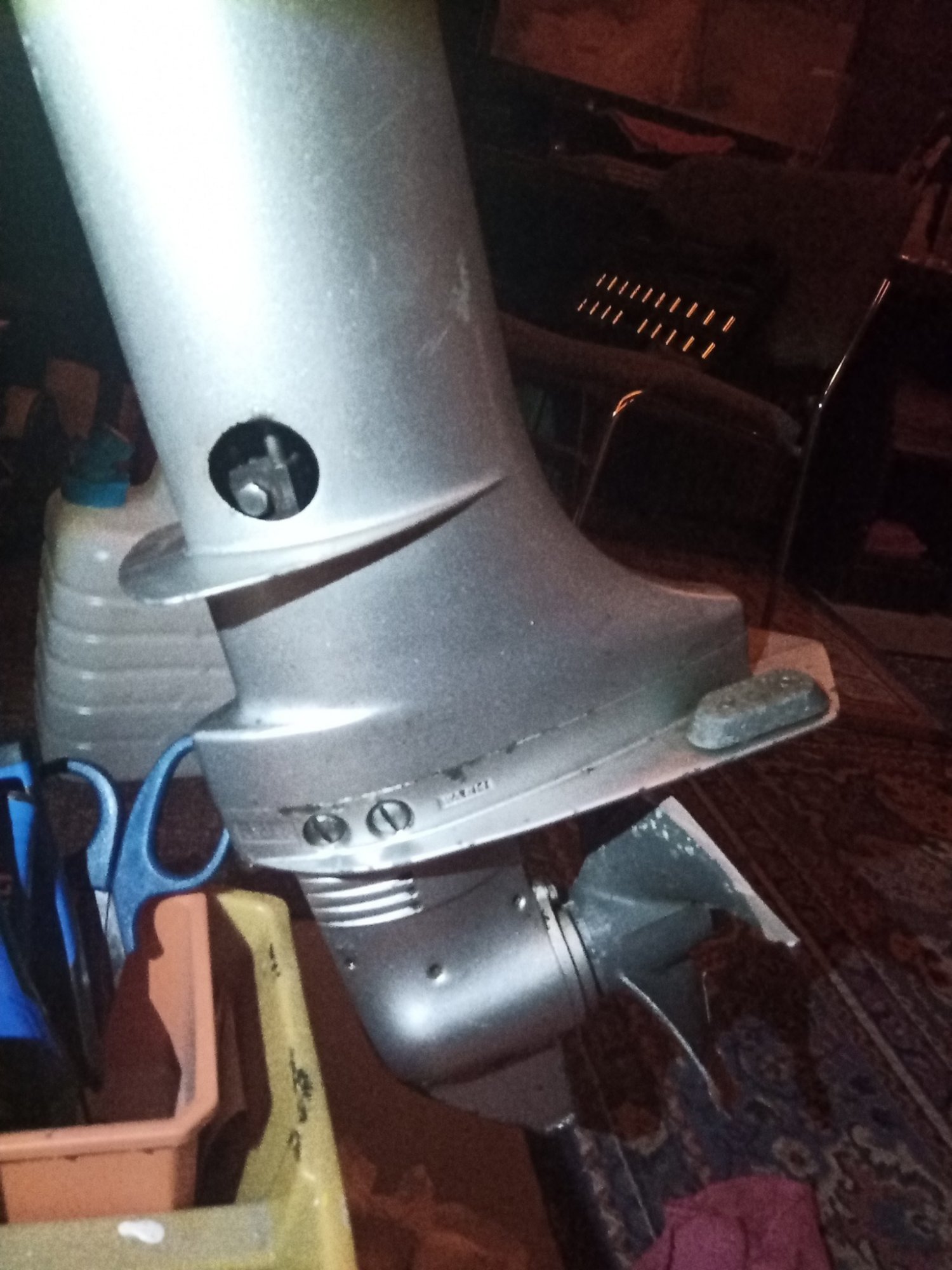

There is a cap missing down lower on the shaft (see pic) ? Is that bad after sitting for 4 years like that in a garage?

The impeller needs to be replaced every year. Instructions are in the link below. The grommet extension is missing, so you will need to replace it.
Have you checked with a Honda dealer for the manual? That serial number doesn't appear in the list of manuals for the BF5A. The motor is probably one of the early production runs or it may have been a model destined for a country other than the US. A dealer or calling Honda directly might be helpful.
The manual for the BF5C is probably similar to the manual for the BF5A.

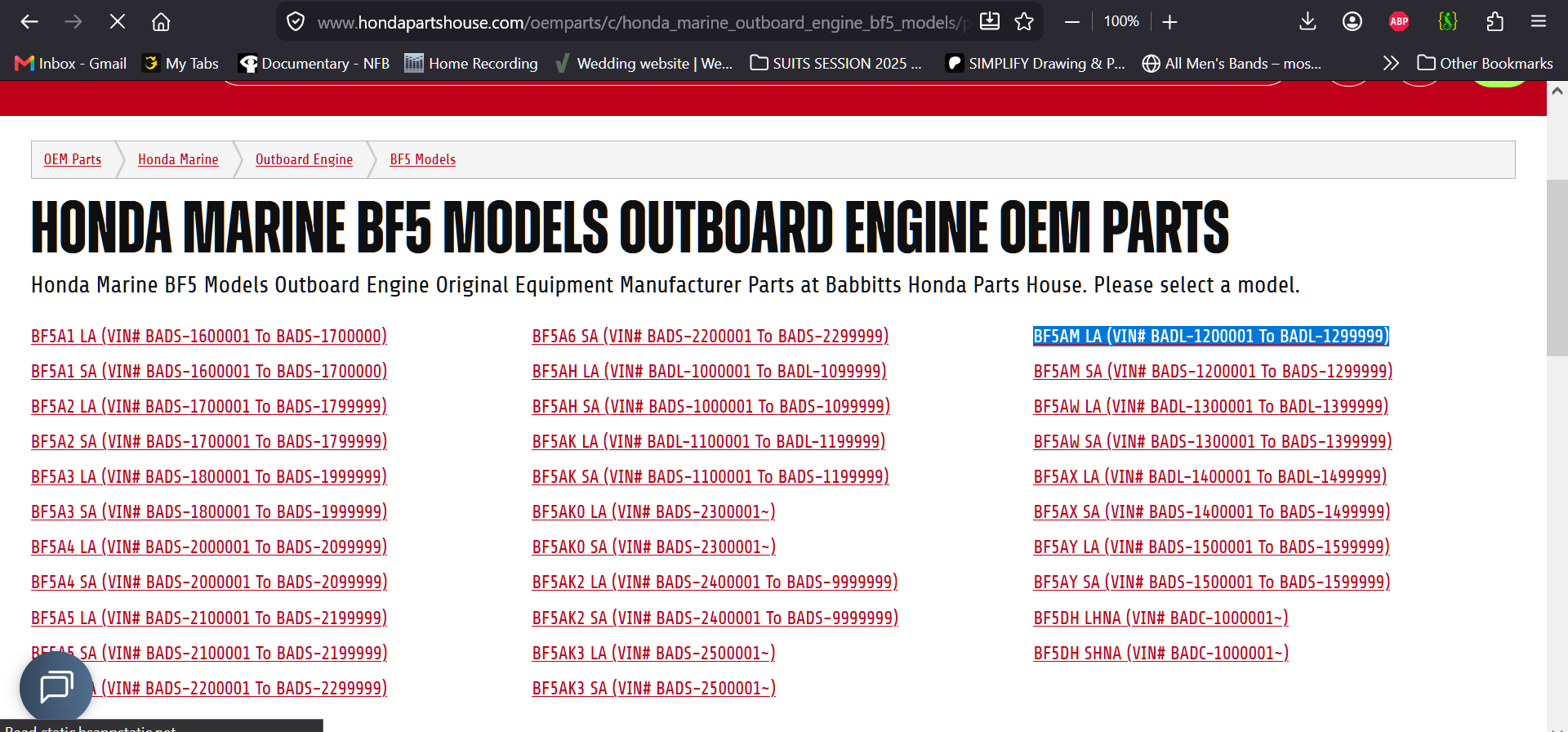

Yeah couldn't find that serial number anywhere and the outboard didn't have the usual physical plate with serial on it anywhere. After a ton of searching I ended up on this one... it seems like the right one and all parts so far look identical. Hope so cause I ordered over $100 of parts for it ,lol What do you think?

The serial number is stamped into the engine. Yours starts BADE 121...
The BF5C is a slightly different model of Honda's 5HP motor. Over the course of building an engine model Honda probably made small changes in the engine. The different letters indicate which production run the engine built.
