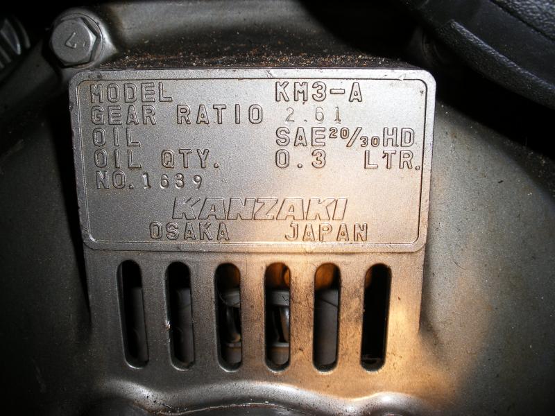

Claude A, I have the same page in my "real" Yanmar shop manual. I can't find a pub # or date in the manual, but have supplement pages, pub # Y00R0902 revised Jan 1982.
I am more inclined to use what the oil the builder's plate recommends rather than the manual's spec. Over the years I have found errors that have crept into service manuals--some glaring, some not so. It is possible that the maual updates the builder spec, but I'd want to see some sort of confirmation.
