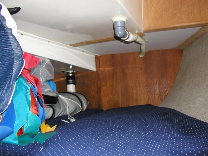

The area port aft in the aft cabin is where the second water tank lives. There is a little space in there but not very much.. This space is the bottom right wood cover in the attached picture.. The area above that is the lazarette.

Sorry, meant space STBD & Aft under cockpit. I will check Home Depot for the rubber bumpers & closed cell foam cushions.

I think Dan Johnson may have cut through that bulkhead so he could gain access to the fuel tank. He may have some pictures of the opening and what you'd see with that opened up. There is a good deal of space back there.. I use it for storage of the dingy floorboards and on long trips, it becomes a place where the garbage bags go to be out of the way. Some things that may give you heartburn are the cockpit drain, the fuel fill, the fuel vent, and the exhaust hose.. I'd be curious to see what you find..

Ditto Kloudie Re rubber bumpers and through hull. I agree with him also regarding the space where the 2nd water tank is behind the stern bulkhead. As for the bulkhead to starboard, I did make some changes to gain easier access, but the height of the fuel tank along with the steering column are going to prevent any major changes to enlarge the bed area. And as Kloudie says, the space above the fuel tank can be used for fenders, garbage, etc etc on long trips. The stern bed itself is not bad as far as width, but of course the person inside must not suffer from claustrophobia. I often thought about putting a porthole on the port side, similar to the 37 legend. I think it would also provide more ventilation in the cabin. Far worse than space IMHO, if docked somewhere with the wind coming from the rear, there is some back-slapping which gets to be very annoying. Anchoring avoids that however ! Welcome to the group and good luck with the boat.

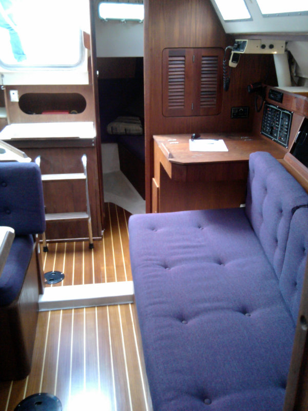

IMHO, depending on the amount of damage the best option for the sole is a complete removal and repalcement :eek: I just got my H34 from a broker down in Mayo and he did this before we bought the boat. The leaks from the hatchway... may just need rebedding. I'll post some links to the pics as soon as they are uploaded and resized

Nice-work looks like it turned out very nice. But I could not help but notice the tripping hazard in the main cabin. I guess there was no way to fix this hunter design defect. It seems to be only few inches of head room loss. Better then breaking toes or worse.

Is that a Beckson access port in you main cabin sole? What does it access? Was there a need for it?
