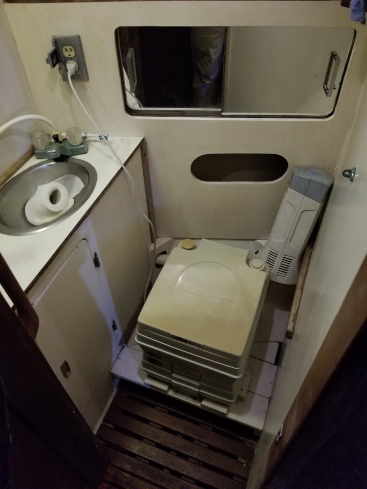

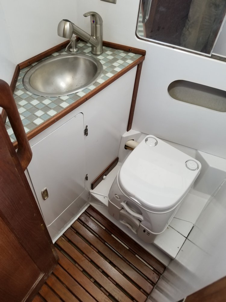

The ones I have seen are too deep for the H31 head. I had to change out the porta-potti in mine for a smaller one so that my wife could shut the head door when in use.
How it was when we got her.

After the restoration.
You can see I got almost 7" more floor space.
The Air Head, and Nature's Head both seem to be much deeper.

Nice looking head renovation! And it looks like you went with the MSD version of your portapotty.

I think what you've done is just fine...compact, uses very water, -0- maintenance...easier to empty than any "composter" 'cuz it can be pumped out instead of having to carry the contents off the boat. Who could ask for more?
