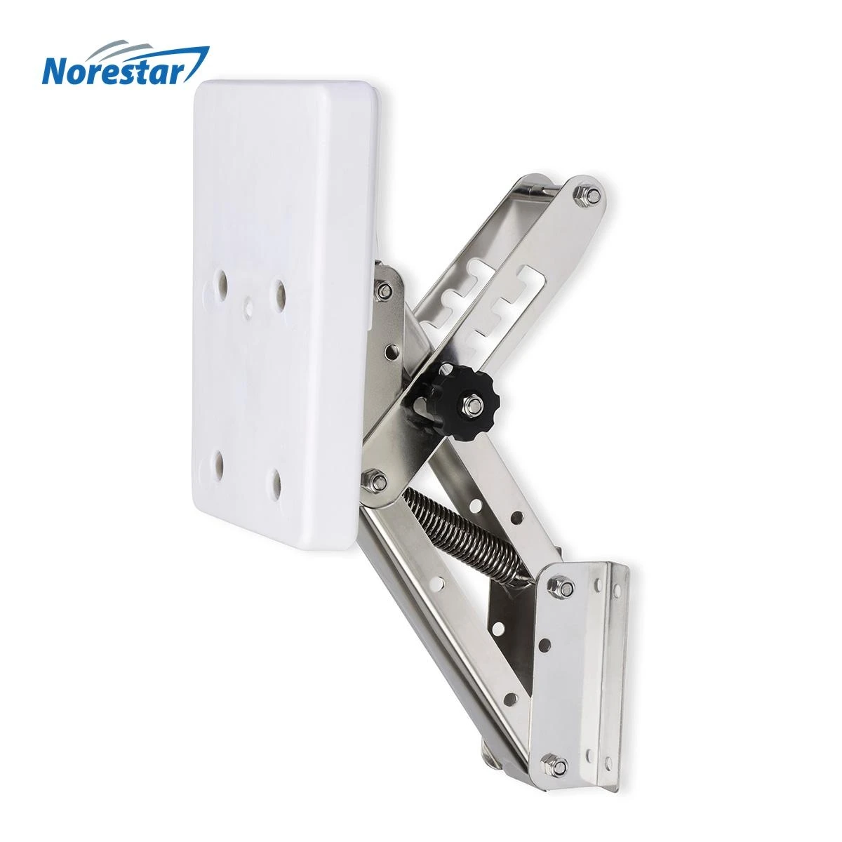

We have the same motor, Yamaha 9.9 ... did not put any extensions on the wood transom and the issue is that we cannot fully lift the motor out of the water. The motor arm hits the gas hatch and the deck. I assume the solution is adding the aluminum tube to provide some distance?
12,776
@DeliriousSailor ... one of these might make the difference.
