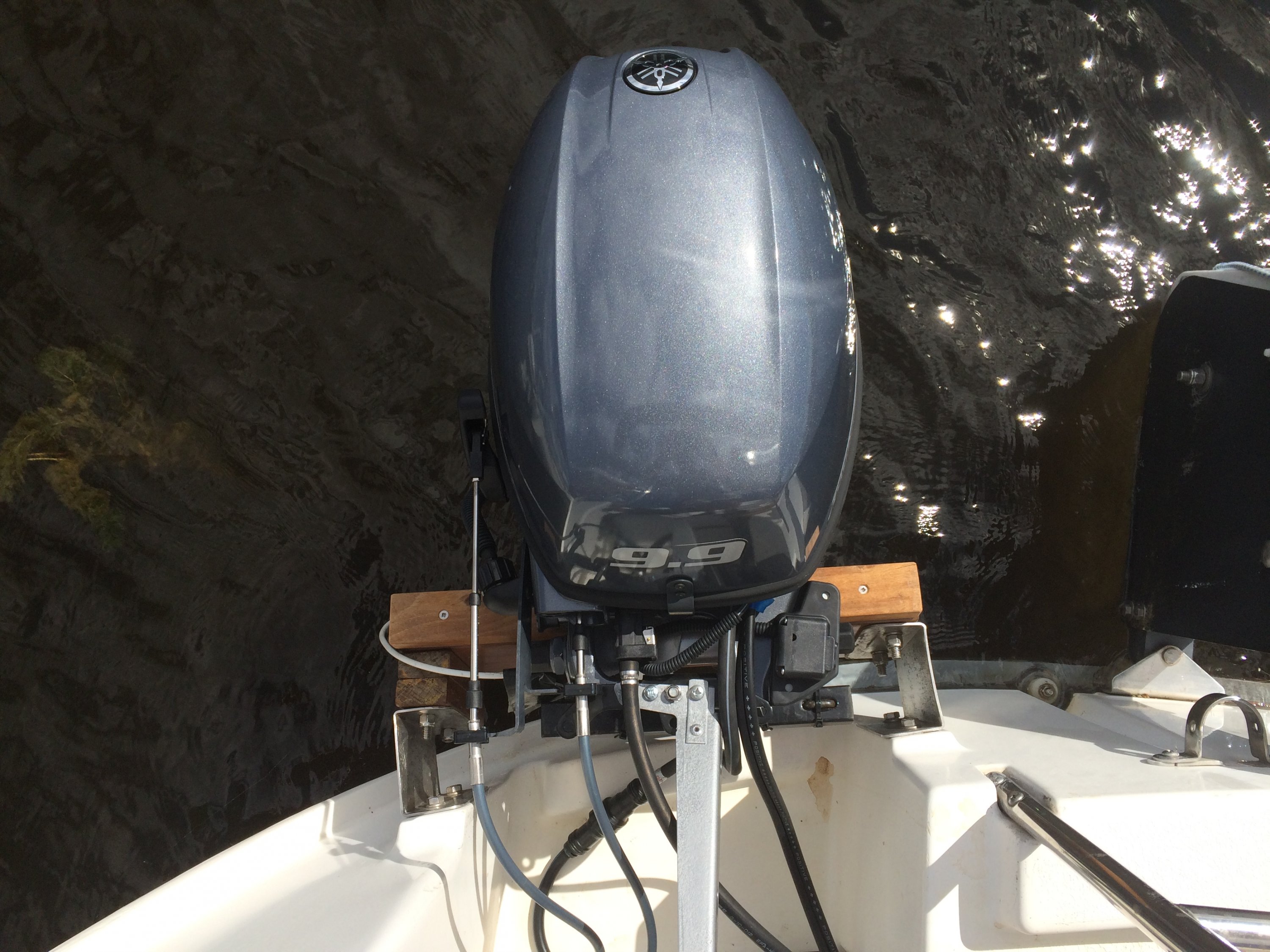

I have a 25 inch motor. In really heavy seas it still cavitates from time to time. The stern on the H26 is plenty strong, I haven't noticed any issues. I agree with Ranger about dragging on port tack. Two mitigations are possible 1) eliminate any "pre-tilt" on the mounting board (mine has too much, I need to change the brackets). I had to pre-tilt the motor to the second or third hole to negate the pre-tilt of the mountingboard. This means that I am effectively losing some of the motor tilt (i.e. 70 deg max) and 2) ensure that the mounting board is perpendicular to the boat (I had to install spacers to make this happen).

Fred! You have really done a lot of subtle mods on your boat. Thanks for the spacer idea. I think I'll do something similar with mine. The dragging of the prop drives me crazy... after all it is the silence of sailing that is a big part of why we do it.

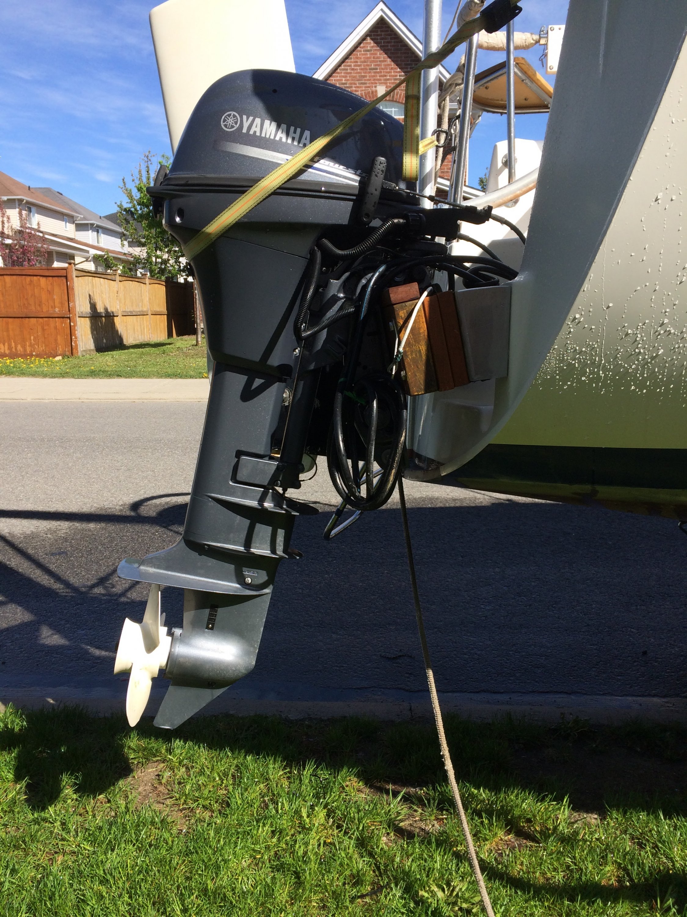

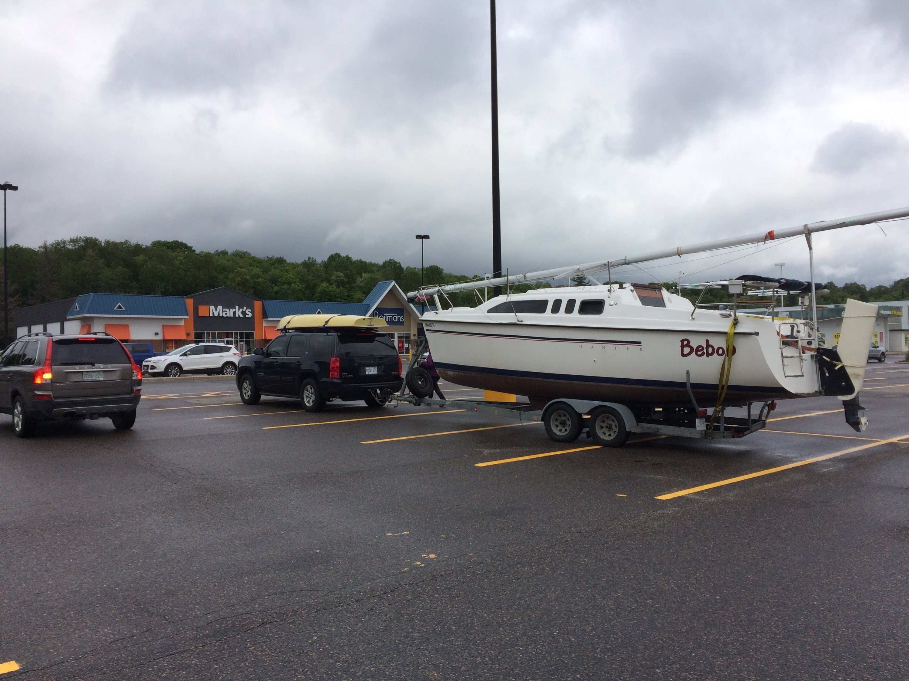

I have a 25 inch motor. See my trailering configuration attached. It is important to use the correct drop down hitch platform to ensure that the trailer is level. I use a strap on the motor to (partially) offload the power tilt mechanism.

As a dealer particularly the 25 inch shaft I suggested to tilt the engine before pulling trailer out as a precaution. When on flat and level ground, let the motor hang level with a line attached to the handle to prevent motor bounce during travel. However if going over for example railroad crossings that are elevated with a jump psticularly with a warning sign, be cautious. But if tilting the motor during travel, secure it to prevent it from accidental drop down. If new with a 25 inch shaft to each owner, float the boat to the trailer while at ramp with it down and possible pull out very slowly to see what happens to determine what you will do as the responsibility will rest with you. Also with floating docks and yes I have run into this, shallow cross ties or wires holding docks together which I encourage always checking with new marinas to see how they are built to include if anything under water construction

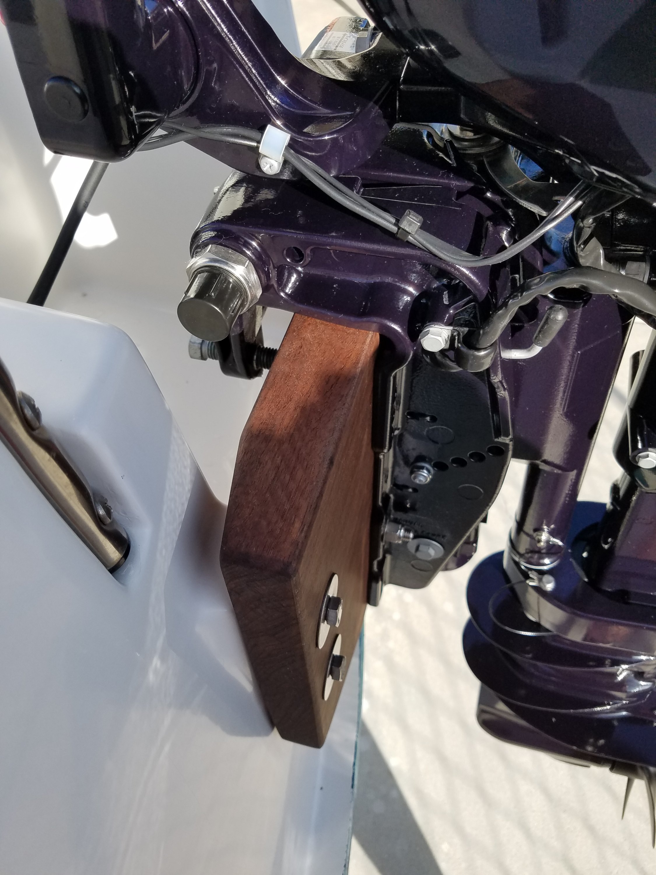

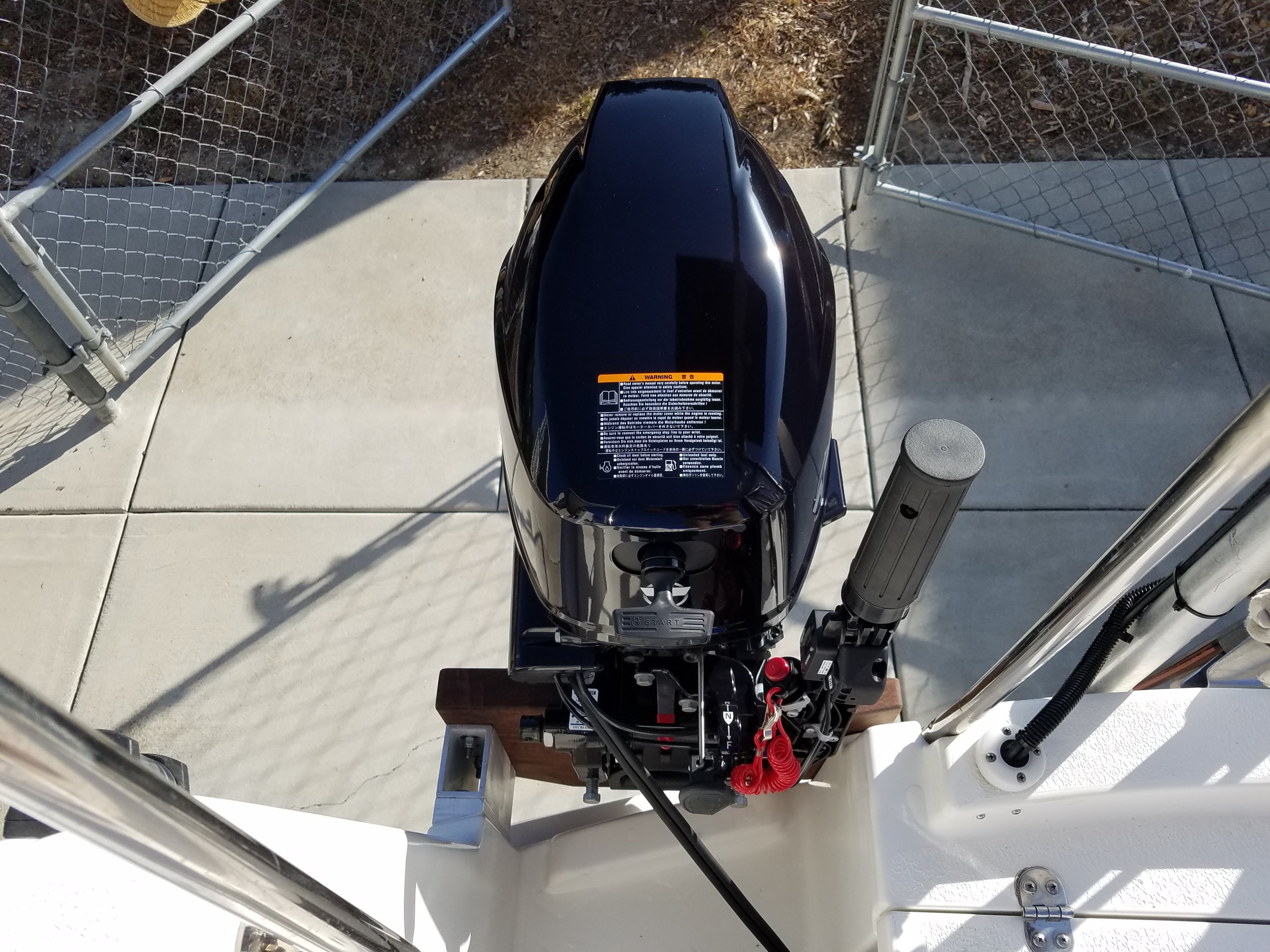

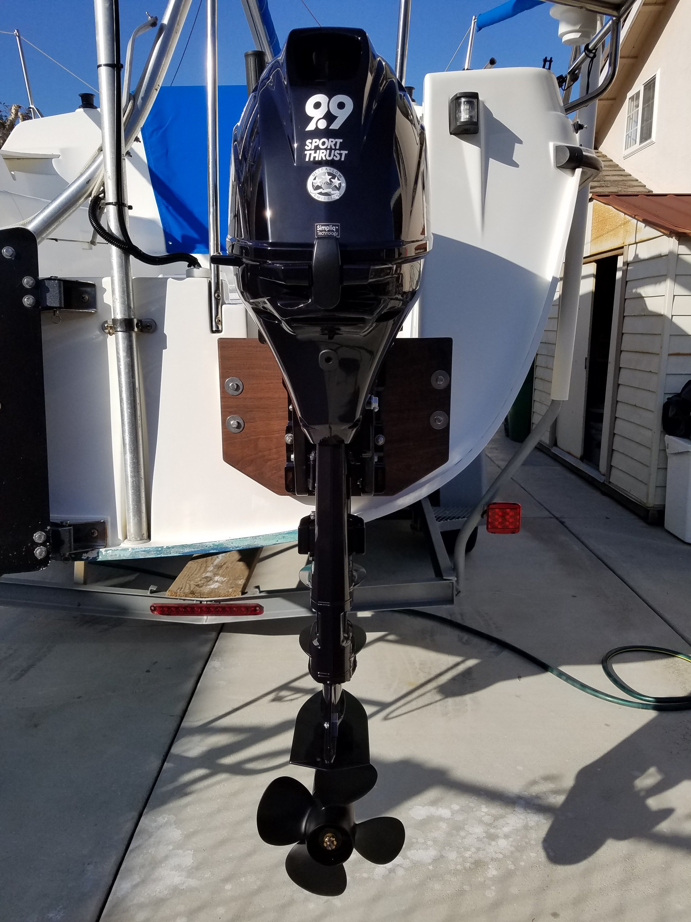

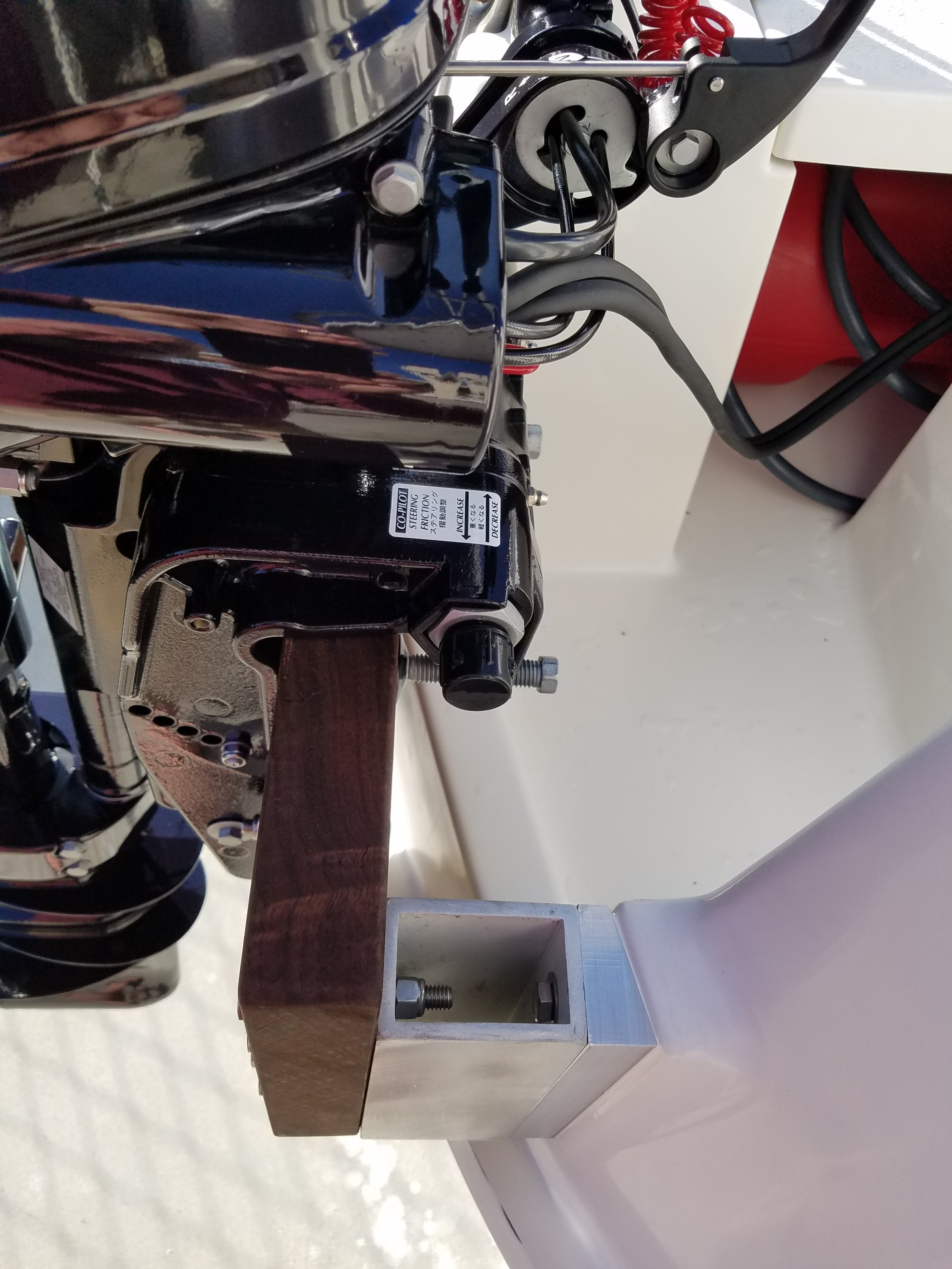

My new 9.9 hp, fuel injected, power tilt, 25 inch Tohatsu is now installed. I replaced the original motor mount with a new stronger one, and made the mount squared off with the transom. The starboard side of the mount is extended out 4 inches. The aluminum tube is 2"x 3"x 8", 1/4" thick. An aluminum wedge 8" long adds another inch, for a total of 4 inches. The port side of the wood mount is beveled and shaped to fit the contours of the transom. The wood is walnut measuring 19" x 13" x 1.75". I used Watco Danish Oil to seal it. I didn't want to use something that would peel off and need to be re-done. I figure I can re-apply the oil as needed. After receiving the new motor I was a little concerned about ground clearance while trailering. The owners manual says not to trailer with the motor tilted up. So I compromised and lifted the motor 2 inches. I'm comfortable now with the ground clearance. The motor being 2 inches higher I think will also make access to the controls easier too. The tilted up motor fits nicely in the motor well. The whole assembly is thru-bolted. I drilled out the holes thru the laminated in aluminum plates that are embedded in the transom. Inside I used large SS fender washers, making it very strong and secure.

Wow that looks great have you had it out yet? What speed are you getting keep us informed I didn’t know they made fuel injection 9.9.
Thanks Jimmy! I plan to put it in the water next weekend. So far I have only 5 hours break in time in a barrel of water. I'll follow the break in procedure for 5 more hours. Then the following weekend heading to Catalina. The motor won't make the boat any faster, limited to the hull speed around 6.5 knots, but it should be reliable and easy to start.
Oh, Suzuki makes small motors with fuel injection too. I think maybe they were the first to do it on these small motors, with no battery required. Pretty cool, won't have to worry about a gummed up carburetor. Now need to worry about fuel injectors.:biggrin:
Likes: Jimmy

Very nicely done Doug! My motor has the remote control cables so I required more offset than 4 inches (need more clearance when tilting up). I will be interested in hearing your experience, particularly to what extent the motor will drag on a port tack. I think it should be fine.
Fred, I'll let you know if it drags. I don't think it will though. A friend has a 2015 Tohatsu 9.8, 25 inch shaft on his H26, he said his doesn't drag on a port tack. Maybe the Tohatsu's tilt higher.
