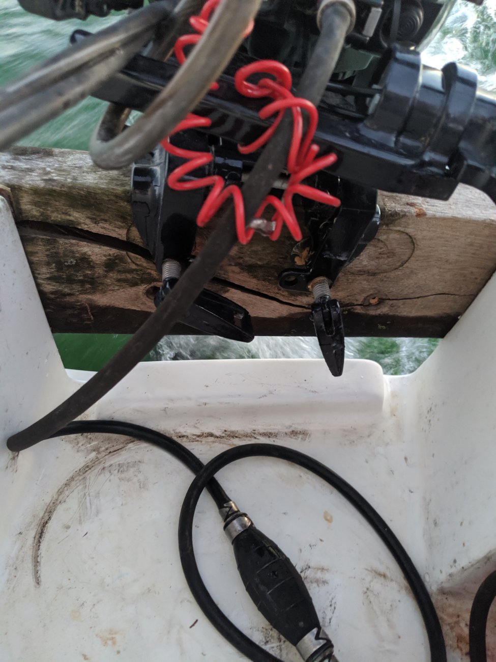

Hello all, I am the new owner of a Hunter 26 slipped at a lake. I also need to change the outboard engine mount. What would be an easy repair that will hold an 8hp Nissan. Here is a photo on what it looks like. I appreciate the help and guidance I will take photos again when finished. I am thinking to go to local store and get treated wood and cut it to size. Drill holes for the 3/8 stainless bolts. Clean the surface of the boat with some acetone and then use 4200 around the holes before bolting the wood back to the boat. I am not calculating anything other than getting it done. Is there anything else that I need to consider like spacers, or?
Thank you here is a current photo of the bad wood just after it split underway.

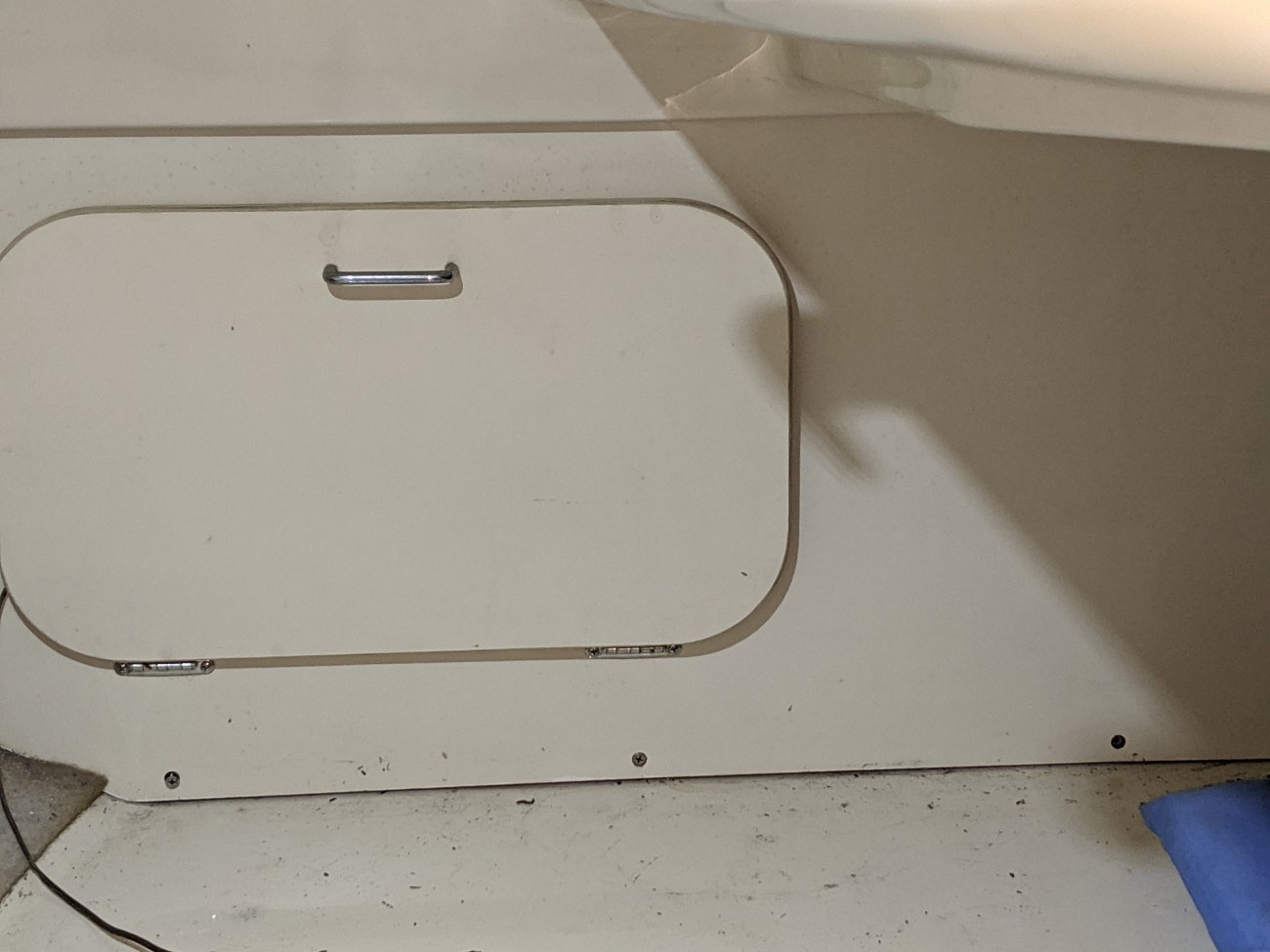

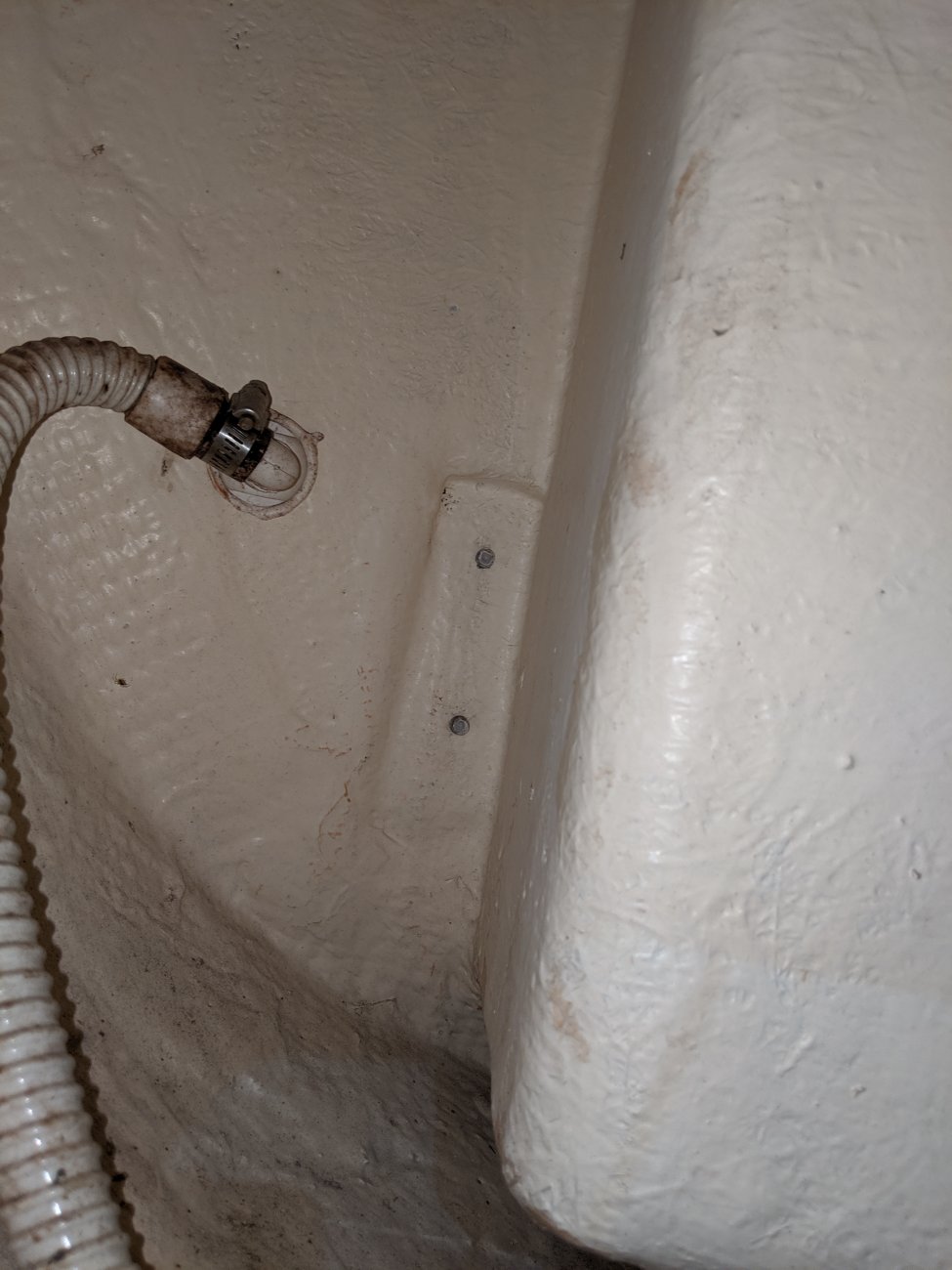

Here are some photos from inside also. I will remove the screws on the panel in the berth aft to get to the back of the motor bolts. It is interesting that it does not have any nuts there? Should I add nuts, do I need washers, should I have any backing or just tighten the nut onto my new bolt. With 4200 to seal it up? The current board is 16 x 6 x 2.

There are aluminum encapsulated plates in the fiberglass which was drilled and tapped. This is why You do not see any nuts and with the newer four stroke engines and/or if the threads wallowed out, I have suggested distributing the load in the back by adding plates to the backside.

Your pictures will make my life easier. They show what I expected to see which is two metal strips laminated into the structure of the fiberglass (you can see the outline in IMG ....827). The holes in the metal are threaded which makes things easier. You don't need help of another person when tightening the bolts. Using 4200 is a standard approach to prevent water from wicking along the threads and causing corrosion.
Perhaps you would like to reconsider the use of treated wood. Other than chemical treatment this is very low quality, low strength wood. So from mechanical point of view it will not be a good solution and it might even stain the gel coat and corrode the bolts. The zero dollar, high strengths solution would be to use a scrap of Versa-Lam laminated wood product. If you drive by any residential construction site you will find scrap pieces much larger than what you need. It is an order of magnitude stronger than regular wood, reasonably waterproof and if you varnish it it will give you many years of service. Garolite (phenolic) or other strong plastic would of course be better but unless you have connection to scrap pieces rather pricey.

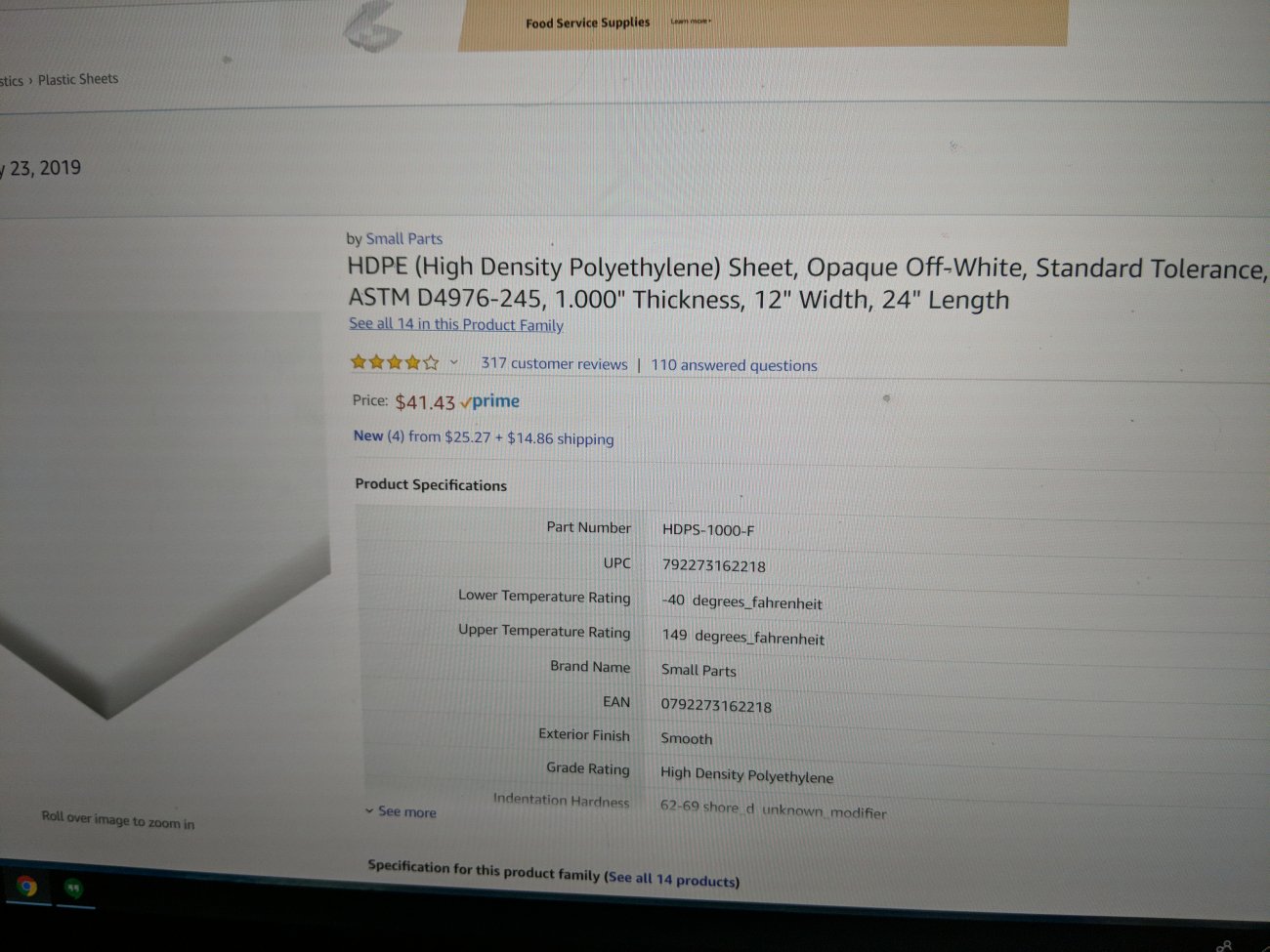

So after a friend did not like my home supply store wood option as u have also pointed out. I went a head and ordered 2 pieces of starboard and intent to cut them to the 19 x 6 and since they are 1 inch thick I will use 2 to ensure the strength of the original 2 inch mount. Here is a photo of what I ordered now it's hurry up and wait until it arrives in 2 days so that I can get back on the water. Any comments on this direction would be appreciated.

It will have the strength for sure. Could not find from the listing if it is UV stabilized or not. If yes, you are perfect, if not it will get brittle. Best part is that it machines beautifully with ordinary woodworking tools and it will look great. Even if you have to replace it in 5 years, it might be great option.

I am familiar with the boat and engine. If starboard, it will be fine but you could call the mfg to make sure. I used starboard too for outboard material to use. But it is costly.
