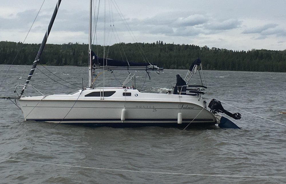

Very nice install and upgrade to power lift.
I did a similar project on my H25 after Meriachees’ 270 mated with my H25 smashing the top end to smithereens. Insurance and a bit of extra cash allowed me to upgraded to power lift. The mounting bracket needed to be moved aft by 2” to make room for the the hydraulic ram. Other than that it was an easy peasy install.
