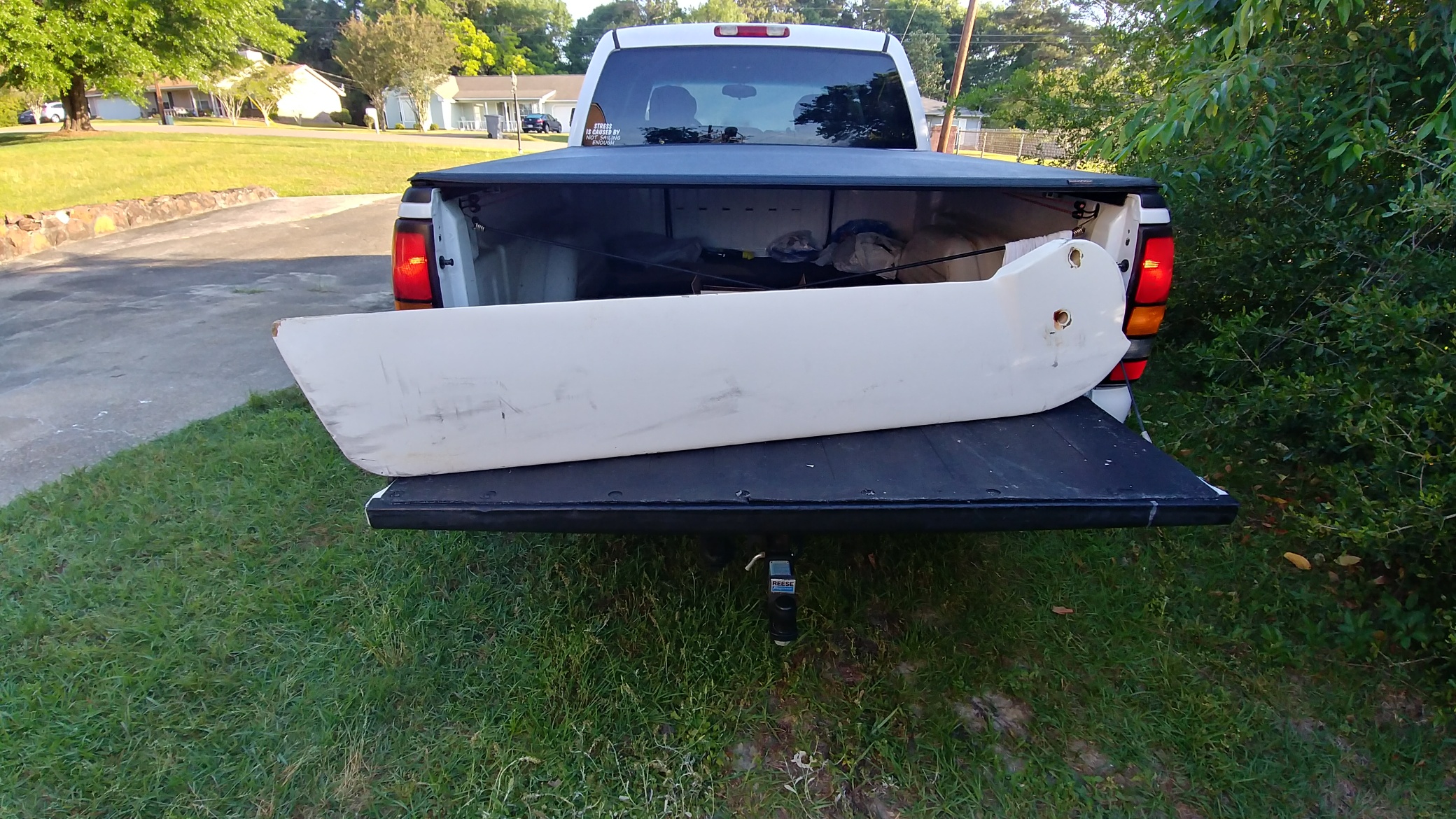

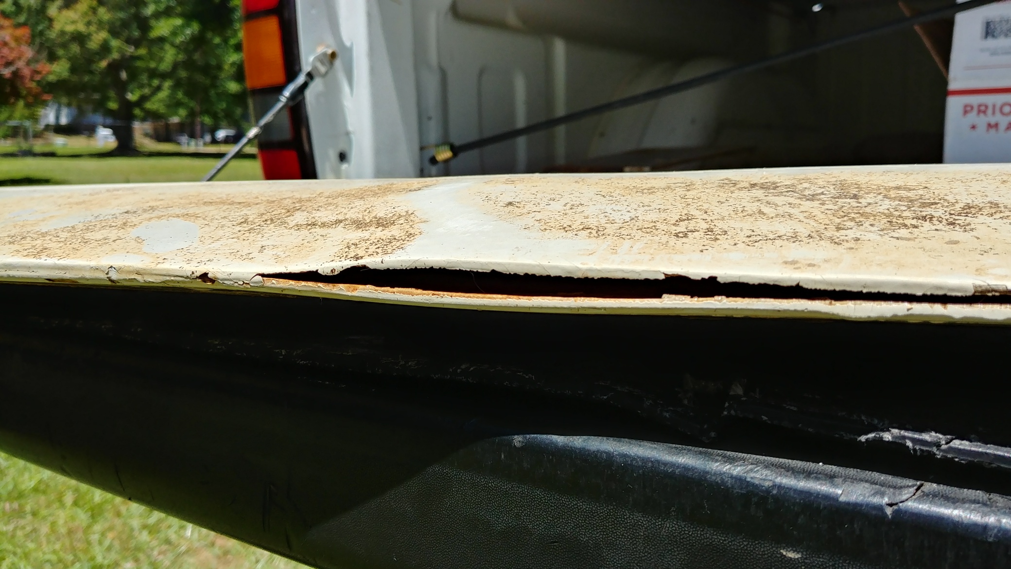

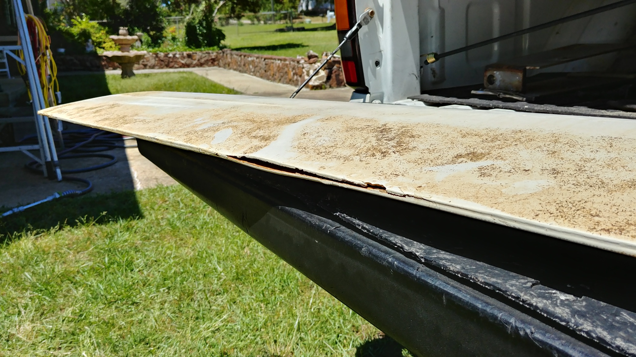

I ordered all new parts from the SBO store. The centerboard pivot pin bushing (delrin) seems to have a lot of clearance. Is this normal? If anyone is interested, I'll mic the pin, bushing, mounting plate holes, and note the clearances. I'll have pictures soon. I finally brought the boat to a local lake and floated it above the trailer at the launch to allow enough clearance to bring the centerboard down and out from under the boat. used snorkeling mask to work underwater. I believe I may have found the reason the centerboard was so difficult to retrieve -- delamination at the steel plate. Funny how delamination sounds so much like damnation. Anyway, the corroding steel swelled and created a split along the trailing edge. Dave, any suggestions or preferences on filler material? I'll follow up soon with pictures. and I'll be giving Dave a call soon.
Jan 13, 2017
34
Hunter 23.5 Panama City, Florida
Here's some photos of the centerboard and damage. I'm sure it's reparable but what kind of fill will I need. I've been told to use everything from regular car bondo to structural filler from West Marine. I'm kind of partial to the structural filler myself. I've yet to grind away the damage but will get to that soon.
