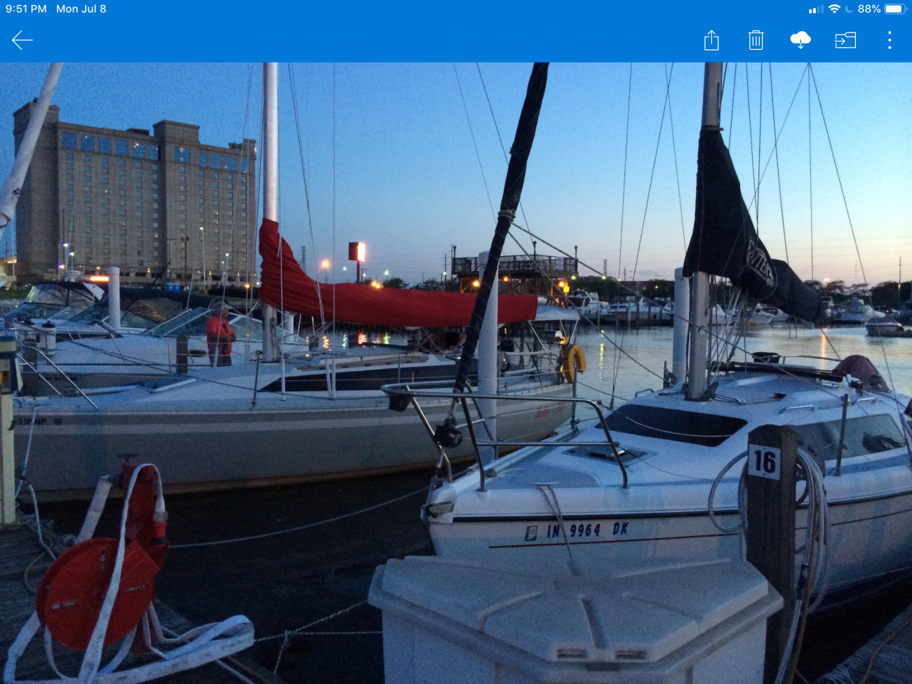

I had a Hunter 280 as my first boat on Lake Michigan. She was a 1996 model year iirc. She sailed very well, and I liked the 5-foot keel, B&R rig with no backstay, etc. she also had a nice, large cockpit.
But the cabin was small, lacked refrigeration, and at 28 feet left me wanting more.
I later bought an O’Day 322, and I have been very happy with her. She is older than the Hunter, but she has character. She sails very well, and I have had her out in 30 knot winds, large seas, And have always felt comfortable.
The cabin is great for a 30-foot boat, with 2 cabins, fully equipped galley, 60 gallon fresh water (in 2 tanks), and a reasonably sized head.
The cockpit seats are a little short...that is my only complaint.
Not sure if either of these boats can be had for $15-20K, but maybe. Yachtworld is your friend here.
Which distillery? I get over to Michigan wine country now and then.
Good luck with the search..
Greg
My “fleet”...the Hunter I the foreground and my O’Day in the background. I sold the Hunter shortly after the photo!
