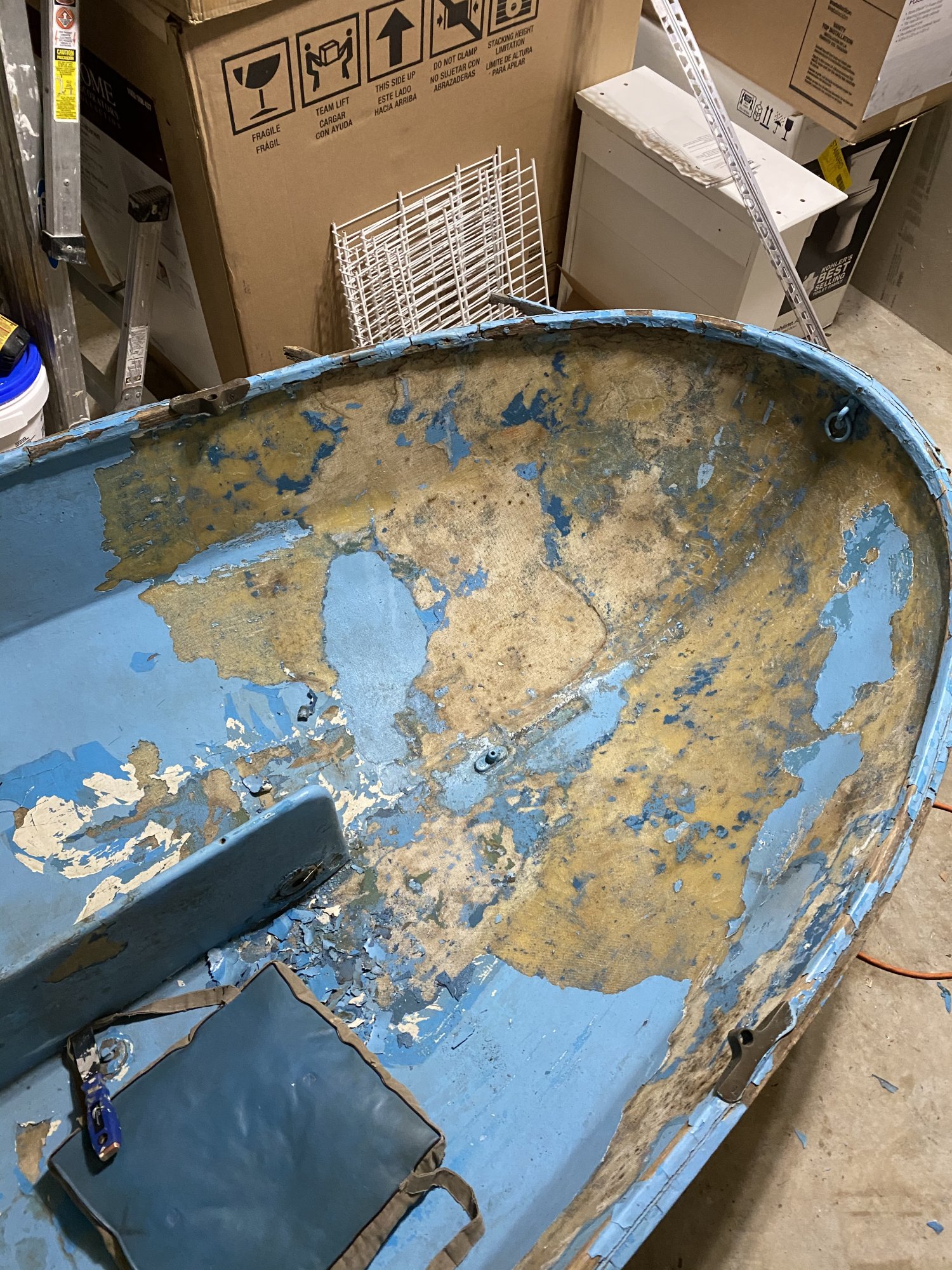

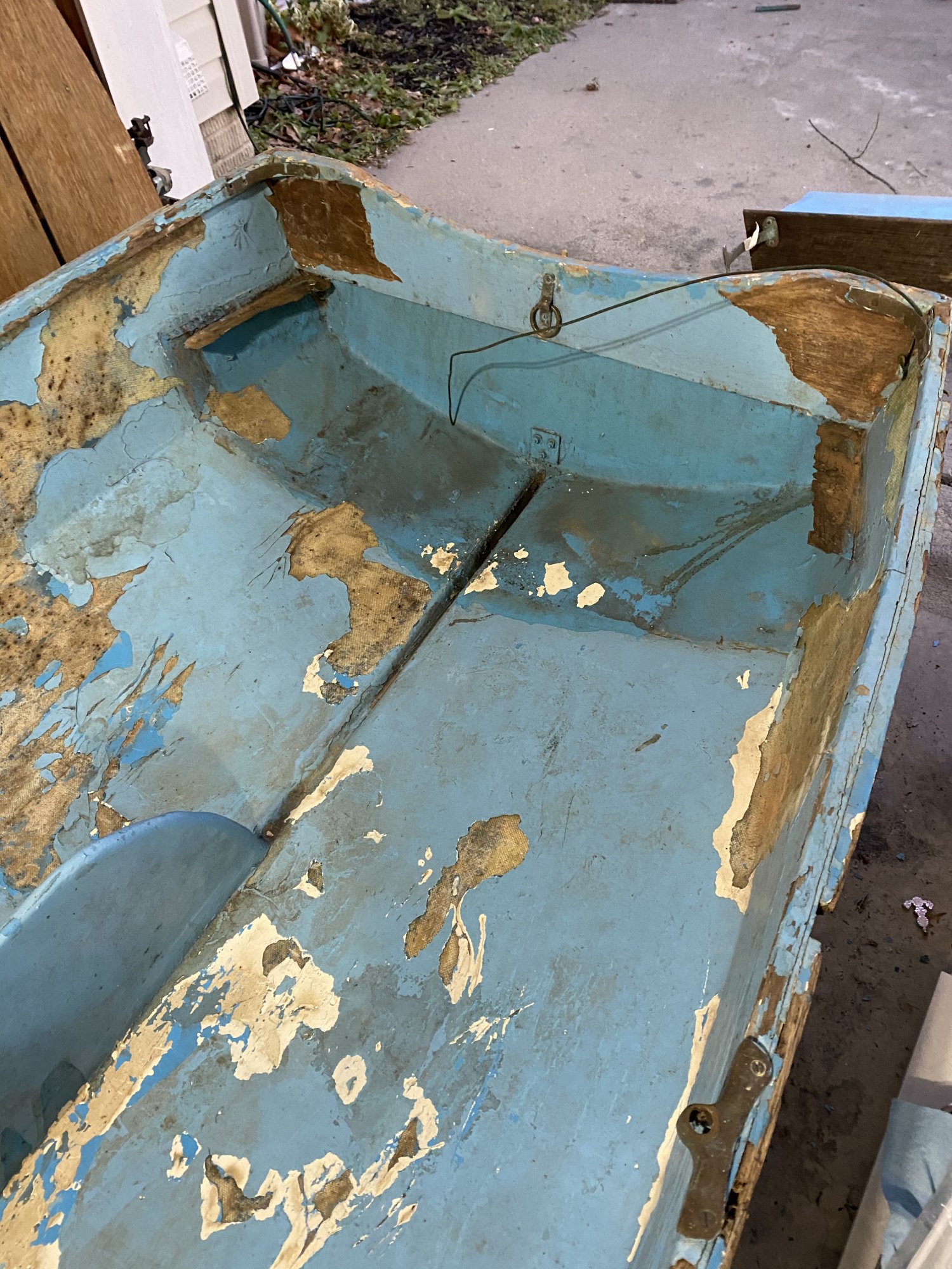

I drove it back to my house this weekend and It's going to be a good winter project to get it back in better condition. Structurally it's not in bad shape but cosmetically it's pretty rough. The interior paint is peeling off, leaving big sections of fiberglass exposed. The gunwales are rotten away, which sounds like a pretty common problem for Dyers, and the centerboard is swollen and stuck in the trunk. On the good side the glass itself is in fine condition - no cracks or anything that looks concerning there. The seats are weathered but serviceable, and the mast, boom, oars, and sails are all in great shape. I'm looking forward to getting it back together, and as I do I'll post some pictures and notes with my progress.

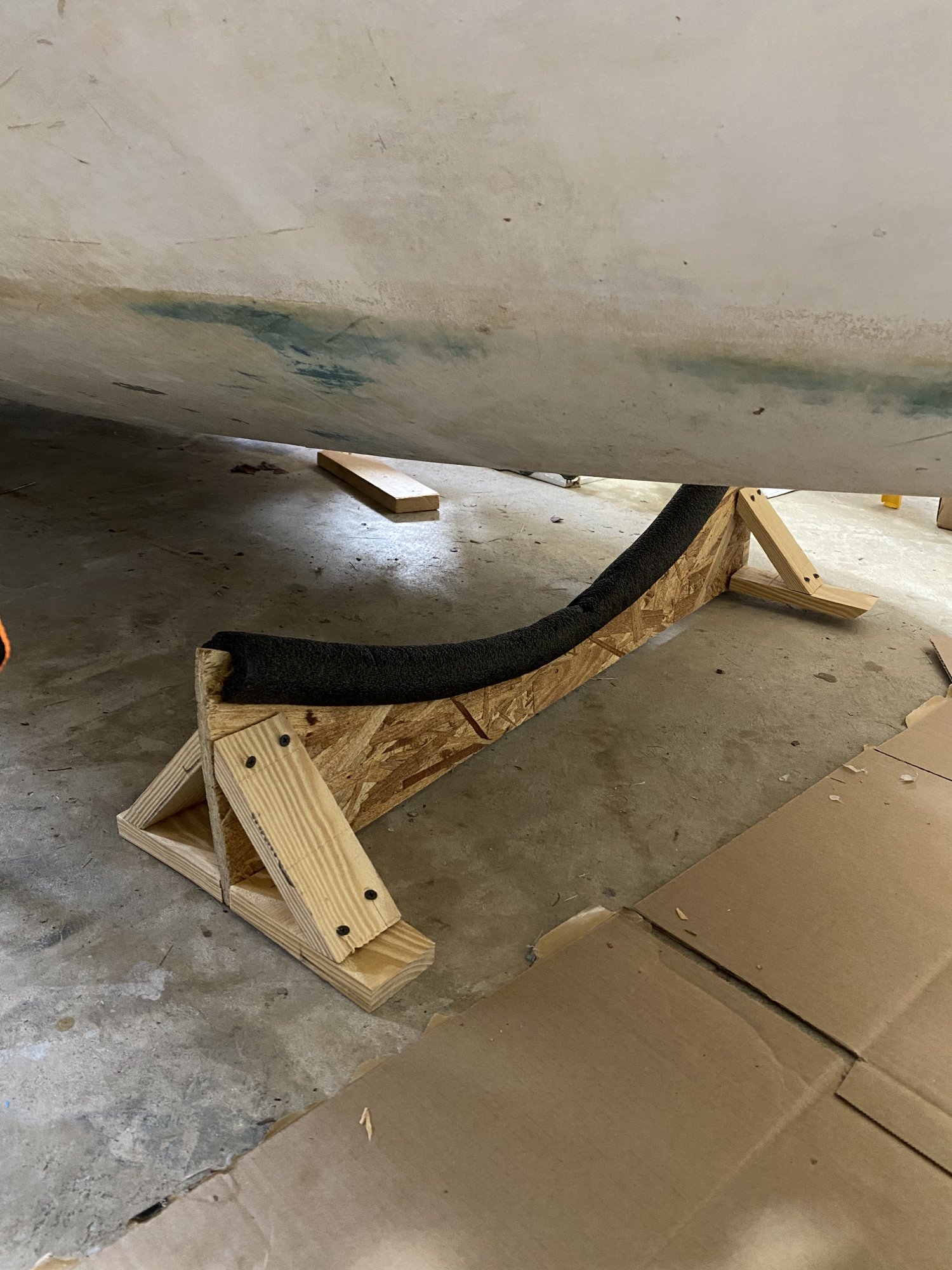

Work is underway. Step one was to build a bit of a cradle. Dyers are very flexible. To keep the boats light they used the minimum amount of fiberglass and resin that they could get away with. Especially with the gunwales rotted the whole boat twists from bow to stern. Before I started leaning on it to scrape paint I wanted to be able to keep it a little more stable. I made a cardboard template, cut some OSB, and used some scraps of lumber to frame a brace for the bow.

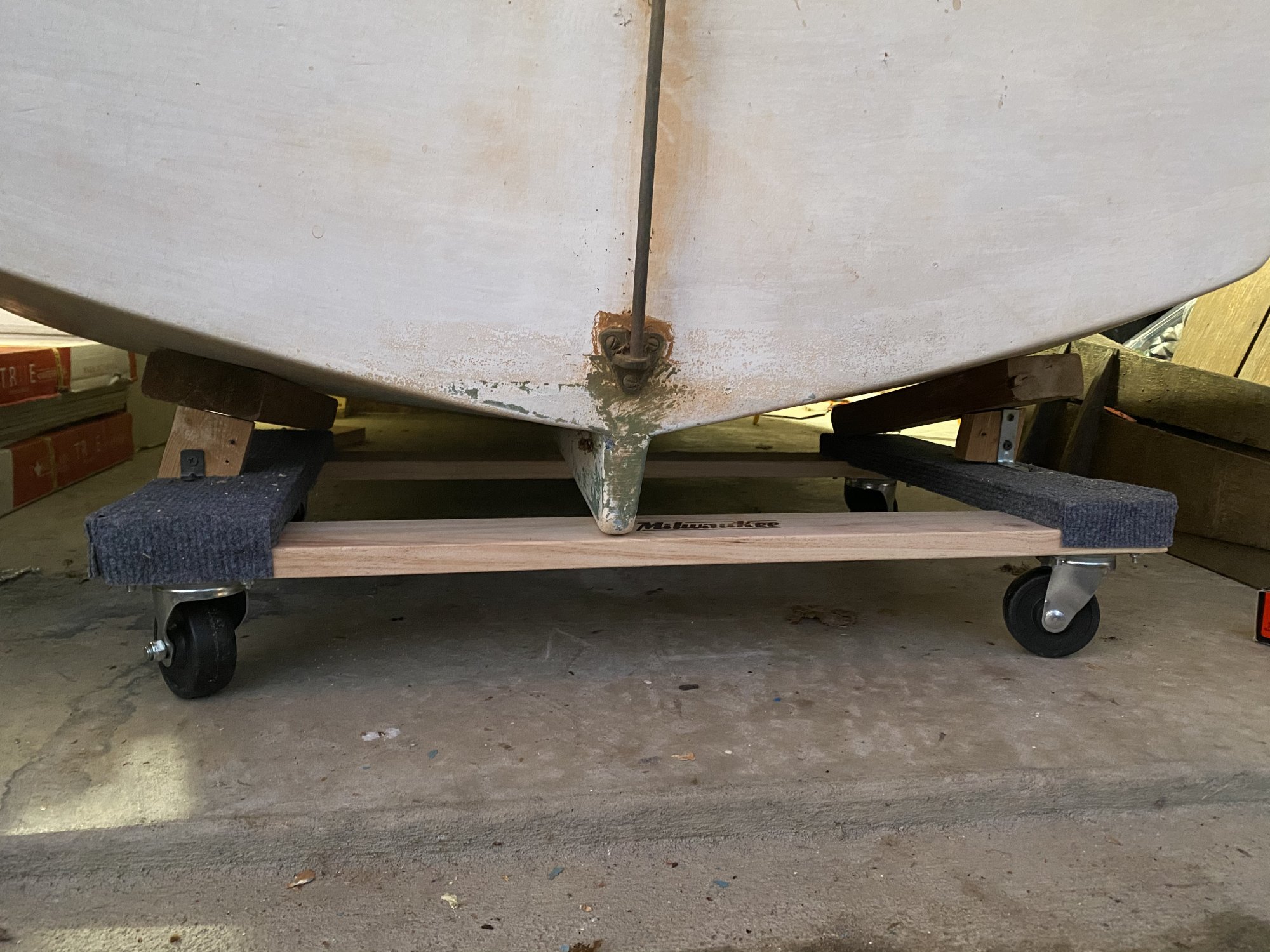

For the stern I got a dolly so I can easily roll it in and out of my garage, and braced a couple improvised bunks to keep the back from rocking on the skeg -

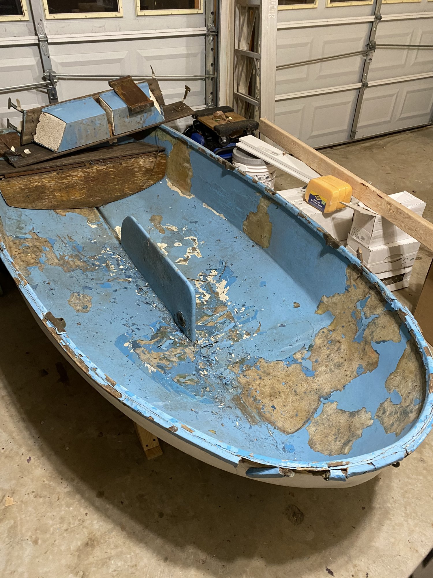

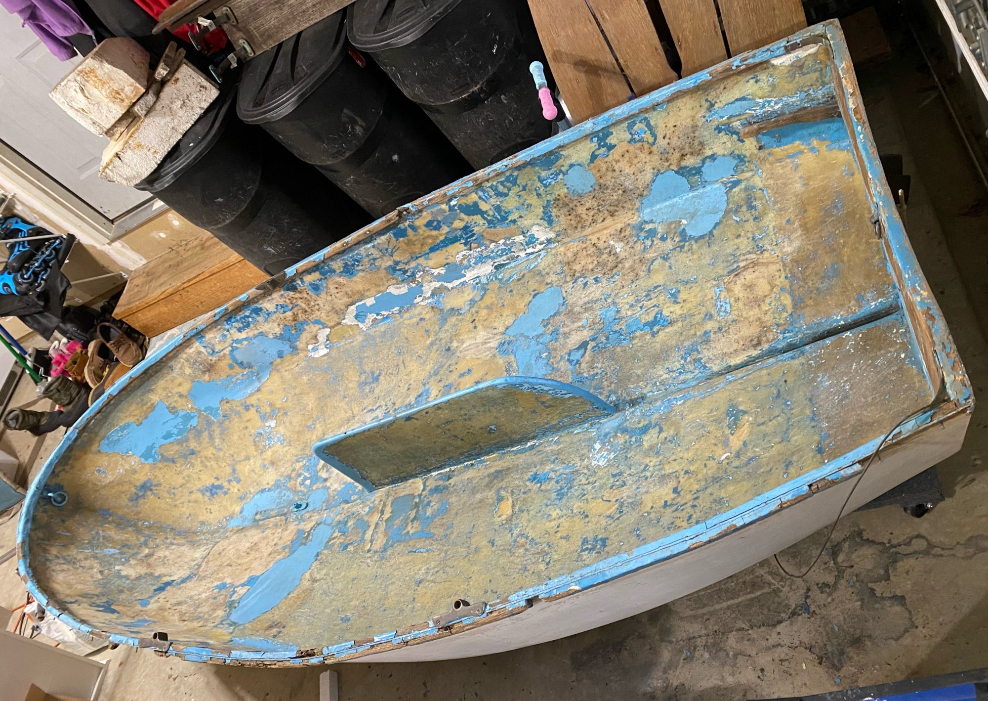

With the hull relatively secure I was able to remove the front and middle seats and start doing a little paint scraping. There’s plenty more of that to do though.
May 17, 2004
6,216
I am going to need to figure out how to get some of the old paint off. The layup is so resin starved that the fiberglass cloth texture is exposed on the inside of the hull. In some places the paint chips off easily, but in others the paint is still adhered into the texture. I don’t want to start sanding down the glass itself, but I don’t especially want to paint over the existing paint either. Suggestions are welcome on that part.

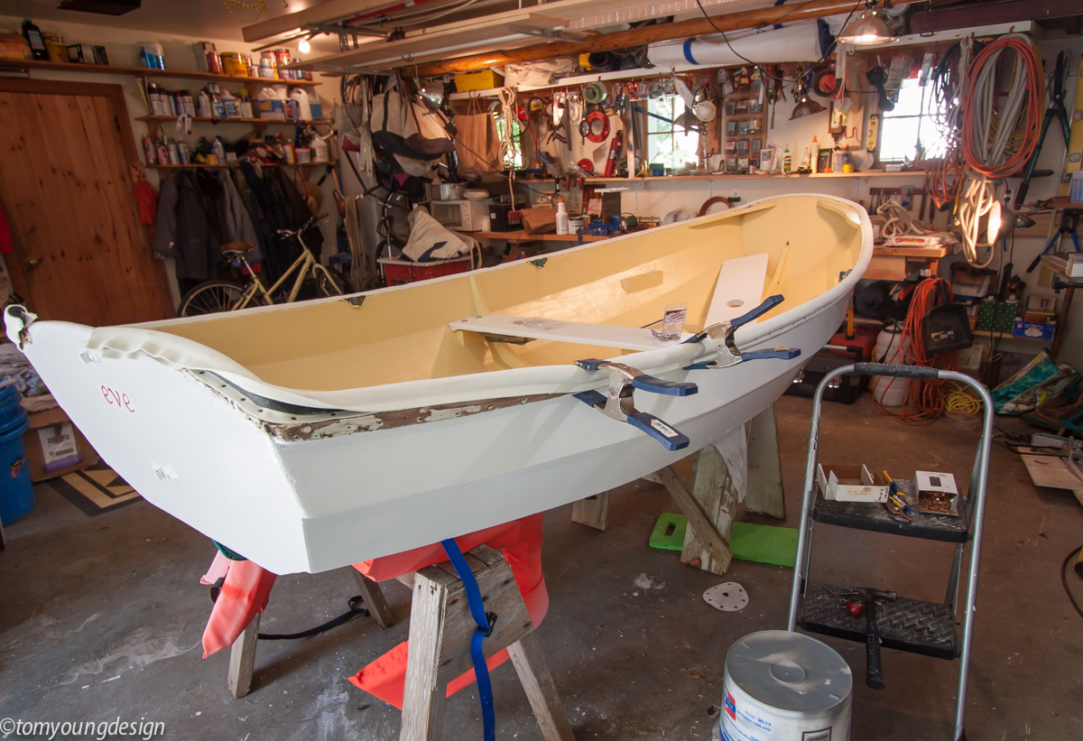

I'd be tempted to improve the design by making the rub rail thicker and perhaps wider.
Then I'd surely finish it with the padded 3/4 round fender material you tack or screw on. That alone would protect the rail from most impact(such as the stern of the boat towing it). Plus the dinghy is easy on topsides.
This dinghy I built has two laminated parts inside, one in the bow and a full width beam in the middle. I ripped 1" Douglas Fir into 1/8" strips and glued (epoxy) them on a plywood form. Still rock solid after 25 years.
I'd try a heat gun first, carefully, with a few scrapers. Then I'd try some paint remover. Then sand paper, hopefully not much of that.

Good call on the heat gun. I worked on the bow section with that and a putty knife for a while today. It lifted at least 80% of the paint, with a lot less work than scraping or sanding. A couple of the remaining sections seem to be held down with some other kind of primer that sticks much better. I’ll probably come back and hit those spots a second time. A couple spots I couldn’t get are where the paint is very thin and really in the texture of the cloth. Those areas might need some stripper. I was careful with the heat and I was able to comfortably touch the glass and paint as I was working it.
I was also able to remove the aft seat. It was screwed down to fiberglass flanges tabbed into the inside of the hull on the sides, and screwed up into the board that reinforces the top of the transom. The side screws took some boat yoga to reach. The heads of back screws were too worn so I had to dremel through them. Good news is that there were no squirrel nests in the styrofoam PaulK :).

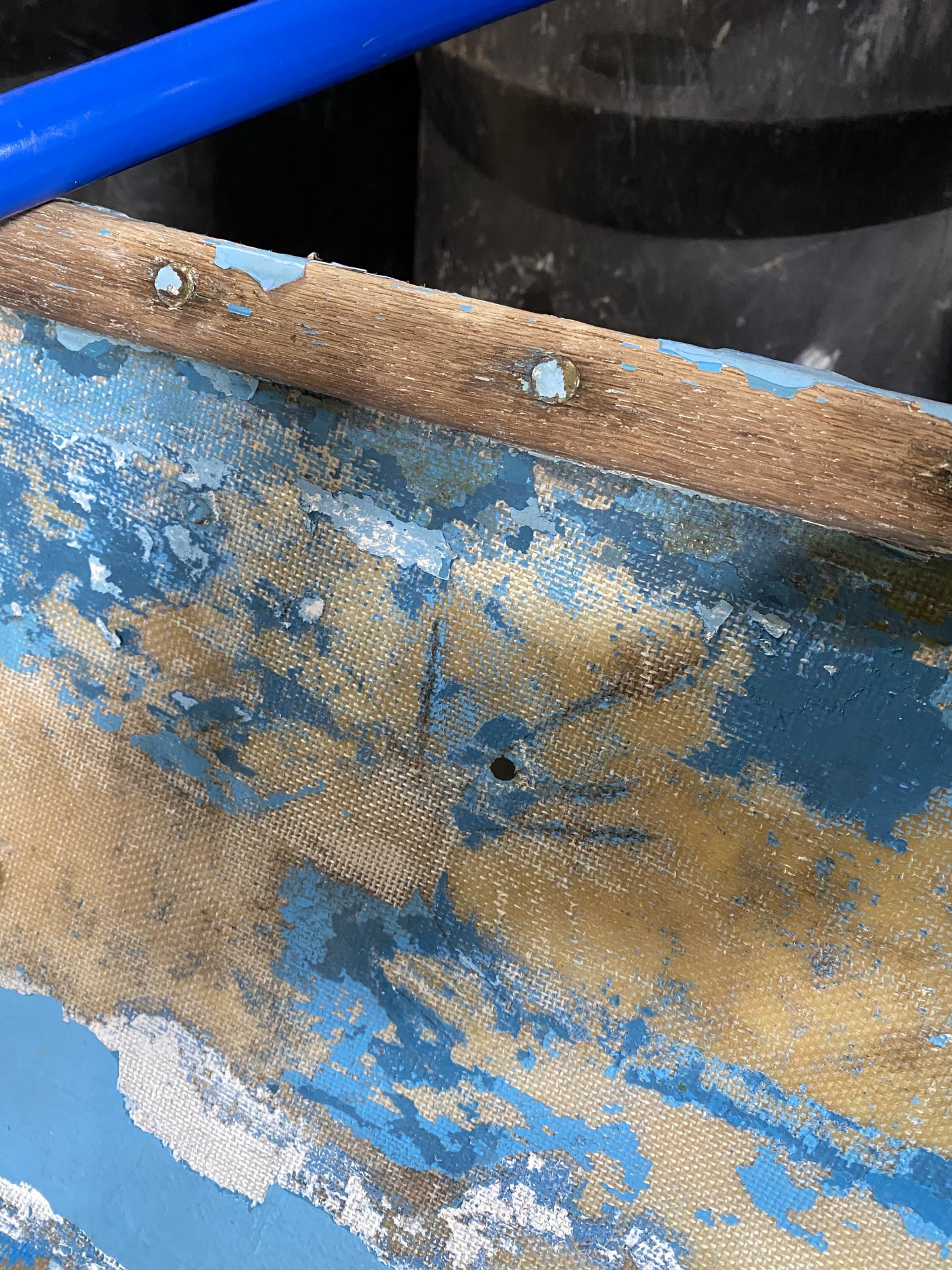

I did find this in the side of the hull -
Not sure what happened there, but there are about 10 other holes the same size along that side that have been plugged. This plug came out because it was apparently better stuck to the paint than the hull. I’ll probably taper around each of them and patch with some cloth and epoxy.

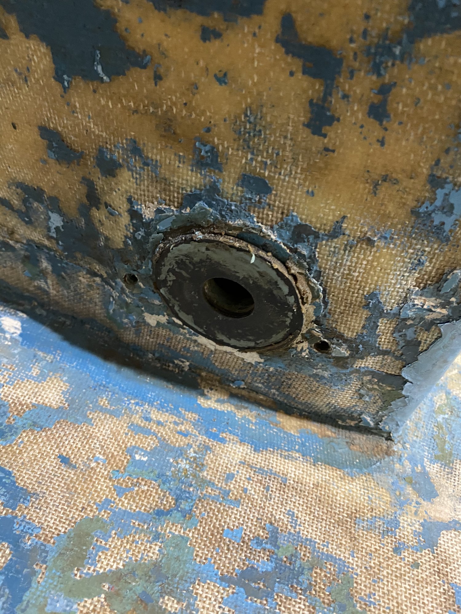

I do also need to take a closer look at the centerboard lever hole. It was caulked with what seems like silicone that’s now degraded. The hole is lined with a plastic bushing that feels like it has a lip on the inside of the trunk, so I can’t just pull it out.
