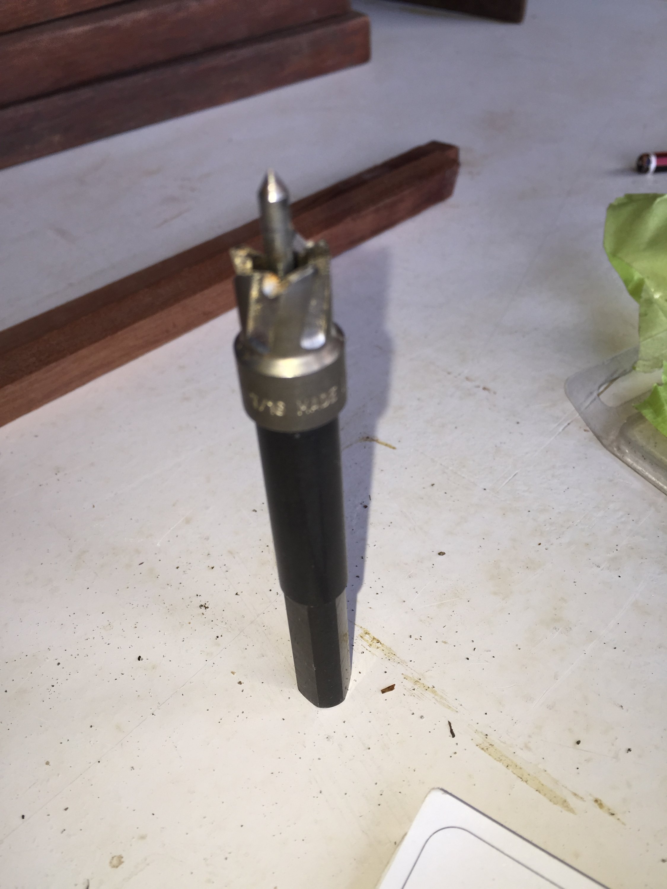

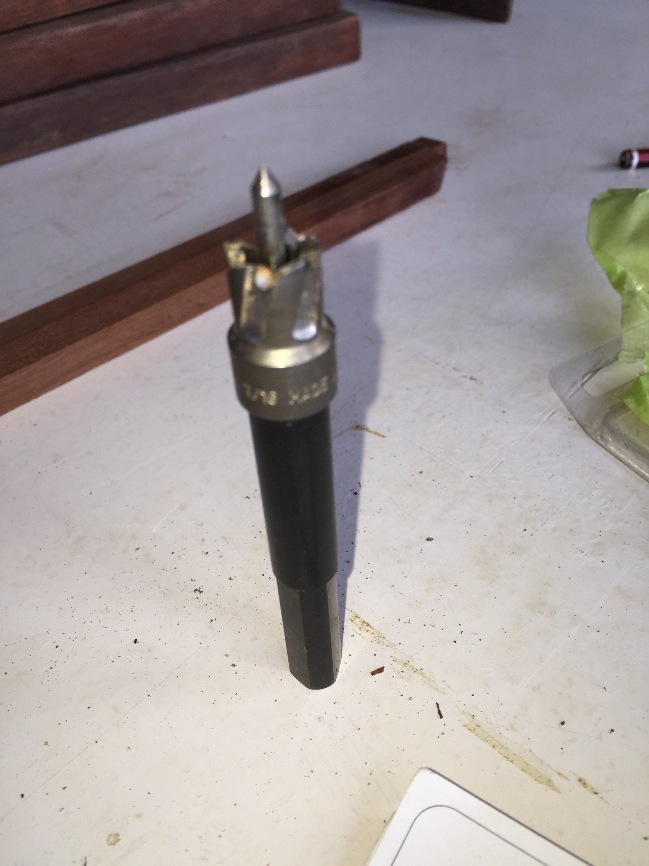

To remove the plugs I recommend the attached tool. You can buy various blade sizes to suit. Plus a larger blade to make plugs.
