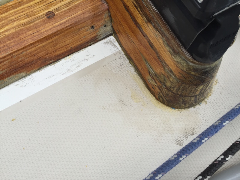

Can't imagine just doing this with elbow grease given the state it is in other than the port hole trim which I would mask around and do in situ by hand sanding; should clean up nicely and trying to pull it off would probably destroy it. All the rest may best be done pulling it off the boat for the cleanest job possible especially at the deck - wood junction.
Tools: good quality power sander, lots of good quality dry sandpaper (100, 220, 320, 400 grit), chamfer bit, drill bit, plug cutter, power screw driver, drill bit, west epoxy system pump dispensers, chisel razor sharp
1. Remove teak plugs ( use drill bit small center hole, then drive a screw thru hole to pull pug out). Clean out plug holes with correct drill size by hand.
2. Prepare or buy new teak plugs after measuring hole size. Can make using a good plug cutter (not expensive) on scrap teak in a drill press or buy
3. Remove teak from boat
4. Use a good quality power sander and prepare to spend a few hard days sanding down to fresh teak. A real pain even with a strong good sander outdoors. Amazing how even rotten looking teak can be revived
5. Use wood bleach (oxalic acid) several times to brighten it. Buy it OTC, not at expensive woodcraft/ depot etc store. I also used boric acid (roach killer powder) to flood it on the off chance there was any wood rot deep in the screw holes. Wash thoroughly each application of any of the above. I also used something at the end to neutralize any remaining acidity prior to final wash. Dry thoroughly. Any damaged/ rotted defects were filled with a two part wood epoxy which works extremely well and bonds like a rock. Sand these repairs smooth. I used a fine artists brush with some acrylic paint for a faux wood grain so is distinguishable from the teak (actually quite easy to do with minimal effort or ability in small repairs)
6. Use West 2 part epoxy system to coat. Sand. Coat. Sand. Coat. Final smooth sand. No UV protection but very hard protection.
7. Use varnish (Epiphanes my choice) for UV protection over the epoxy. Sand. Varnish. Sand. Varnish. Sand.
Install on boat
8. Put new plugs in, cut with razor sharp chisel or Japanese saw and gently sand. Spot finish with varnish and sand. I use white outdoor wood glue for plug if fit is not quite tight. Do not epoxy in place or you will never be able to remove it again
9. Do touch ups as needed with a small bottle of varnish during the season
10. When I reinstall pieces I chamfer the deck holes lightly with a chamfer bit and then use 3M 4000 UV for a complete teak to deck bond; others use Sika; never use 3M 5000 if you ever intend to remove again without destroying the fiberglass. Do not used silicone
11. Sit back, admire, and realize you've just spent 3-6 months of your life on something for the birds to crap on, passengers to scuff up. take for granted and barf on.
12. Buy covers for whatever can be protected from the sun, especially the handrails (at Hunter Owners store)
Or just sand it a bit, mask the deck and varnish it a few times
