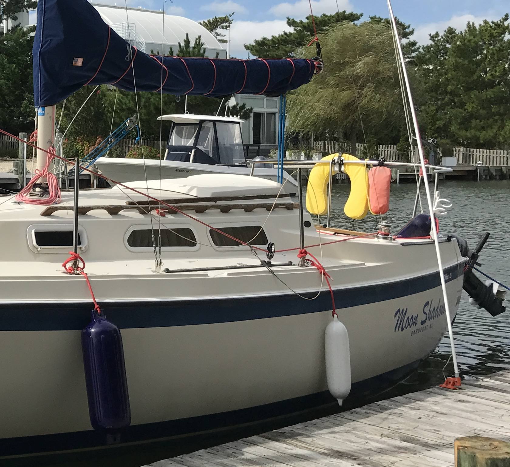

The block up by the shrouds is set for working jib. The track back aft isnt useful except for when sailing a spinaker. Ive had ny 26 for 20 years and am tired of having such bad sail trim and am going to put down proper genoa tracks and would just love to see how anybody else has placed them. Many have discussed doing this here in this forum, but no pictures have been posted. Onr person wrote they laid track from where that jib block is located to around 4 inches from cockpit coming. Someone must have done this who has a pic. Sure hope so! :)

Back in 2016n I replaced the OEM standup block with a jib track for more trim control on my 1980 O'day 25.
I positioned the track as far aft as possible while keeping the proper lead into the winch. I might have been to extend the track further aft if I had been willing to add more blocks to lead the sheet around and up to the Genoa track and then to the winch but that would add quite a bit of friction for little benefit.
Attached is a photo of the new track.

@Ward H That is by far the cleanest 25 I've ever seen

That is exactly what I was looking for! :). So you sometimes use aft track (spinnaker track) for Genoa too? I never get a good angle back there, that's why I so need a forward track. Thanks so very much and if you do get more pics, I'd love to see. I'm gonna lay mine down just like yours! Thanks - Tim

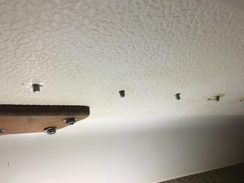

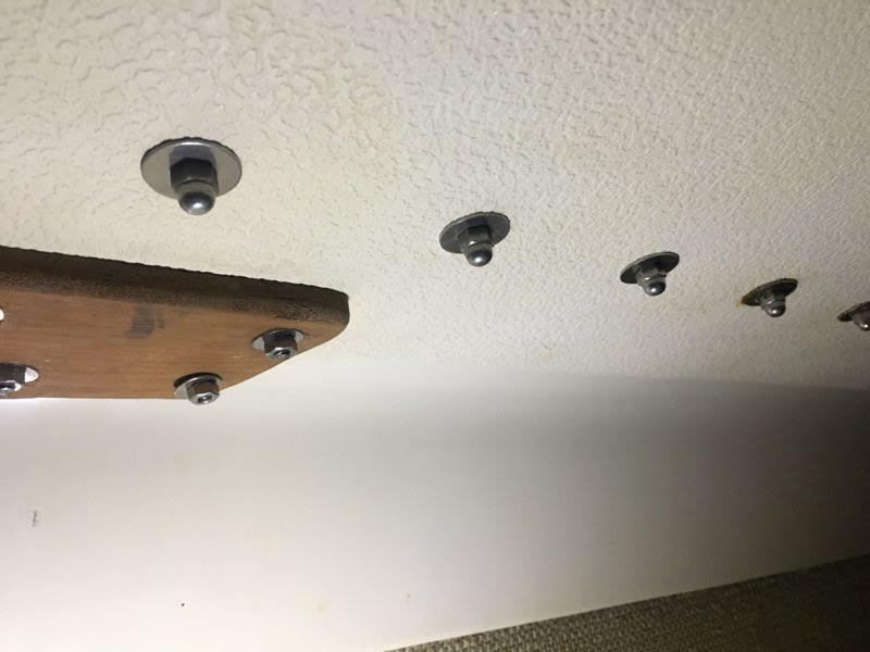

Oh, another question. Did you just drill through interior hull liner, using washers as backing for thru bolts? I see no other way...

My boat came with both the genoa and spinnaker tracks. There should be an access hole on the port side of your boat. You'll need to remove that and the plywood covering the stern on the port side in order to access those bolts. So far that has been the most difficult item to rebed even though I added a second access hole. Starboard side isn't bad.
My genoa track is bolted through the deck and liner. I don't think the genoa was supposed to go to the spinnaker track but I really wanted to get the boat into the water for the first time and I couldn't find the cars. I'll be installing them when I rebed the forward tracks. Please let me know if you need pics of anything specific. I'll probably be at the yard tomorrow morning
Yep, drilled through to liner, plug holes and potted with epoxy, drilled again and used butyl tape to seal. I used oversized, thick washers under the nuts.

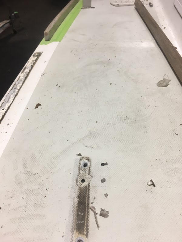

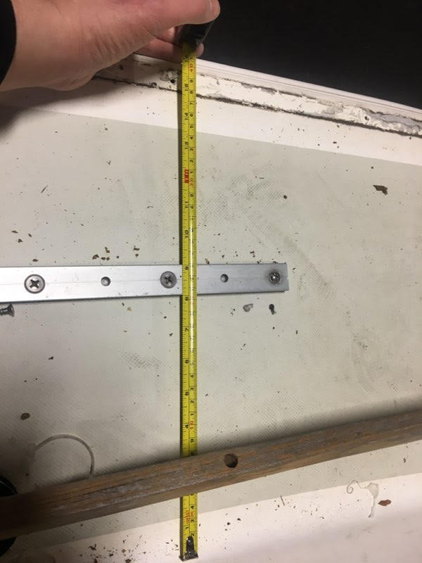

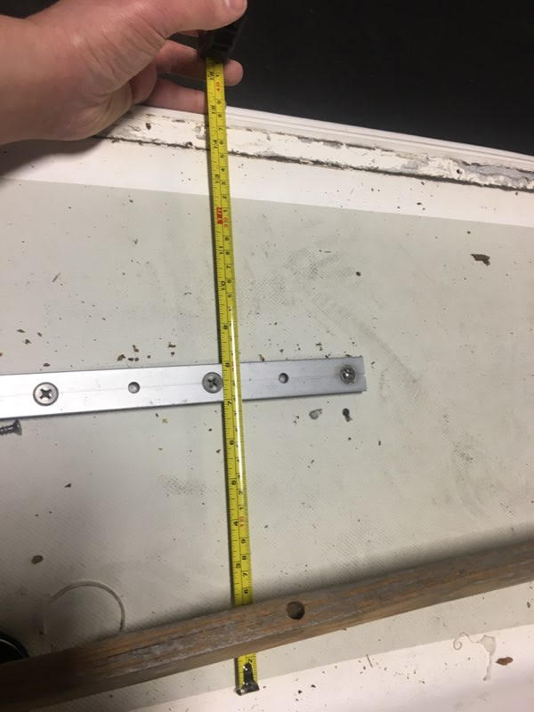

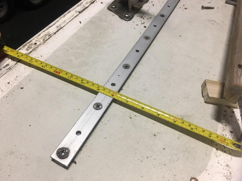

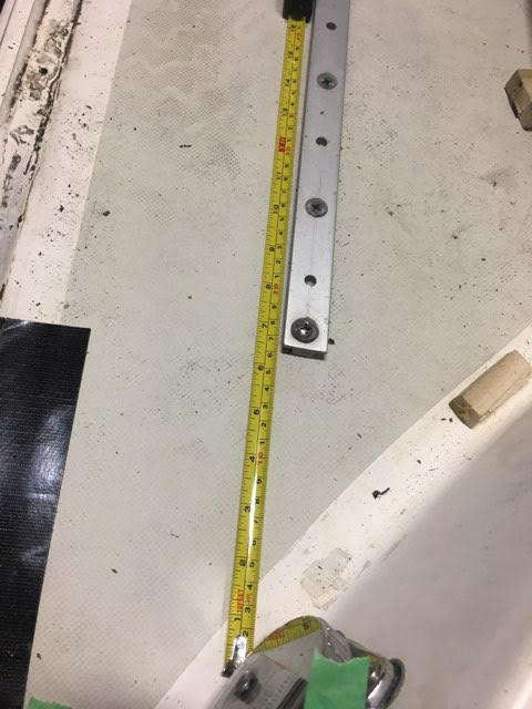

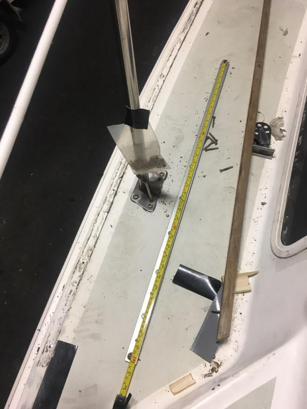

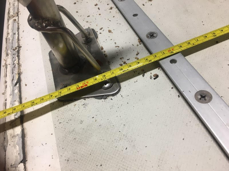

Here are some measurements. If you need anymore feel free to ask. The 1/4-20 screws are either 1.5 or 2". I'm leaning more towards 2 and will try to verify this weekend
Likes: timlho

Wow that is just awesome! Im gonna study those photos hard!
Just to get this together in my mind, you drilled through the deck and interior hull liner using big washers as backing for bolts. Is that correct?
Thanks so very, very much! Its nice knowing that there are such helpful people like you out there!

The tracks were there when I bought the boat three years ago. If you look carefully, you can see where the original block was.
I'm in the middle of a re-bedding project. I've been doubling up fender washers and/or using flange nuts to help spread the load.
I'm pretty sure that area in the deck is cored. I wasn't able to verify that the screws are 2" since I had already reinstalled the track but that seems to be a commonly used size for fastening through the deck on this boat
