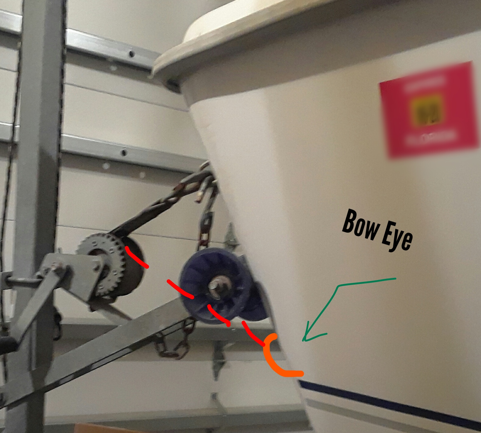

I have the reverse problem with my H18. The bow eye is nominally just above the trailer bow support so with the trailer on a sloped ramp the angle between the floating boat and submerged trailer allows the bow eye to be winched in just a bit farther forward before trailer support contact' As the stern settles down on the way out the strap tightens further and drives the bow in tighter against the support. The steeper the ramp the more pronounced the effect. Its not a big deal and I usually let the winch off a click or two before hitting the road. Looking at some 23.5 on trailer picks it appears the bow eye sits below the support and the trailers I saw didn't appear to have a keel roller or padded support up by the bow? If so that explains the gap opening up as the boats sits down on the bunks on the way out. Installing a forward keel support would probably help most. Minimizing the distance between bow support and eye will also reduce the effect - maybe even consider moving support below the eye. Hope that helps.

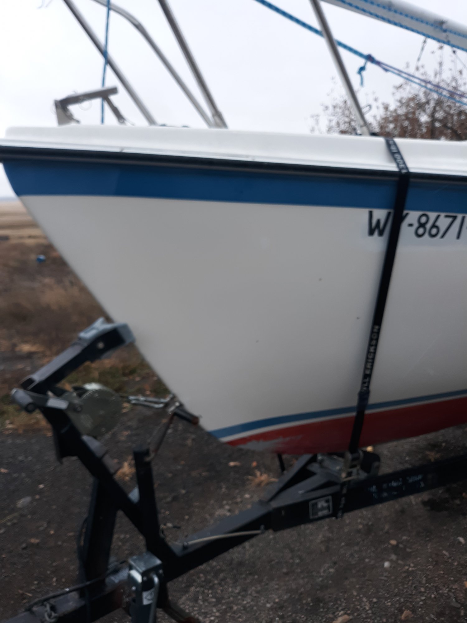

Thanks for the insight. After looking at a bunch of online photos of trailered H23.5’s I have a few observations.
1. The winch strap comes off the bottom of the winch and aligns more horizontally to the bow eye. Mine is opposite and extends off the top in a steep angle towards the eye.

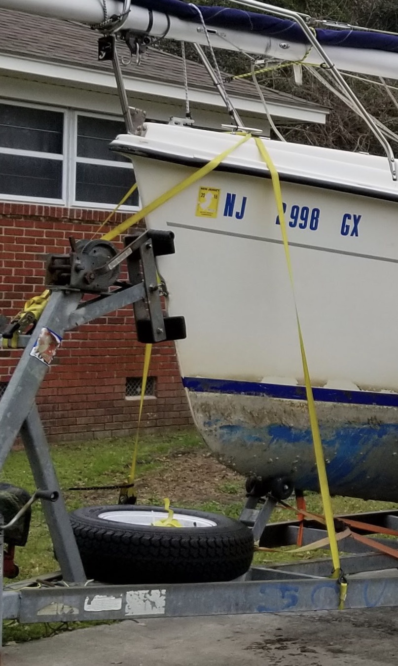

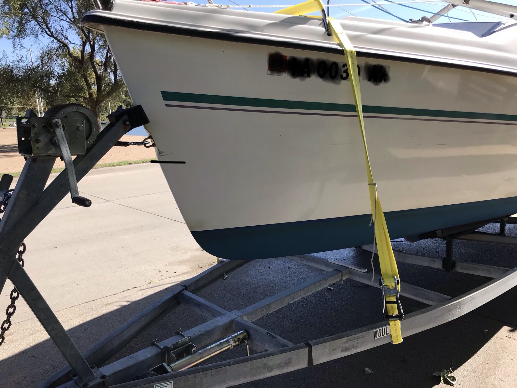

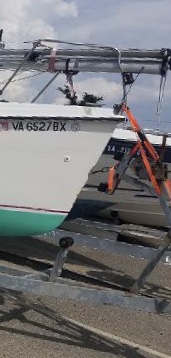

2. A couple of boats had two V bumpers and an added bow guide below. The fact that there are two boats like this makes me wonder if it was an upgraded factory solution and not a one off DIY. Did not appear to solve the gap entirely. See photos.

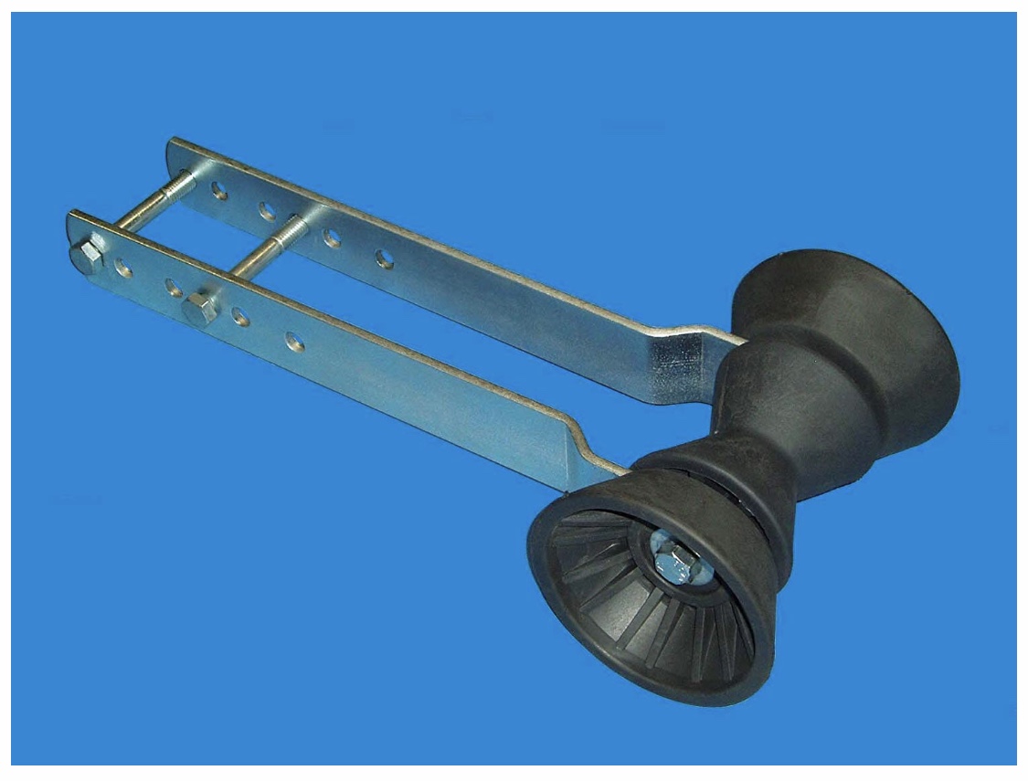

I think I’ll reverse the strap to come off the bottom of the winch and see if this has any effect. If not I might try adding a bow guide. I found one that might just work (last photo).
